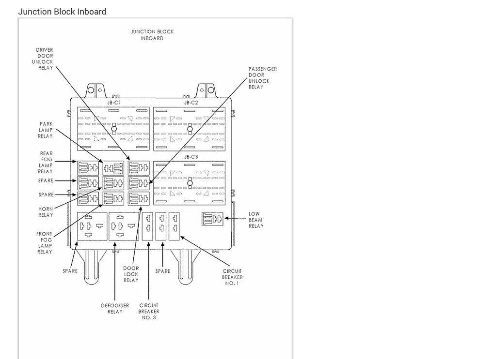

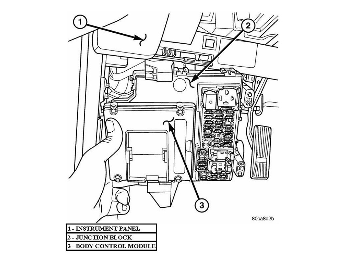

Where is the rear defroster/heated mirror relay exactly located?

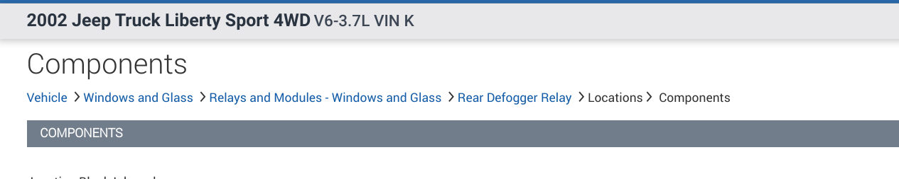

The Rear Window Defroster, or, Defogger Relay is located in the Junction Box underneath the driver's side of the dashboard. In the diagrams down below I have included diagrams of the location and layout with callout of the Junction Box for you. Please go through these diagrams and get back to us with what you find out. I hope that this helps.
