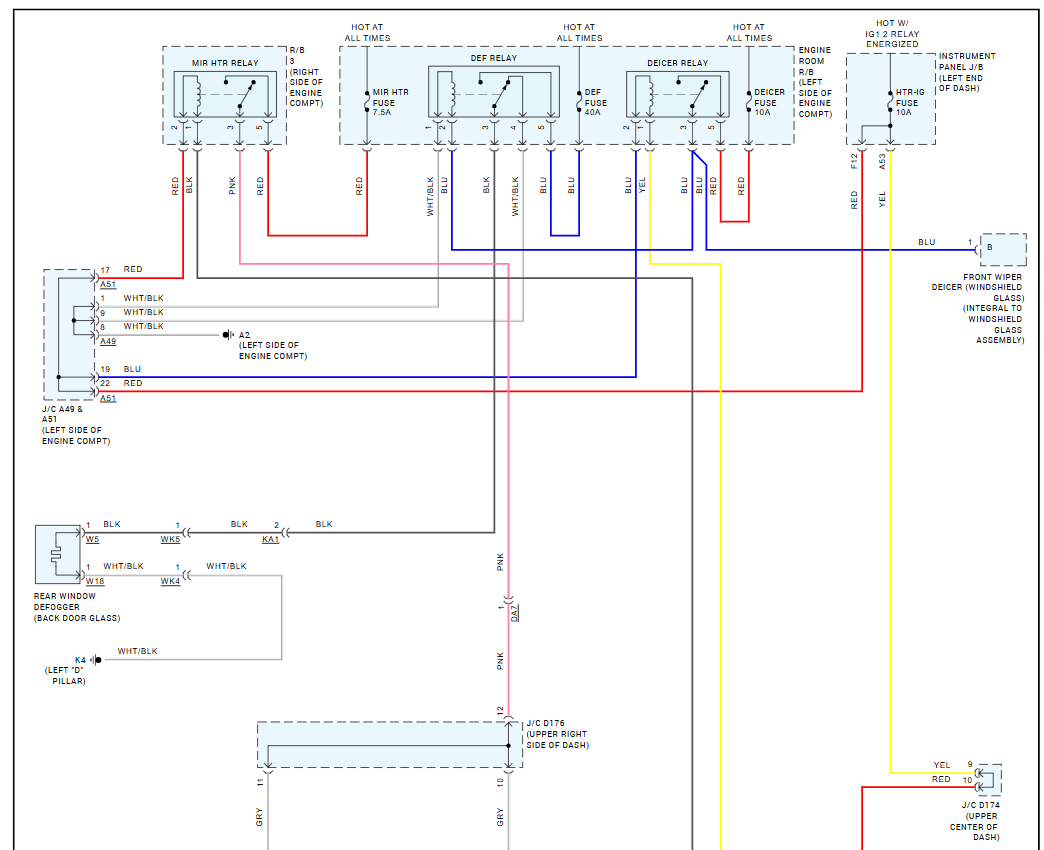

Doesn't work, not sure but the side view heated mirrors may not be working as well bc there was snow on them that didn't seem to go away after 15 minutes of driving.
When the rear defogger button is pressed, it lights up, but I never see any defrost action at the rear window. The defrost grid seems to be intact. Tried looking for a fuse /relay diagram in my owners manual, but could not find anything. Checked the web but got some conflicting info as to which fuse and or relay controls the system. I am pretty good electronically, so if anyone can share insight or a schematic, it would be most helpful. Thanks!

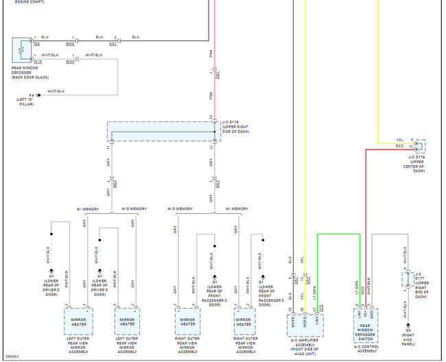

So there are four fuses you need to check: MIR HTR, DEF, DEICER, in the fuse panel under the hood and the HTR IGN fuse in the fuse panel under the dash on the left side. There are also three relays that run the system as well, I don't think it is the defroster ribbon inside the rear window because the other features are not working as well. Here is a guide to help you check the fuses.
Here is the rear window and rear view mirror wiring diagrams so you can see how the system works. Check out the images (below). Please let us know what happens.

Again, thanks for your help on this! The short version of the solution was I found an open coil on the deicer relay.
Apparently Toyota uses a crappy crimp method to attach the wires to the terminals. The connection failed at one of the crimps, so I removed the relay cover, carefully tinned the wires and applied a little solder and problem resolved. All works fine now!
The schematics were invaluable and probably would never have found the issue without them. I will definitely be sending a contribution to the site.
