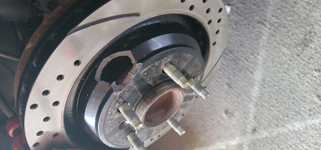

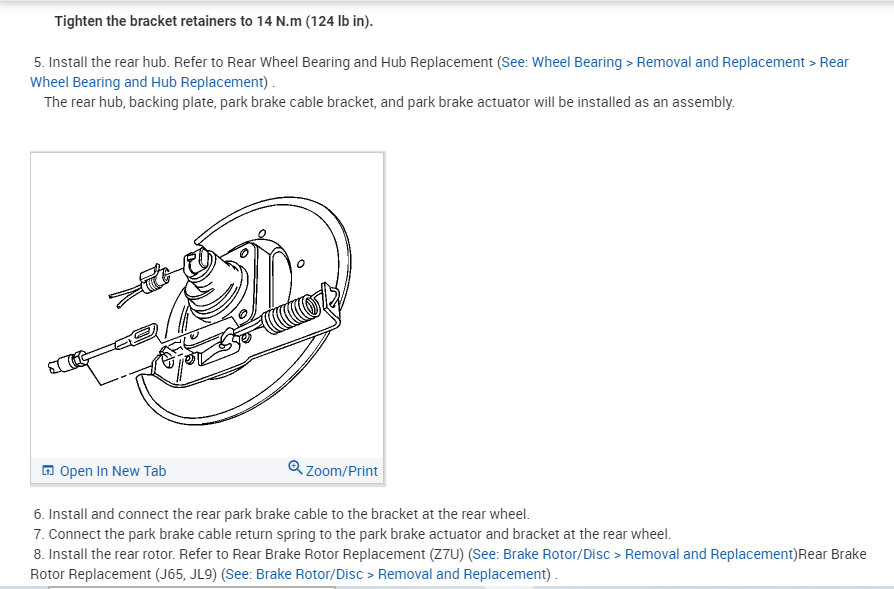

I was driving earlier in the day and my back wheels locked up. I do not know what's the problem. I was hearing weird noises from my driver side rear sounds like scratching sounds, when I was driving it, my car finally drove even though I still heard the noise, I check brake cable once I made it home nothing seems broken, but I did notice a major hole in my left rear rotor something came through it. Please help.
Mar 30, 2023 at 6:38 PM
  • 110,194 POSTS

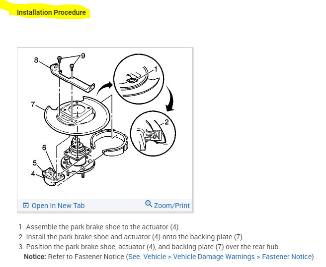

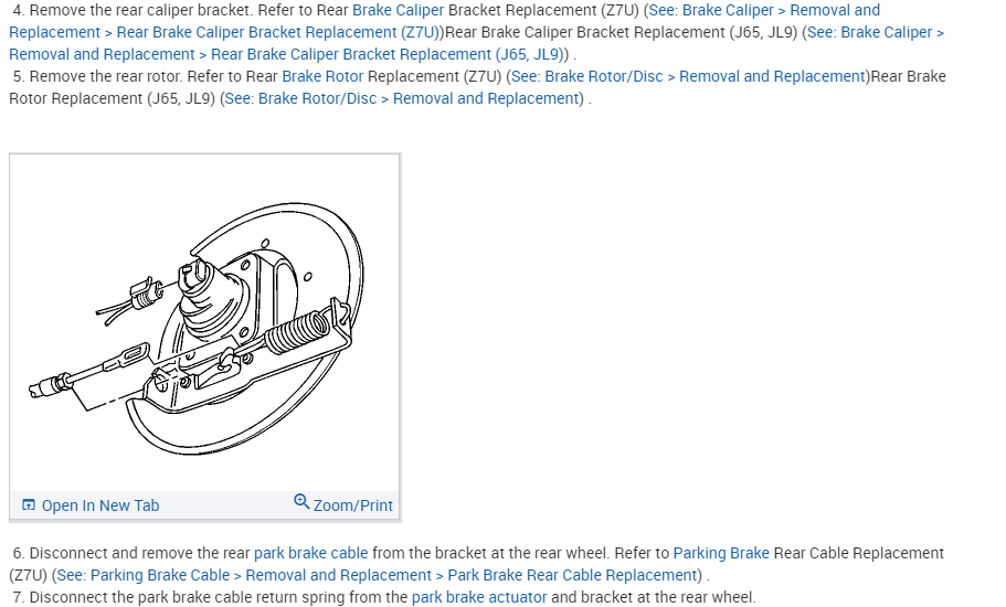

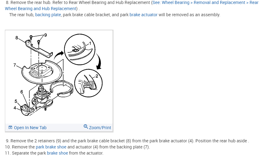

The parking brake shoe assembly is behind the brake rotor (the area that is broken). Something must have come apart and damaged the rotor.

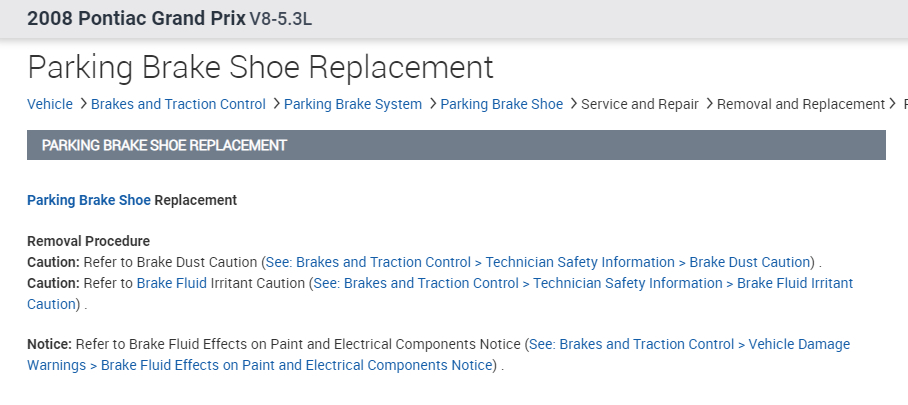

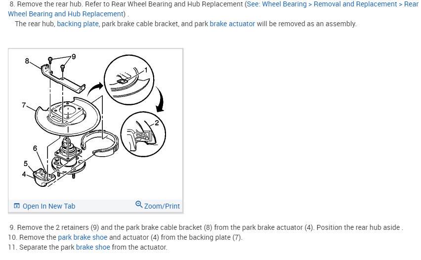

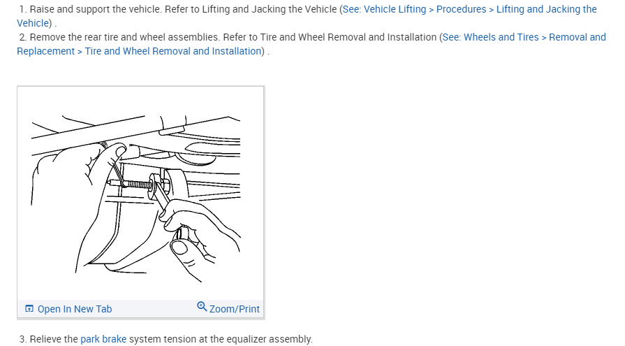

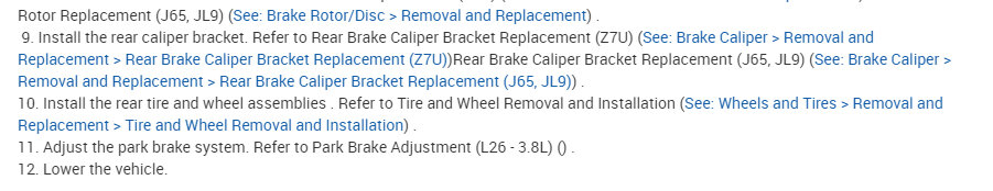

I attached the directions for replacing the parking brake shoes below. Use these directions to access and inspect the parking brake assembly. If I had to guess, I suspect one of the shoe retainers came apart and allowed one of the shoes to break through the rotor.
Let me know what you find or if I can help in any way.
joe
See pics below. Note: The rotor needs replacing.
