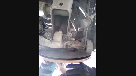

Okay, so, the passenger wheel and caliper is off. Here is the sound. The drag isn't nearly as bad but some wiggle in steering.

I hear it. That doesn't sound like a bearing or differential issue. It sounds like something is rubbing. Is that sound coming from near the brake rotor? Also, check between the rotor and the backing plate to make sure nothing is touching or wedged between the two.

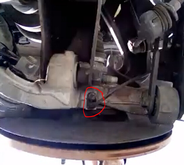

Also, it should have wheel speed sensors on each side. By any chance is the ABS light on? I'm questioning if one of them has come apart or if the toner ring in the bearing assembly is somehow touching the sensor.
Also, let me know if it sounds the same when you turn it in both directions.

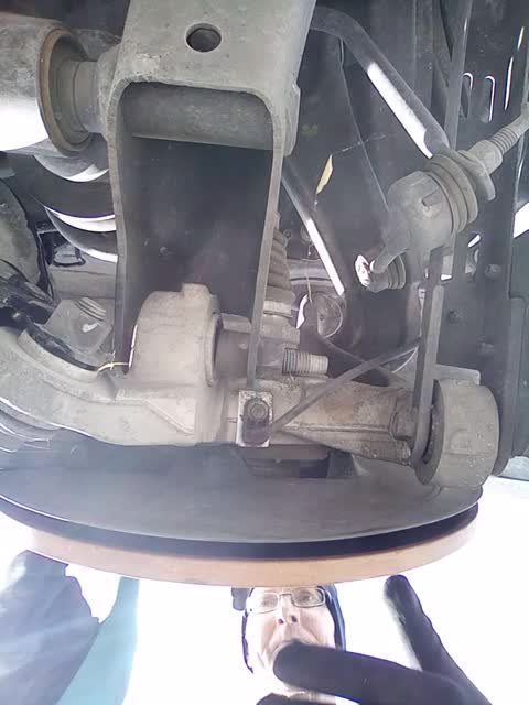

This is the rear wheels of Ford five hundred. Just making sure since I have 2 different cars. There are no speed sensors that I know of, maybe show schematic to show where should be. The sound sounds like it's coming from behind the rotor. As you could see there was no caliper on the rotor. It turns hard. No ABS lights or any warning lights at all. It happens on both sides. Still has a slight drag feeling when accelerating. Slight shake to wheel but needs to be balanced and aligned.

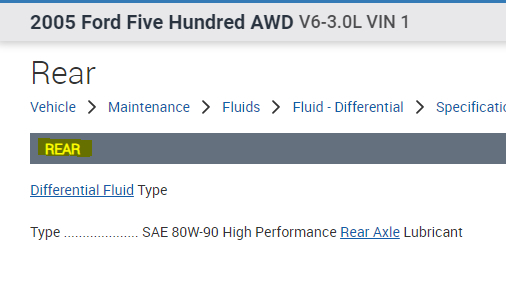

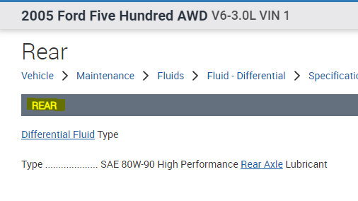

I attached a pic below showing the left side. (see pic below) The right side is similar. If both sides are the same, then I would recommend checking the differential fluid. Make sure it is full, clean, and free of contamination of any metal fragments.
Is it the same sound on both sides with a heavy drag when turning the rotor?
See pic below.

Yes it is on both sides and the same. Differential fluid okay, I'll YouTube the o see how to check and will check the sensor.

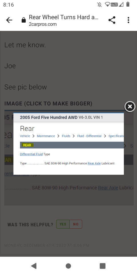

There is no pic showing left side just shows what fluid to use and can't click the link if I was supposed to it just makes pic bigger.

DAVENOOB
  • 371 POSTS
This is all I see.

As far as the sensor, I copied a pic from your video and circled it.
Let me know if that helps.
See pic below.
