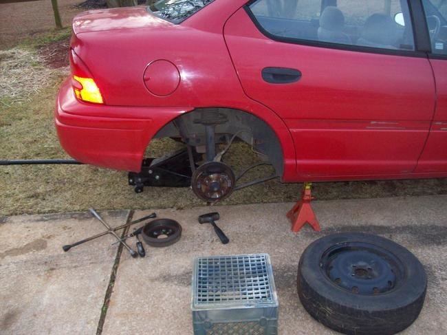

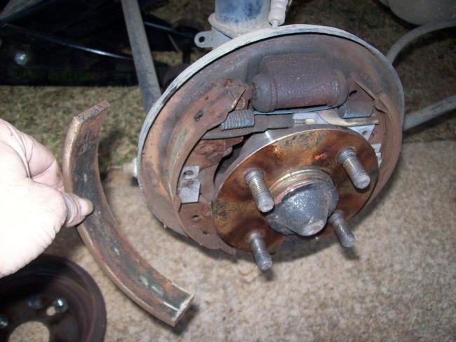

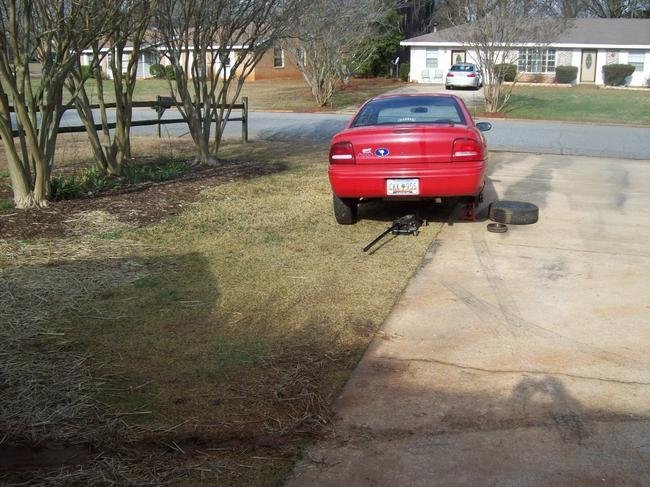

Just to show you an easy fix I experienced with a Dodge Neon, the passenger rear wheel was locked up. Beings that it is front wheel drive, I drove (and dragged the rear wheel) out of the grass and onto the driveway. (see the drag marks in my pictures)
I removed the rear drum (it has drum brakes on the rear) and discovered the "glued on" brake lining had come loose, slid around and was now binding up.
No damage was done and replacing the shoes (on both sides) was an easy fix.
