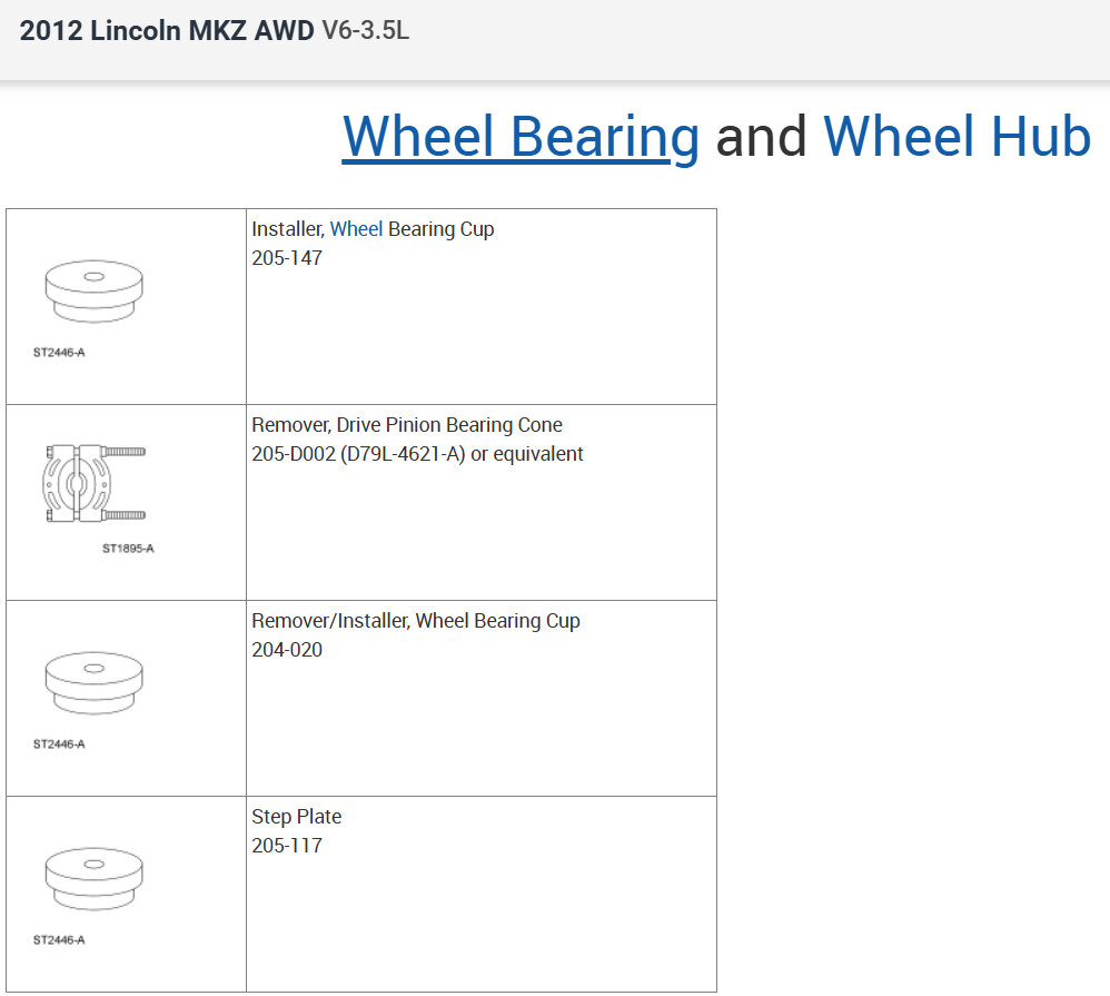

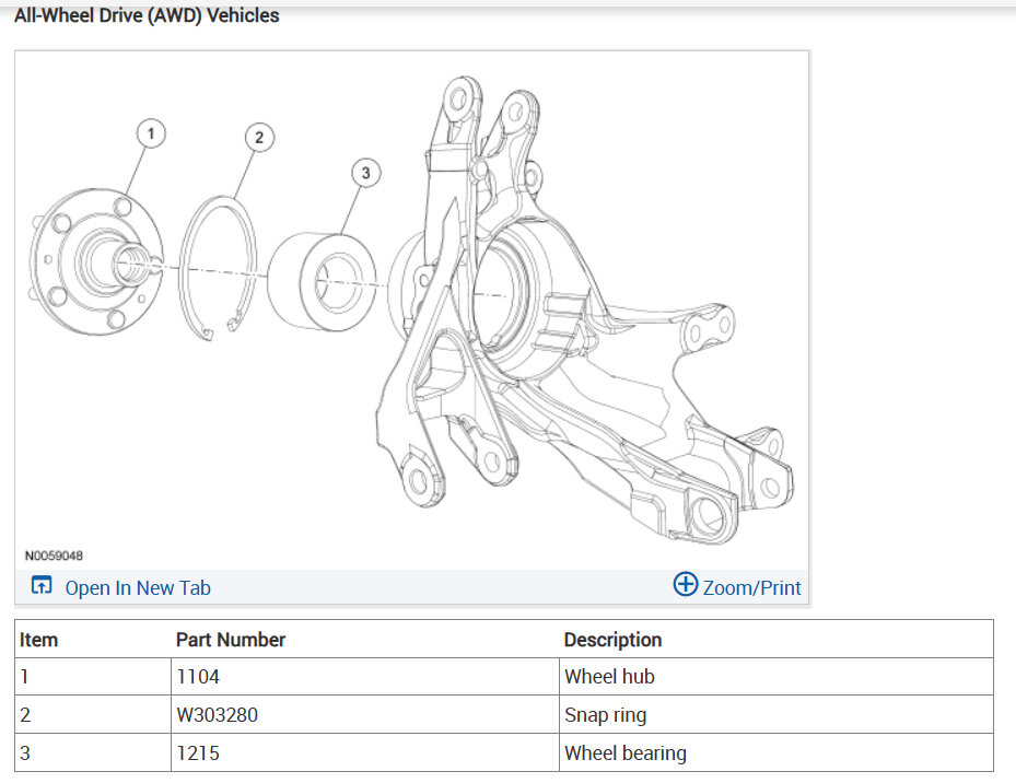

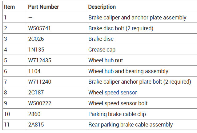

Hello, I have the car listed above AWD. Does the rear bearing come in an assembly? or do i have to press the bearings out? Can i just buy the assembly with the bearing pressed in already?
Jan 22, 2025 at 8:31 AM
  • 54,837 POSTS

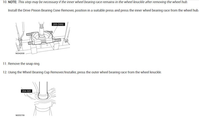

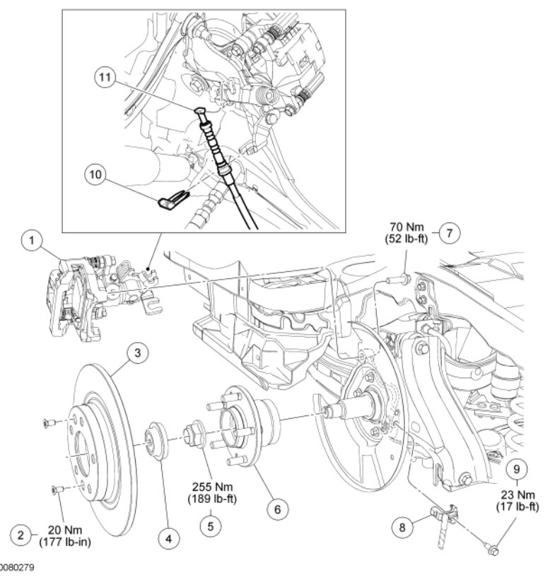

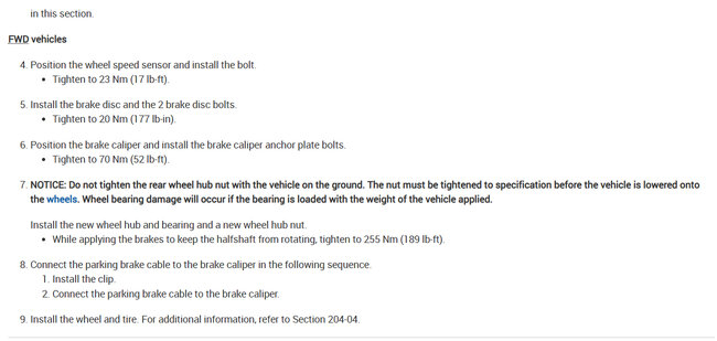

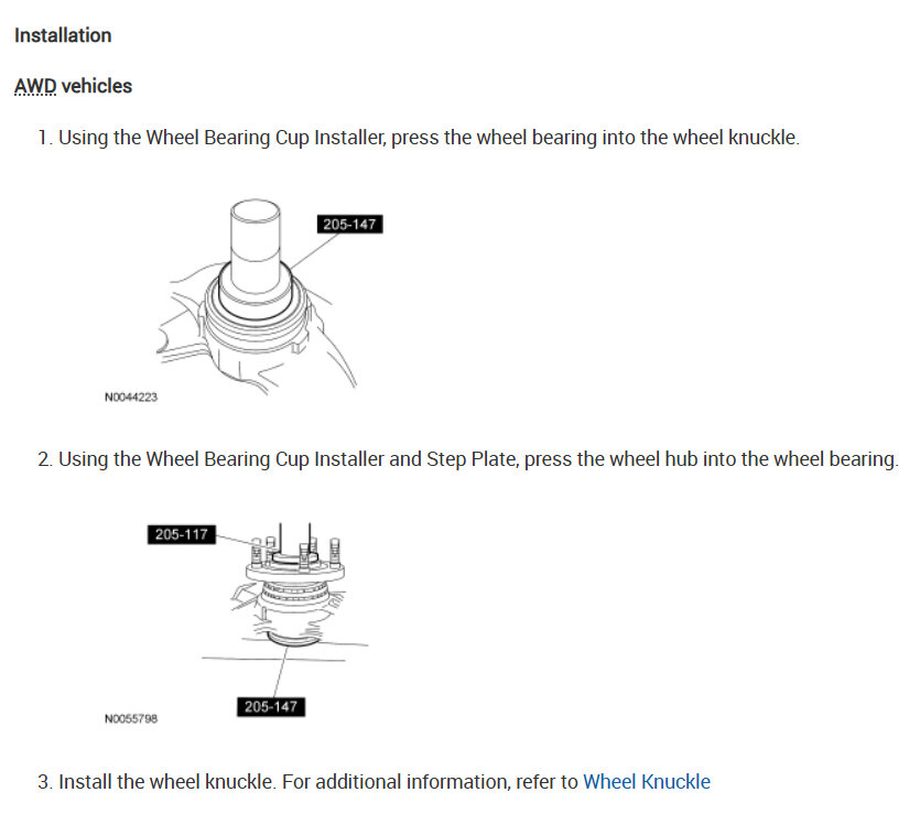

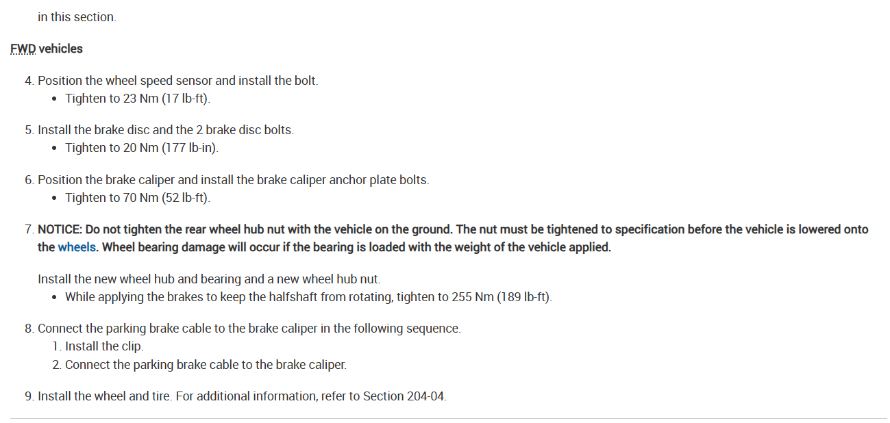

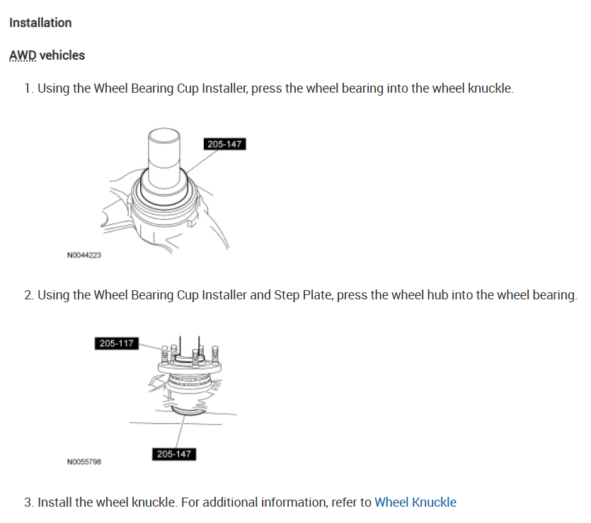

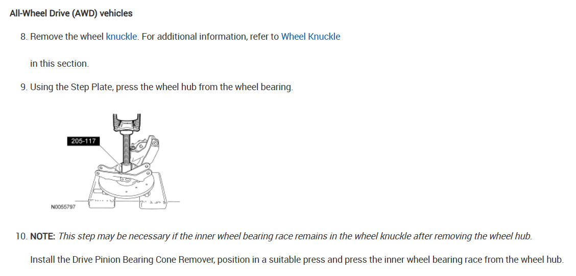

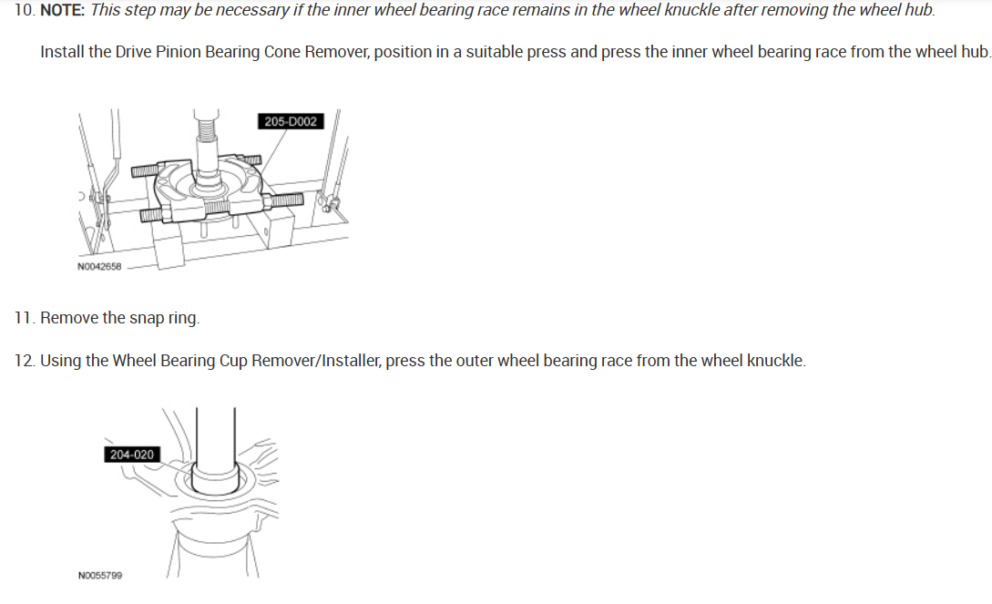

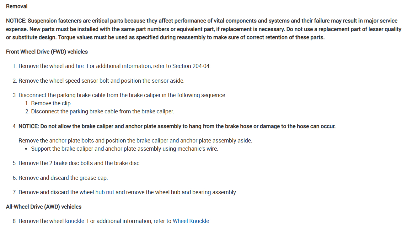

Bummer, yep you need to pressure the bearing out. This video will help, and I have included how the job is done for your car. The car is different, but the procedure is the same.
https://www.youtube.com/watch?v=_FzmmBoa4Tg
Check out the images (below). Please upload pictures or videos in your response of any problems so we can see what to help you with.
