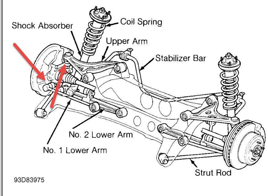

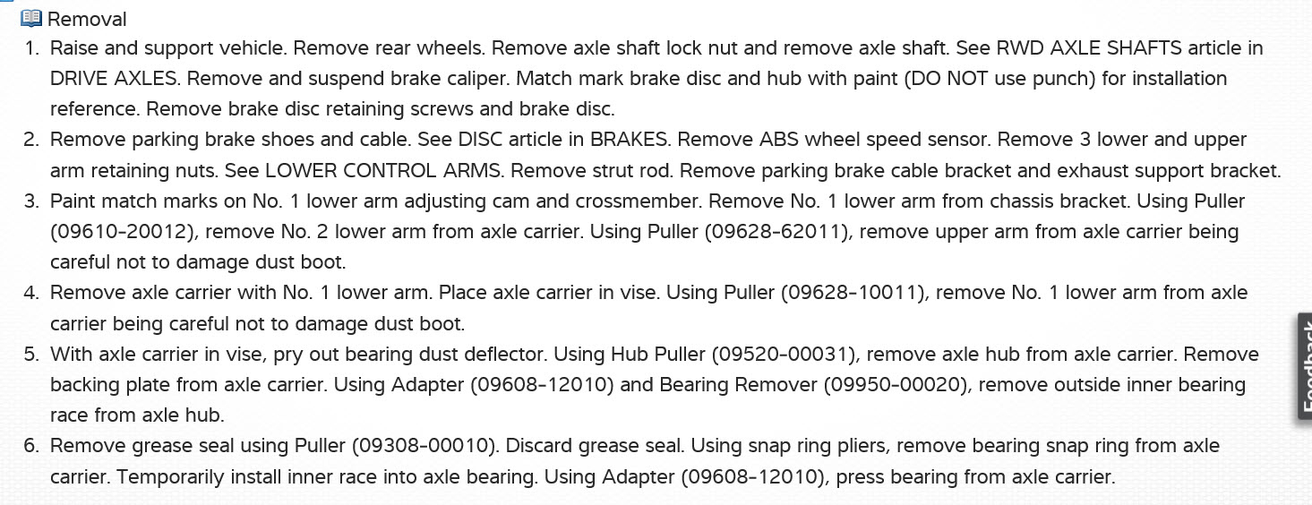

HOW TO REMOVE REAR WHEEL HUB ASSEMBLY AND WHAT SPECIAL PULLER TOOLS ARE NEEDED
Mar 22, 2016 at 9:07 PM
HMAC300
  • 48,601 POSTS
tools may be a tie rod and ball joint tool to separate from other parts. auto parts can press hub from bearing as well as install bearing. see pics for instructions.
