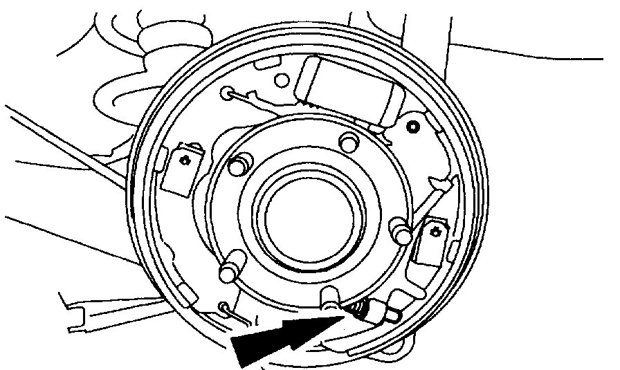

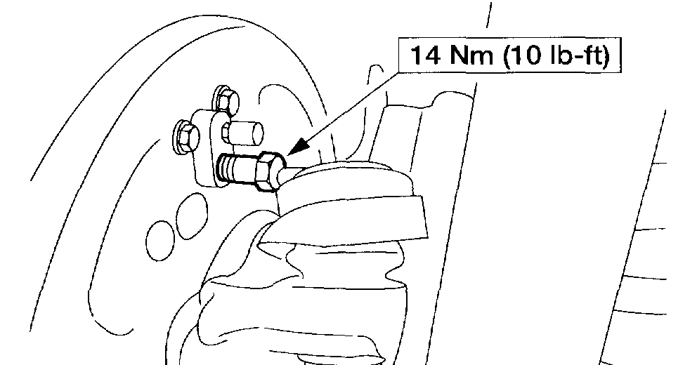

Cylinder on rear left side won't stay compressed to put the drum on.

Are you sure the springs are correctly placed? They should hold it in for you. What work was done? Did you replace the brakes, a wheel cylinder, hardware? Do you have the brake adjuster closed enough to install the drum? Also, could the parking brake be stuck and taking pressure off the spring and allowing the wheel cylinder to move?
https://www.2carpros.com/articles/how-to-replace-a-wheel-cylinder
https://www.2carpros.com/articles/how-to-replace-rear-brake-shoes-and-drums
Here are the directions specific to replacing a wheel cylinder on your vehicle. Take a look through the process and see if there is anything that you may be missing. The attached pictures correlate with the directions.

1. Remove the rear brake drum.
2. Using the Brake/Clutch/Service Vacuum, remove brake dust and dirt from the brake assemblies.
pic 1

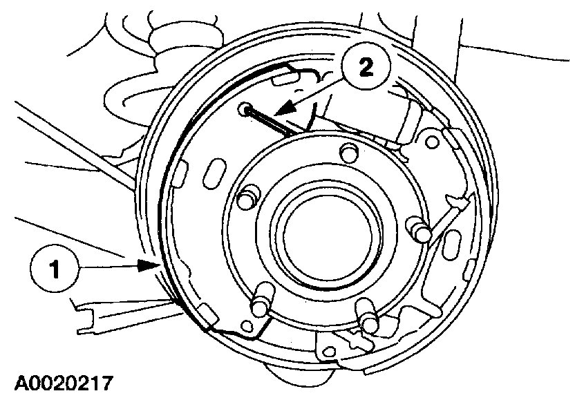

3. Remove the parking brake cable from the parking brake cable lever.
pic 2

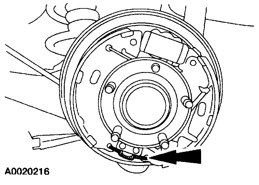

4. Remove the hold-down clips and pins.
pic 3

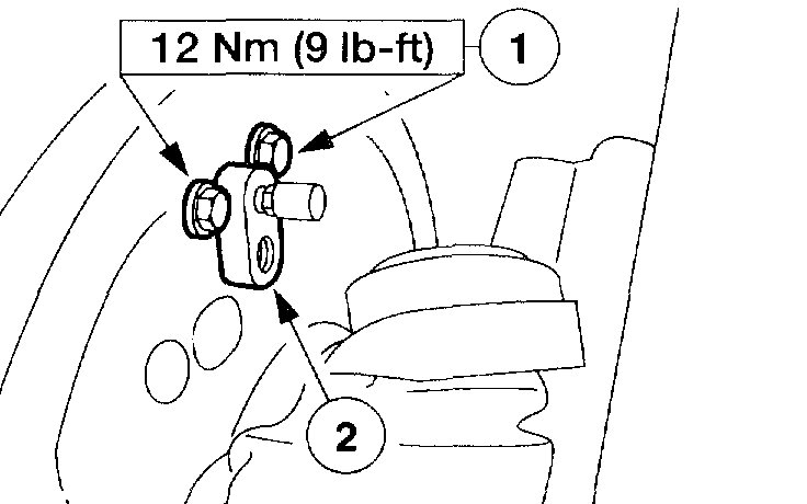

5. Remove the lower spring.
pic 4

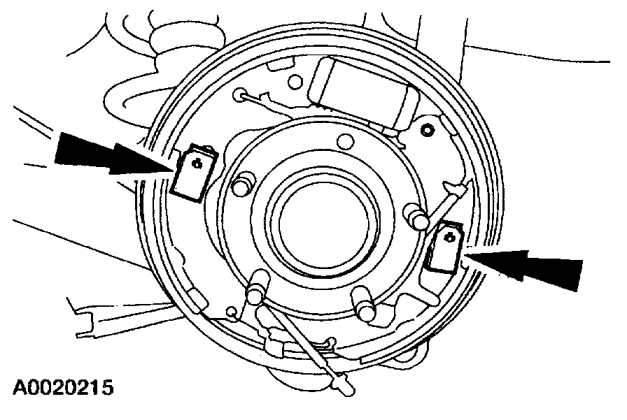

6. Remove the rear brake shoes.
1 Pull the bottom of the brake shoe forward.
2 Release the upper return spring.
3 Remove both brake shoes together.
pic 5

NOTE: When any part of the hydraulic system has been disconnected for repair or replacement, air may get into the system and cause spongy brake pedal action. This requires the bleeding of the hydraulic system after it has been correctly connected.

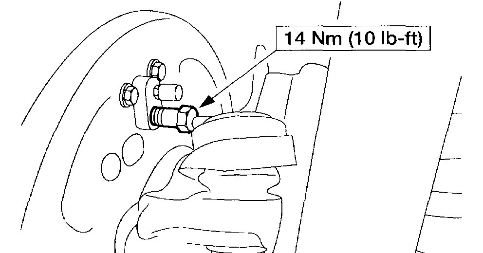

Disconnect the brake line fitting from the wheel cylinder.
pic 6
8. Remove the wheel cylinder.
1 Remove the bolts.
2 Remove the wheel cylinder.
9. To install, reverse the removal procedure.
