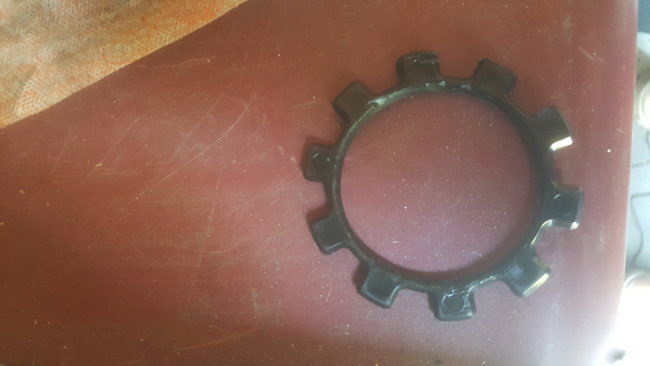

Hi, watched your video about wheel bearing removal and install, excellent instructions. My problem is the black plastic spacer between bearing and internal sleeve, one was damaged when I was removing the bearing and I want to know what they are called so I can order new ones. I would greatly appreciate information on this. I checked all over internet but cannot seem to find them. Thank you.

Hi Roy. It is a 1500 SLE, 4x4, z71. I sent a picture of the part. Hope you can see it. Thanks for the quick response .
Jun 30, 2018 at 2:15 AM
That is the wheel speed sensor tone ring.
Do you have the special tool to install it?

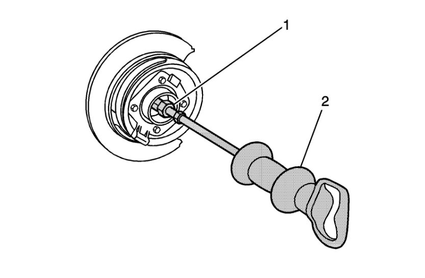

imageZoom/Print
6. Remove the axle shaft seal, the bearing and the wheel speed sensor ring from the axle housing using the J-2619-01 - Slide Hammer (1) and the J-45857 - Tone Wheel and/or Bearing Remover (2).

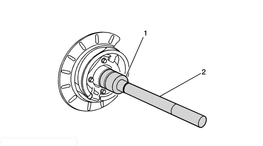

Installation Procedure
imageZoom/Print
1. Install the wheel speed sensor ring using the J-45860 - Tone Ring Installer (1) and the J-8092 - Driver Handle (2).
2. Drive the wheel speed sensor ring into the axle housing until the tool bottoms against the tube.

Thanks for the information. Speed sensor tone ring looks to me that it just sits between bearing and internal sleeve, is that right or not. I looked for video but could not find for rear.
Jun 30, 2018 at 3:04 AM
No, you need to drive it in as the instructions said. It is in there solid.
