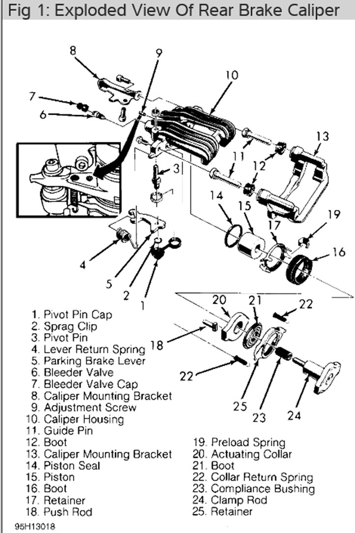

Rear wheel brake and rotor assembly image please.
Thursday, March 30th, 2017 AT 10:57 PM
HMAC300
MECHANIC
48,601 POSTS
There are no pictures of brake rotor in our manual only the caliper which has the parking brake in it. See picture.
