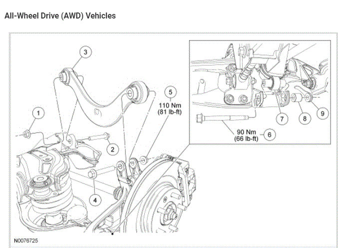

Do the rear upper control arm on the car listed above have a specific direction to be installed? The part looks like it can go in either way.

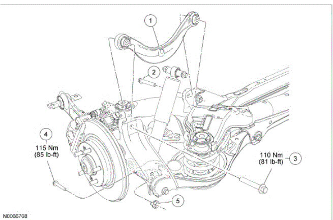

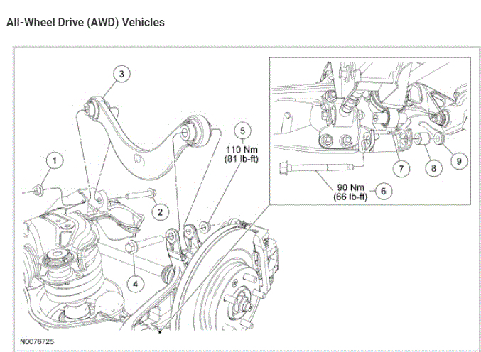

I looked up the directions for removal and replacement. It doesn't indicates a specific direction, so I am going to say it should work either way. Here are the directions. I don't know if you have a FWD or AWD model, but it shows both. The attached pics correlate with the directions.

Front Wheel Drive (FWD) Vehicles
See pic 1
Item Part Number Description
1 5500 Upper arm
2 W712769 Upper arm inboard bolt
3 W500546 Upper arm outboard bolt
4 W704586 Shock absorber lower bolt
5 W302116 Shock absorber lower flagnut
All-Wheel Drive (AWD) Vehicles
See pic 2
1 W520215 Upper arm inboard nut
3 5500 Upper arm
4 W500547 Upper arm outboard bolt
5 W520215 Upper arm outboard nut
6 W712880 Shock absorber lower bolt
7 18080 Shock absorber
8 — Shock absorber lower mount bushing
9 W302116 Shock absorber lower flagnut

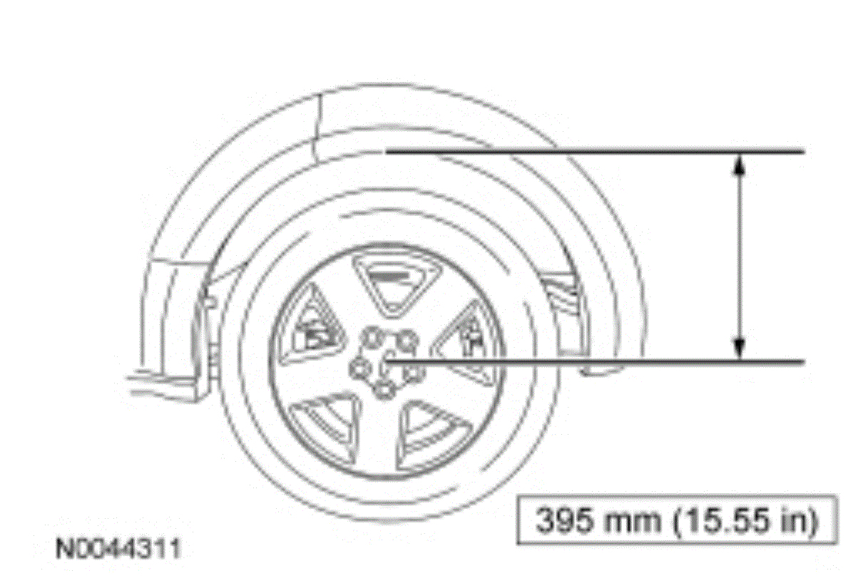

NOTICE: Before tightening any suspension bushing fasteners, the suspension must be at the bushing fastener tightening position. Use a suitable jack to raise the suspension until the distance between the center of the hub and the lip of the fender is equal to 395 mm (15.55 in). This will prevent incorrect clamp load and bushing damage.
