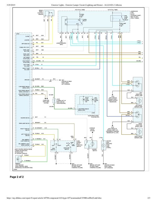

During driving after the vehicle gets to normal operating temperatures I smell what smells kind of like a burning wire type smell. I didn't realize that both my rear turn signals no longer work but my backup lights and brake lights do work. I started testing with a continuity tester and while I was testing the bulb became real bright and then no longer worked. I had the key to the on position but I'm not sure how far I should have had it turned over if I had it too far.

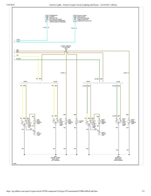

The brake/turn signal is powered by the same wire from the BCM (body control module)
You should have the ignition on, dash lights on to do the testing.
With the brake pedal depressed you should have 12V when probing between the yellow wire and the black wire if you are using a test light/voltage tester. Testing at the plug on either rear lamp unit.
If you have 0V then try taking the probe from the black wire and testing between the yellow wire and a known good ground - chassis ground point.
