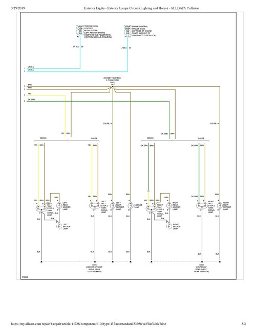

During driving after the vehicle gets to normal operating temperatures I smell what smells kind of like a burning wire type smell. I didn't realize that both my rear turn signals no longer work but my backup lights and brake lights do work. I started testing with a continuity tester and while I was testing the bulb became real bright and then no longer worked. I had the key to the on position but I'm not sure how far I should have had it turned over if I had it too far.
Oh and when I say the bulb became real bright I mean in the continuity tester it blew the bulb in it.

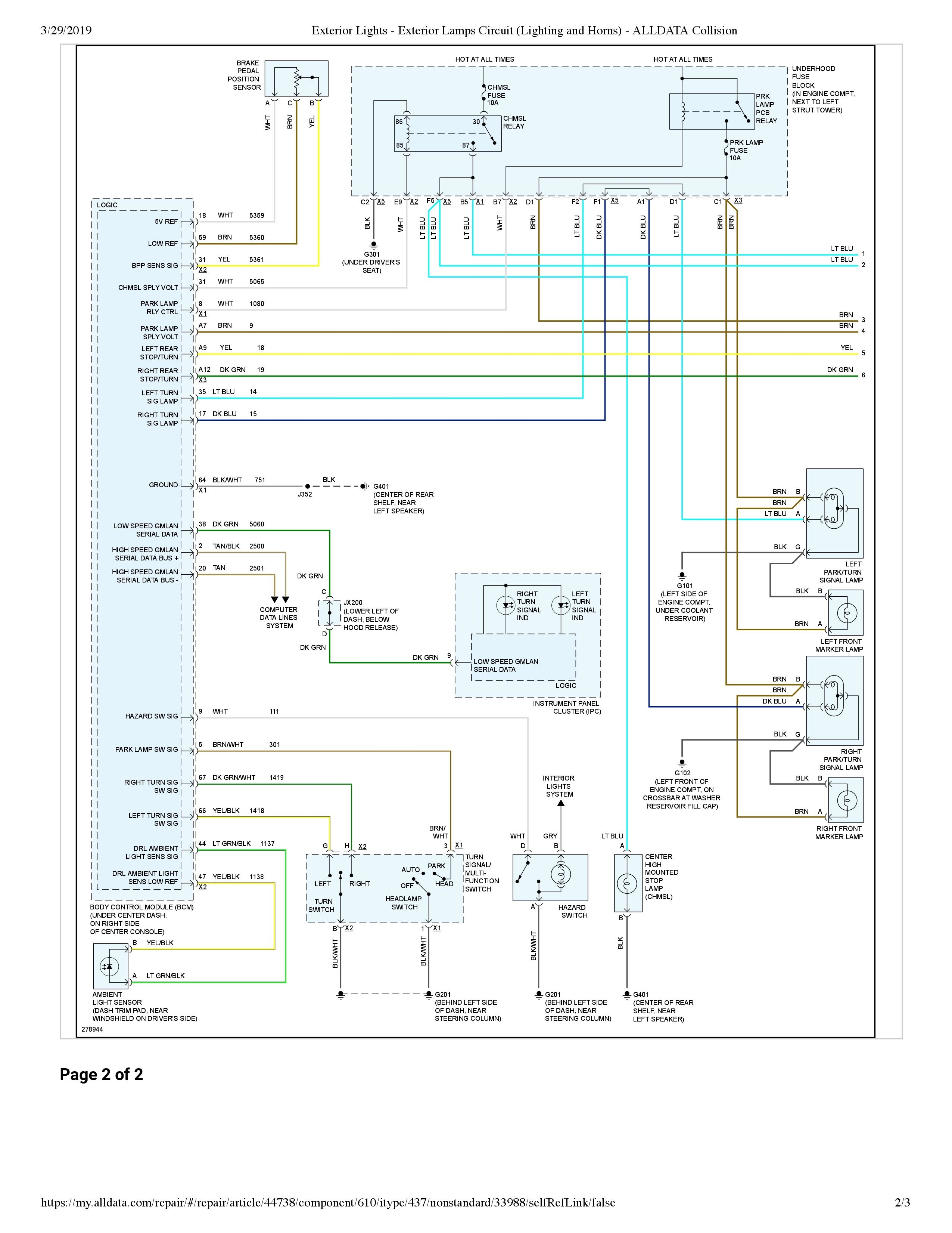

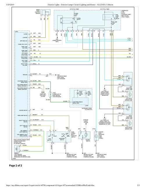

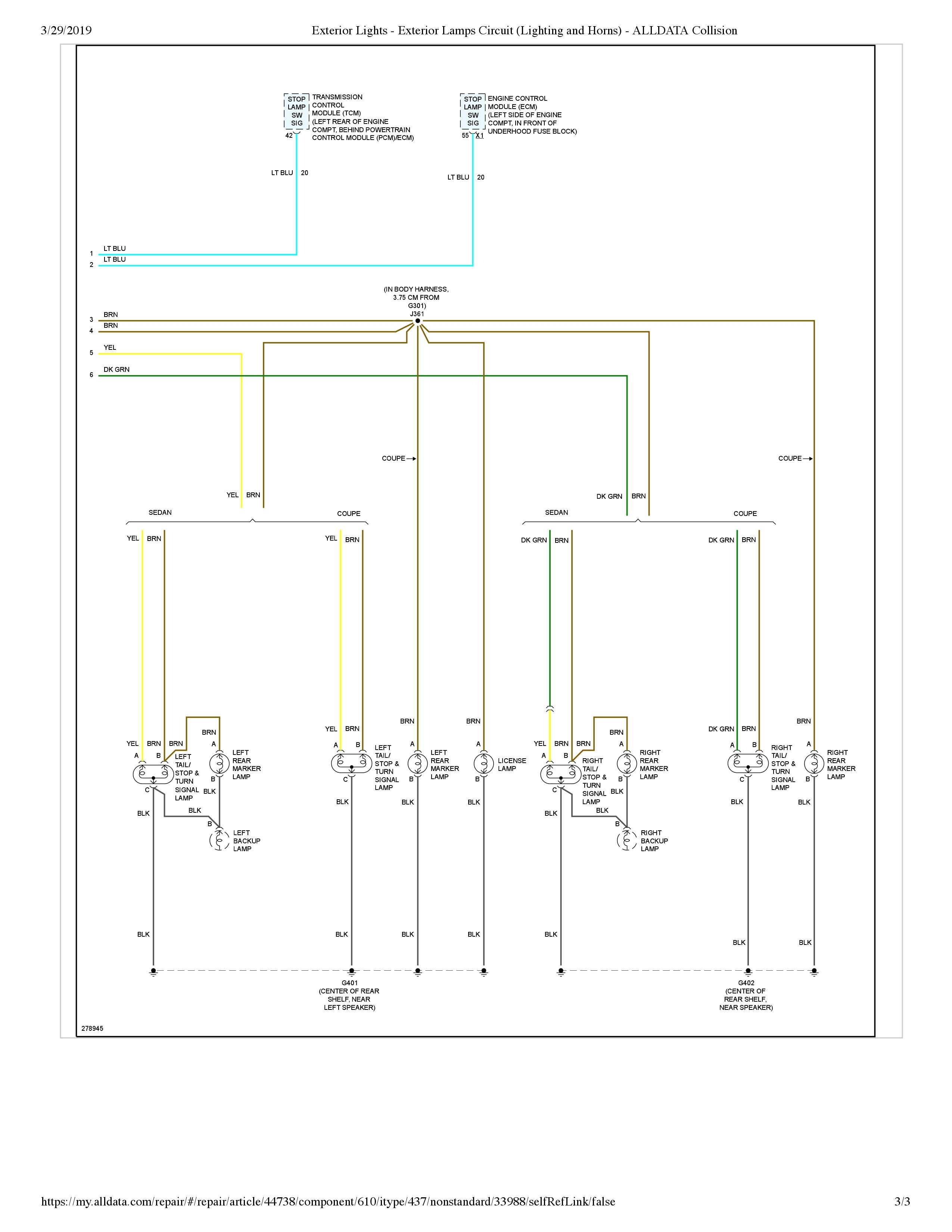

The brake/turn signal is powered by the same wire from the BCM (body control module)
You should have the ignition on, dash lights on to do the testing.
With the brake pedal depressed you should have 12V when probing between the yellow wire and the black wire if you are using a test light/voltage tester. Testing at the plug on either rear lamp unit.
If you have 0V then try taking the probe from the black wire and testing between the yellow wire and a known good ground - chassis ground point.
Let me know the results.
Hope that makes sense, if you need any clarification let me know and i'll try explain a different way.
Hope that helps.
Regards, Joe

Well when I open my trunk I notice a wire hanging down that I never noticed before. It looks like it should be plugged in somewhere. I'd like to send it to you. But my wife was behind me yesterday and she told me my brake lights are working and my back up lights are working. Just my turn signals are not working. My fuses are good. I just didn't think both my bulbs would go out at the same time. Maybe I'll just buy bulbs and see if that is the issue.
Apr 2, 2019 at 12:42 AM
JOETECHPRO
  • 705 POSTS
Hey JOSEPH RECKERT,
You will need to ensure the bulbs are good. Replacing them will rule this out.
Also try turning the hazard warning lights on, do you then get output from the flashers?
Is it just the rear flashers not working?
Put the hazards on and walk around to check all of your flashers, then put each turn signal on individually and check if you are getting anything.
The ignition will need to be on for the turn signals, the hazards will work with the ignition off.
Regards, Joe
