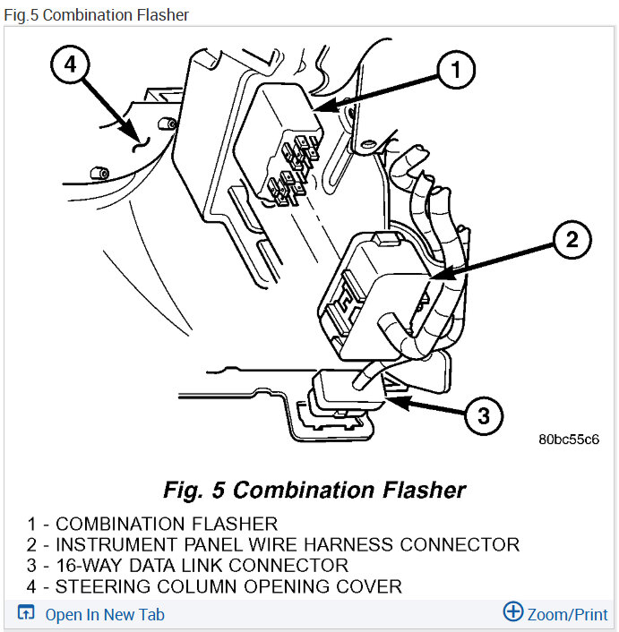

When I turn on my left turn signal both in the rear are flashing. Also, my brake lights are not working. Does it all have to do with the LCM?

This vehicle does not have an LCM. I would check the wiring to the trailer light connector and then check the fuses #5 in the fuse panel under the hood.
This guide can help:
If that is okay, I would swap out the combination flasher under the left side of the steering column. Here is the location of the flasher. Check out the images (below). Please let us know what happens.
