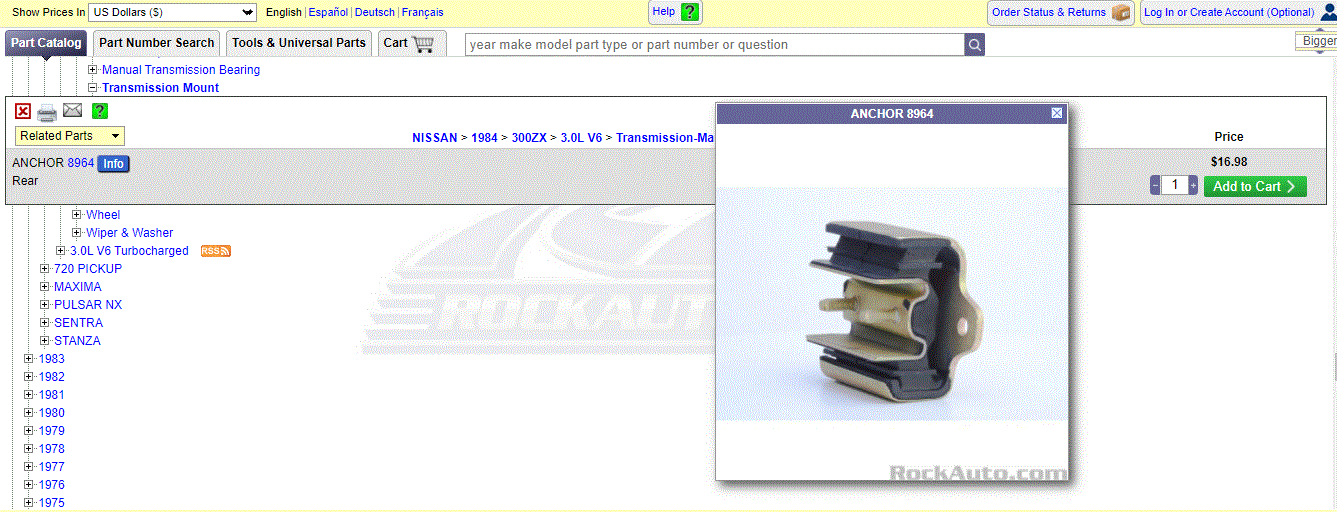

Unable to source correct part. 3 tries all wrong. Does anyone know the correct part number?

I attached a picture for you to view.
Does it look correct? If not, can you post a picture of the mount you have? Check out the diagrams (below). Please let us know what happens.
Sep 11, 2020 at 4:10 AM
  • CAR REPAIR CONTRIBUTOR
To replace mount, go to the back of the transmission. release the 2 bolts holding the mount to the crossmember. Then you need to raise the back of the transmission off the crossmember.
Use a floor jack to move it up and hold it. Then release the bolts holding it to the transmission and remove the mount.
Reverse the process to install.
