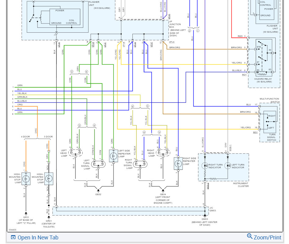

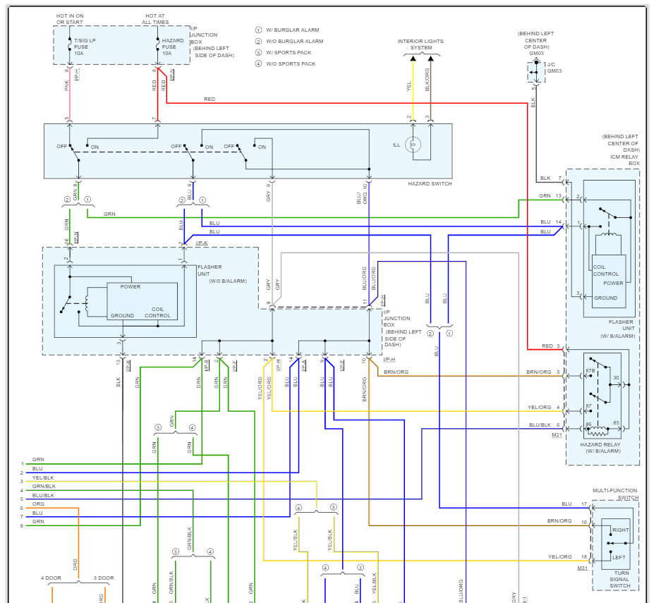

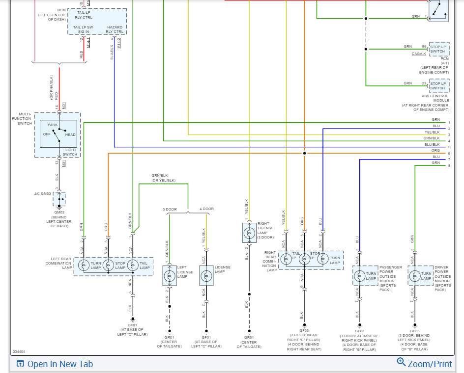

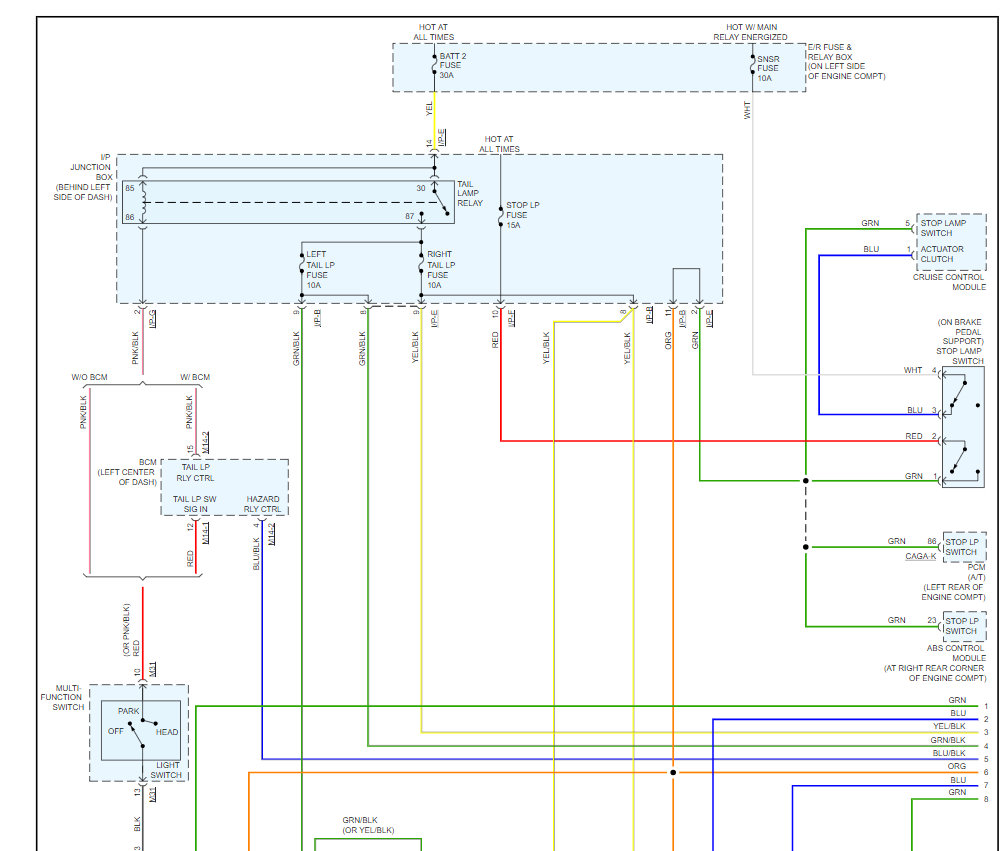

Rear top brake light not working
2010 HYUNDAI I10
29,000 MILES
ROGER MORGAN
MEMBER
1 POST
Checked bulbs and fuses, all okay.
Feb 14, 2019 at 6:58 PM
Experienced Mechanic
55,604 POSTS
All brake lights are wired together so it must be a connecting problem. here are the brake light wiring diagrams so you can see how the system works and a guide to help walk you through the repair:
https://www.2carpros.com/articles/brake-lights-not-working
