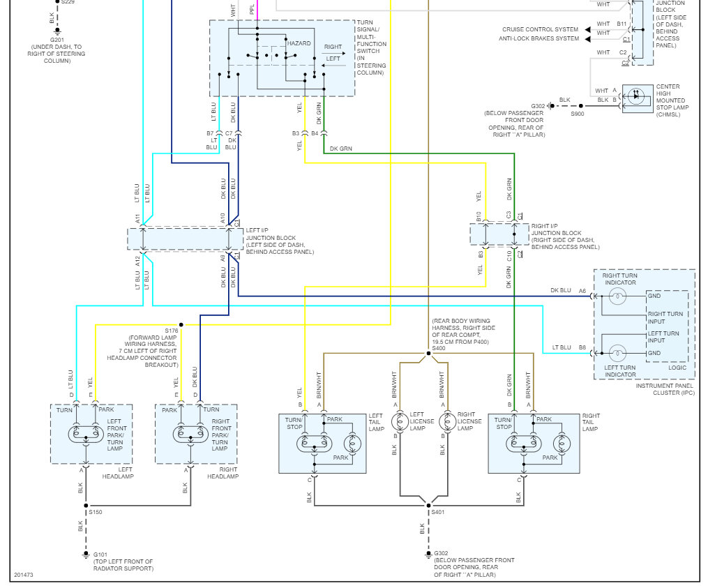

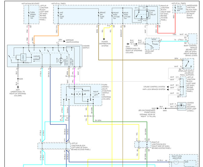

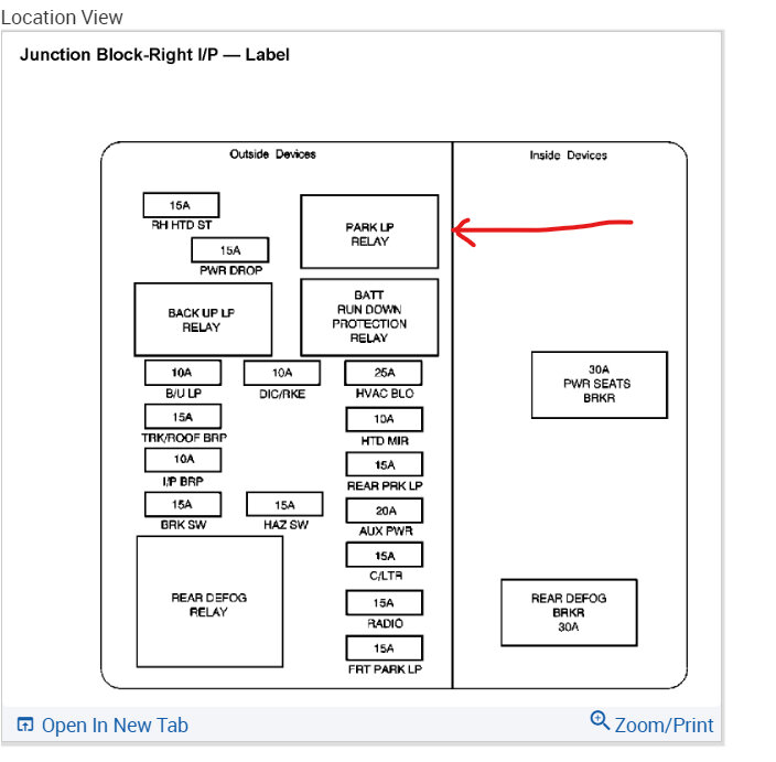

Also, it sounds like the running light control relay is stuck on here is the location on the right side of the dash so you can swap it out which should fix the problem with the lights staying on. Also, here are the running light wiring diagrams so you can see how the system works. Check out the images (below). Please let us know what happens.

Thanks for the diagram that actually includes the rear taillights, I have been looking all over for one that actually included that.

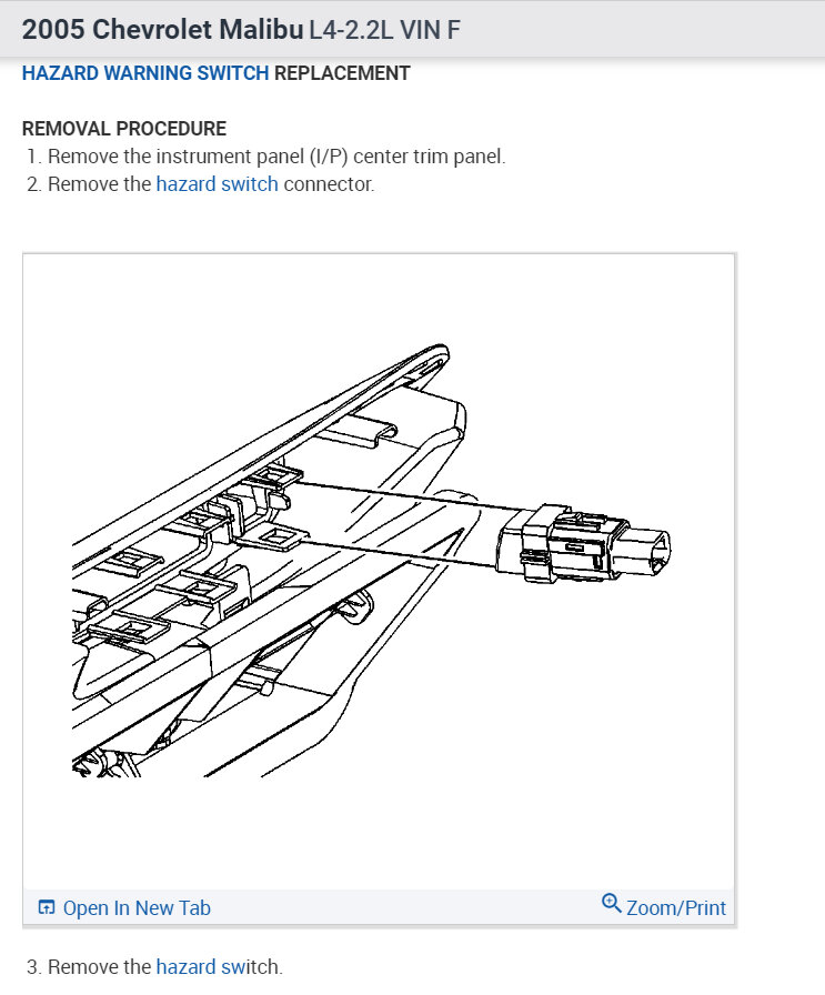

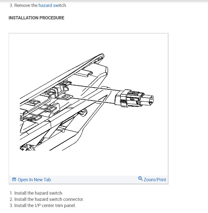

The only other thing I can think of is the hazard switch because there is logic control which is integrated into the switch that might be bad. Only remove the bulbs to make sure you don't find a bulb contact melted. Here is how you can check out the hazard switch in the images below. Please let us know what happens.

I actually replaced the Hazzard switch with a new one, the old one was actually bad, before I had all these problems, the turn signals would freeze up on me, I actually think a short in this switch caused the other problems, I am going to check out your suggestions this weekend I hope, big winter storm on the way, I'm thinking I should just be able to swap relays with the back up or battery drain relay. To see if that is bad, otherwise I'm going to check the bulbs to make sure filament are not broken off and touching or bad bulbs or corrosion or oxidizing. sockets, as well as the ground connection...I was also wondering about a ground connection that is by the passenger door, by the ' A' pillar? Is that under the trim inside the car? By the seatbelt do you know?

Yes, the ground is by the door pillar, also I would recheck the hazard switch you may have gotten a defective one.

Well, I tried to swap out the relay with another one next to it and it was still on, so it probably isn't that, I will check out the actual tail light assembly this week, just had a snow storm and I don't have a garage, so I'm waiting for the weather to get a bit nice, I'll try another hazard switch, to see if that is it, the one I replaced the bad one way blink's a little fast...if it isn't any of those do you think the could be a circuit in the BCM that went bad? I'm just wondering if that might be the problem, because I had to reset it , after this happened, it fixed the other issues I had with the car starting, of its the BCM, that is a little beyond the scope of what I can do, I would think you would need a scanner... initially when this all happened with the security light and the low fuel and the service vehicle soon light flashing I was unable to connect with a 0BD2 scanner, but now I can with the reboot, but no video reading.

I don't see a BCM in the system if you look at the wiring diagrams above you can see there is no BCM, can you try unplugging the brake light switch to see if the lights go out?
Apr 3, 2023 at 3:55 AM
CARY_JAY
  • 17 POSTS
I see the BCM, it feeds into the headline and the relay, 2nd component down on the upper right....

Ken, I'm going to take a look at it this weekend, it is finally going to be sunny and in the 60s here in Minnesota this weekend, I don't have a garage and the weather has not been good. i printed the 2 wiring diagrams and
taped them together so I could look at the "big picture "... the center high mounted stop lamp stays on. and the two on the sides... looking at the diagram, it has to be the brake switch circuit or the hazard switch , the wiring or the ground....I don't think it is the running lights, they are not even on the same circuit, from what I can see... the lights do get brighter when I step on the brake, so I am going to try and adjust the brake switch and see what that does with a helper looking at it as far as if it shuts off when I disconnect it or when manually pushing it in... and check all the grounds and light socket connections... I'll get back to you.... what is the component on the wiring diagram that is right below the stop lamp switch is that a relay? Could that be the problem? There is some.

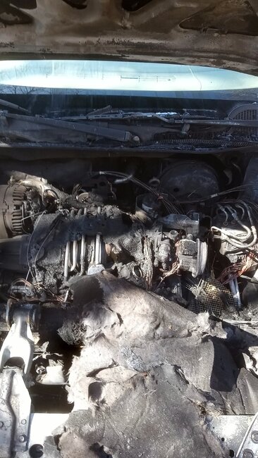

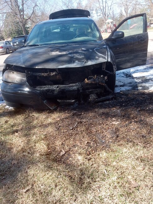

I believe that a short in the abs/traction control module started this , when this initially happened, I noticed what looked like light smoke on the electrical connectors when I lifted the hood, it was pretty cold that day... although I didn't notice again after I cleared the computer and got it started again...it appears to have started in the same location as it, looking at where most of the fire damage is on the right side, and after looking at the fuse box diagram, it looks like the brake switch is located on the same circuit...
Apr 13, 2023 at 1:37 AM
CARY_JAY
  • 17 POSTS
I don't think I could have pulled the fuse, because the PCM and crank are also on the same circuit... maybe if I had disconnected the connection , I was just going to take it in somewhere...oh well... thanks for the help.
