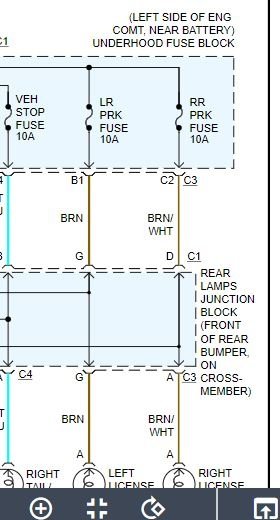

My driver side rear lights work great. Rear taillight/brake light/backup light/turn signal lights are not working.
Nov 25, 2018 at 7:32 PM
  • 110,244 POSTS

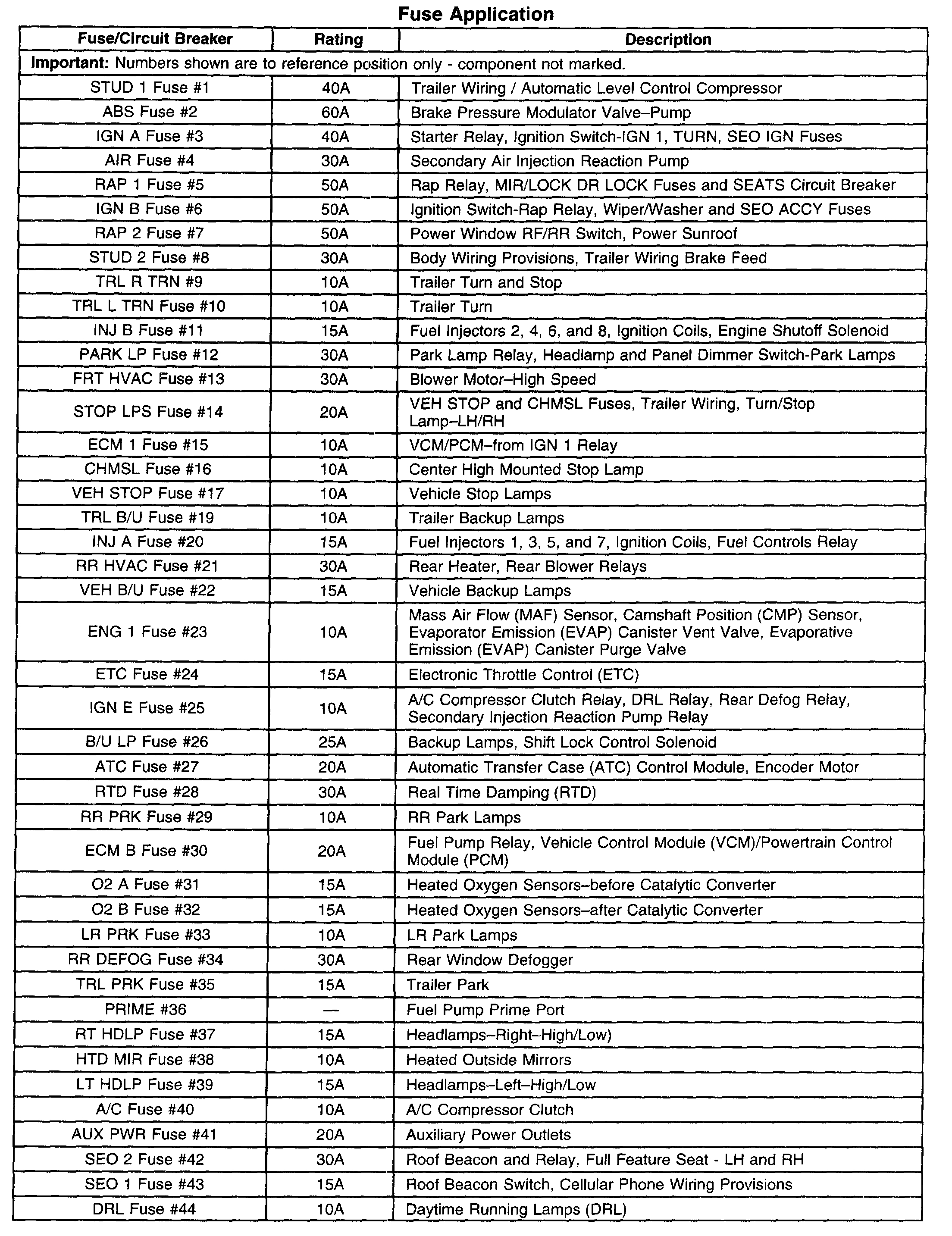

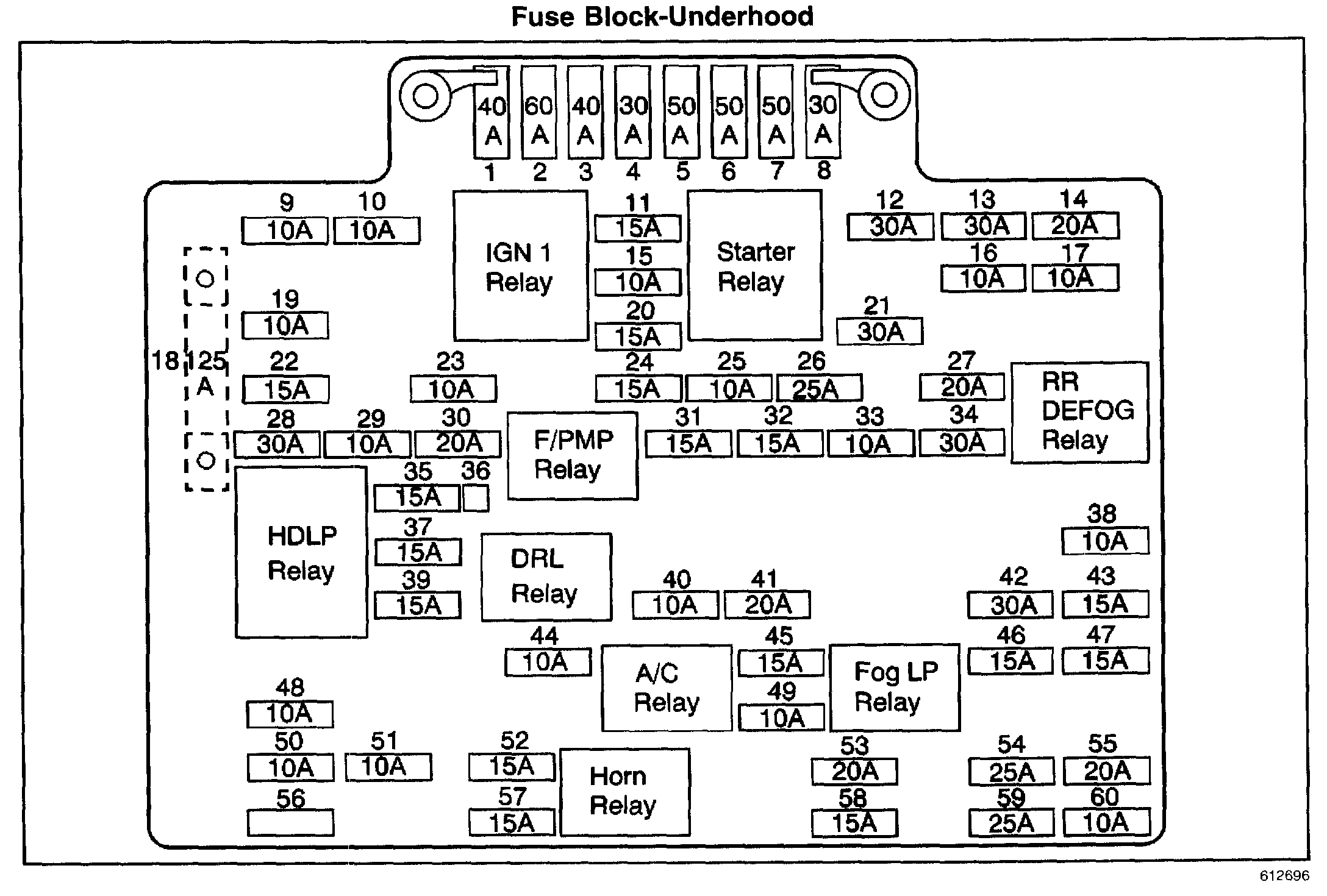

First, under the hood in the power distribution box, locate fuse RR park fuse. It has its own fuse. It should be fuse 29.

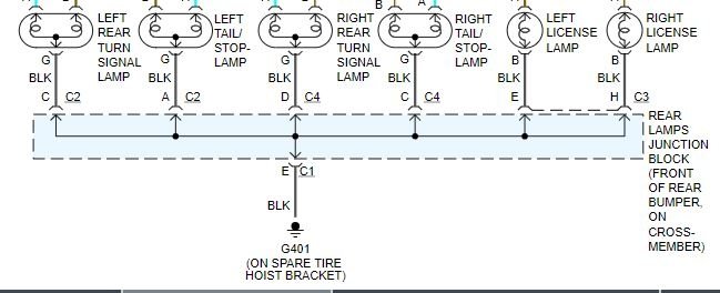

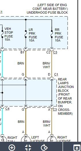

I attached two pics from a wiring schematic. Also, the fuse box to help you locate the fuse. If the fuse is good, all tail lights ground at the same place, but they are spliced together. Check to make sure nothing is corroded or disconnected. See the schematic for location.
Let me know what you find and if this helps.
