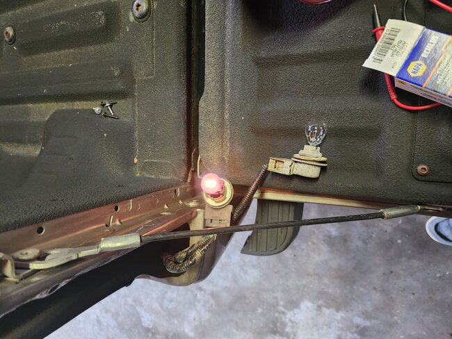

My vehicle listed above started by having the fast right and fast left signal clicking faster when i placed the brake down. Went to WM and got syl bulbs 4157 for brake 3156 for reverse lights When turn on or engages for signal still get fast clicks and all lights are very dim ie: turn, reverse and brake 3rd light is normal I have not check fuses as of yet or gone in dash for turn signal relay FYI i do have an exposed pig tail on back of truck.

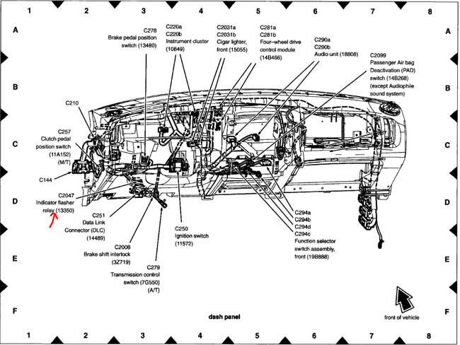

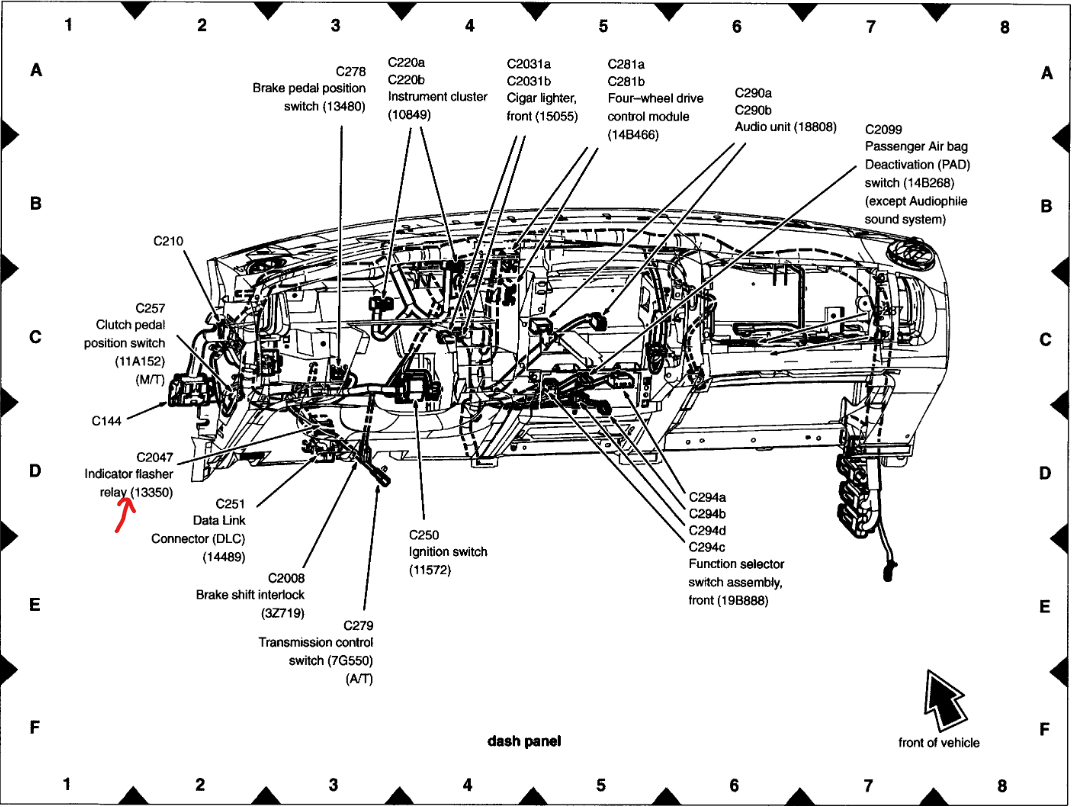

Once the bulbs are correct you will probably have the same problem of them blinking fast. This is because the flasher module is going out, here is the location so you can change it out to help fix the problem. Check out the images (below). Please upload pictures or videos in your response of any problems so we can see what to help you with.

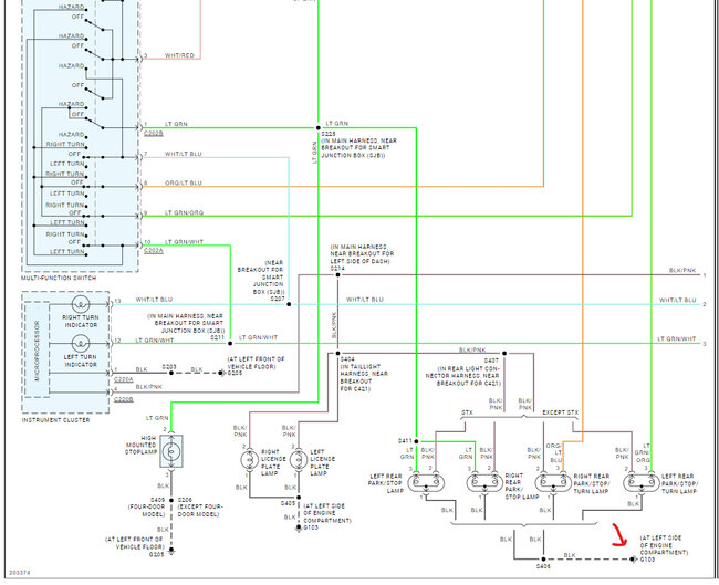

okay, placed correct bulbs in sockets Reverse does not come on turn signal, stop lights, parking light are filament thin. So, do i replace all of the sockets next and just work backwards or would you look for a bad ground? Do you think the relay has anything to do with this?
Oct 23, 2024 at 4:42 AM
  • 54,832 POSTS

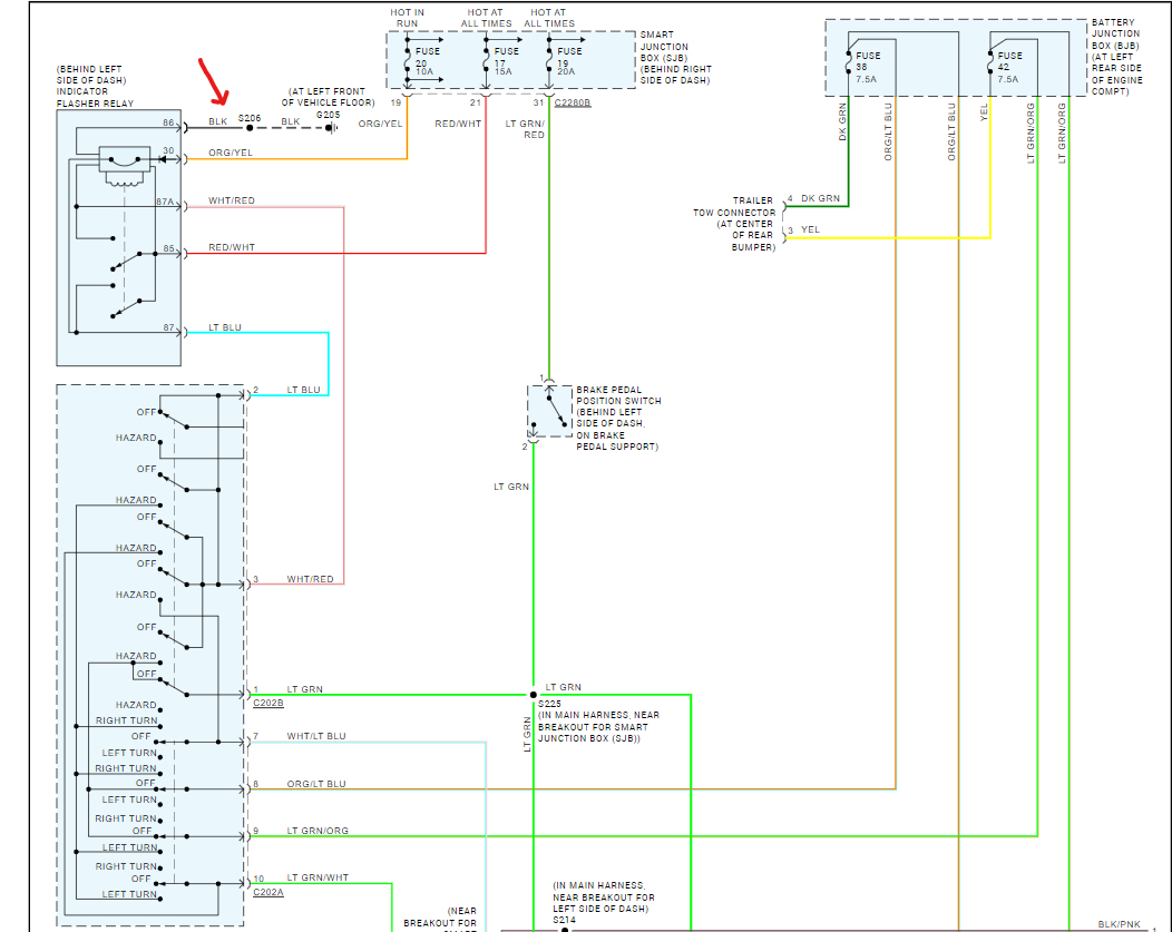

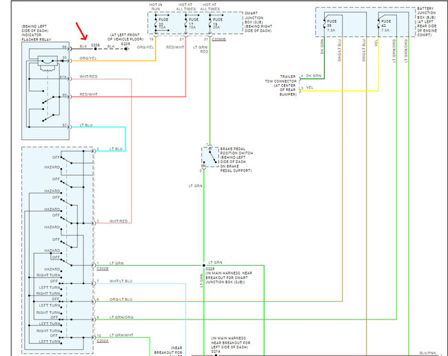

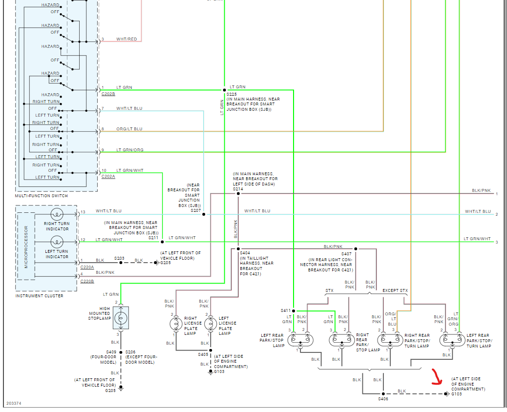

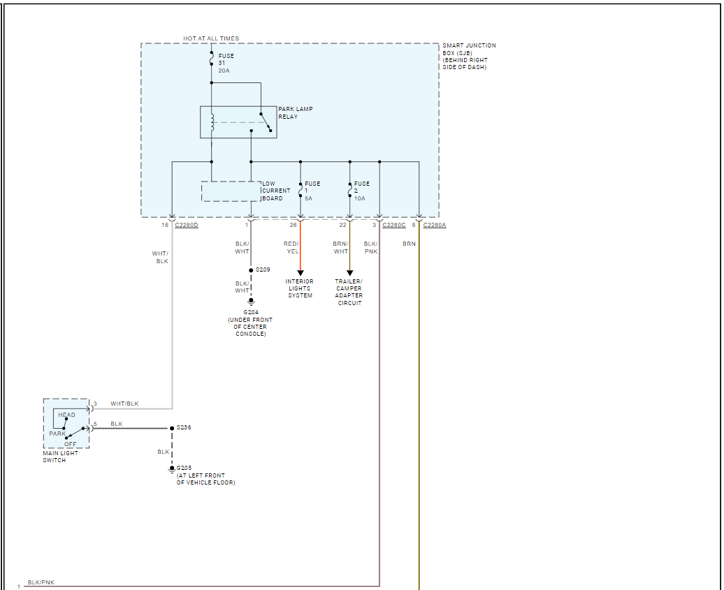

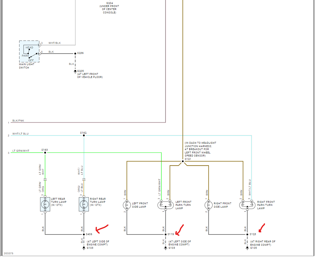

Yes, I would check the ground for the system. here is a guide to help you and I have included the wiring diagrams, and I have marked the ground wire to test.
Connect the test light to power and remove the bulbs before testing the black wires.

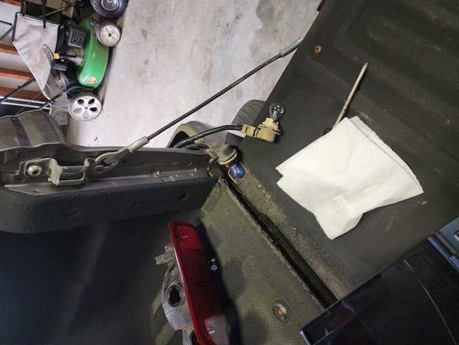

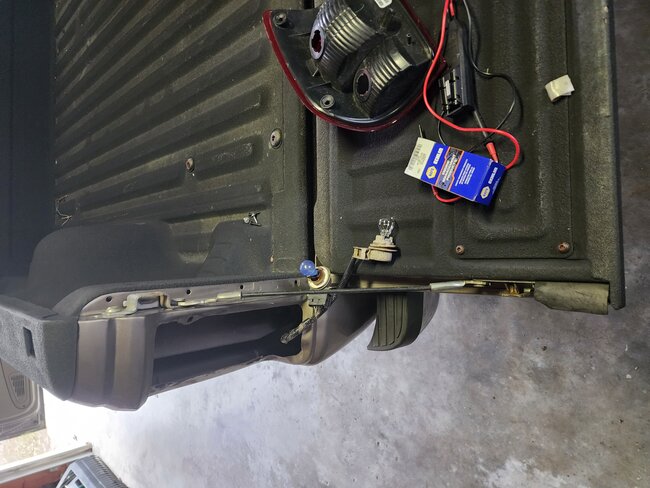

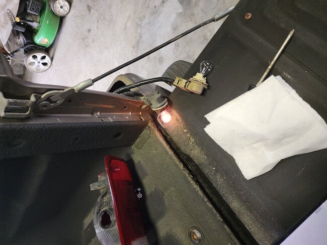

Update replaced turn siginal relay nothing has updated 1. New relay
1 and 2 show bp depress
3 and 6 show light switch no bp drepressed
4 and 5 show high mount with bp and wo
Cut pig tail off have not wrap yet went under truck inspected up to grpound all looks good.
Have not tested ground with light as i only have cheap volt meter.
Thoughts Ed
Dec 26, 2024 at 1:04 PM
  • 54,832 POSTS
Thanks for the images, is the blue bulb custom? If not, the bulb is bad. I would check the ground and then if that is okay replace the flasher module.

Hello, the bulb is right out of a Sylvania package no am on these issues.
I have another observation.
Vehicle running brighter but not the best brake on with headlights and goes dark at brake bulbs.
Reverses does about the same. do you think i should replace the sockets for all 4 or just keep with diagnosis?
Dec 27, 2024 at 10:29 AM
  • 54,832 POSTS
The bulbs are supposed to be clear.
Dec 27, 2024 at 10:48 AM
ED RANGER 64
  • 6 POSTS
no problem will go get them.
Dec 27, 2024 at 10:49 AM
  • 54,832 POSTS
Okay, I think that should fix it.
