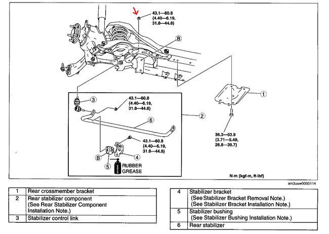

rear sway bar upper nut?
156,000 MILES • 1.8L • 4 CYL • 2WD • MANUAL
PMCMASTER
i bought the car listed above and the rear sway bar links were just replaced after driving it 1 week a noise started i looked under n the rear right side upper nut was loose i tightened the upper nut when the car was jacked up on that side n it drives fine now no noise but was wondering will that be fine like that how i did it as i read google says to tighten it in load ect., but it was only the upper nut where there's no movement of rubbers etc.
Oct 4, 2024 at 2:51 PM
  • 55,743 POSTS
Yep, you should be good, just make sure the nut is tight, and you are good to go, please check out the images below to see what I am talking about. Check out the images (below). Let us know if you need anything else.
