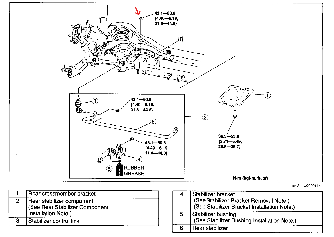

i bought the car listed above and the rear sway bar links were just replaced after driving it 1 week a noise started i looked under n the rear right side upper nut was loose i tightened the upper nut when the car was jacked up on that side n it drives fine now no noise but was wondering will that be fine like that how i did it as i read google says to tighten it in load ect., but it was only the upper nut where there's no movement of rubbers etc.

Yep, you should be good, just make sure the nut is tight, and you are good to go, please check out the images below to see what I am talking about. Check out the images (below). Let us know if you need anything else.
