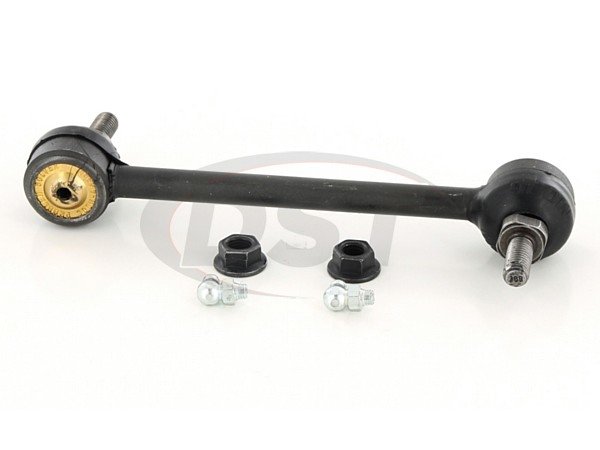

I am replacing the rear sway bar links and the sway bar bushings on my car. When I got the link kit, I notice there are two small silver elbow type screws that look like they screw into the ends of the links which I assume are for applying grease via grease gun. The thing is I have watched dozens of videos of replacing the links and in every one of them, they do not bother with these screws or with greasing the links. They just install the links without the screw adapters and put the wheels back on. I have added a photo that is not exactly like the ones I have but very close. So I guess I am wondering if these screws are necessary and if I should get a grease gun and apply grease using the screws or if they are already pre-greased and ready to go. I am just not sure why they did not bother installing them in any of the videos or apply grease before reinstalling the tires. Probably a silly question but, better safe than sorry. Any help would be appreciated. Thanks.

Those screws are grease fittings and they are necessary when they are included. There are different designs for this part. Some are sealed and cannot be greased. Yours is the design I prefer that does need to be greased occasionally. There is going to be some grease already in there from the manufacturing process, so do not panic if you do not add more right away. What you are going to have to remember is each time you take the car in for an oil change, inform the service writer of the grease fittings on the rear anti-sway bar links. No one is going to go looking for them unless they are told about the new grease fittings.
This was a double-big problem on 1980's Ford Escorts and Tempos. Their ball joints and tie rod ends were of an uncommonly poor design that rarely lasted much more than 15,000 miles. The aftermarket replacements addressed the shortcomings and added grease fittings. We all knew those cars were built too cheaply to have grease fittings, so we never bothered to look for them unless we were told about them. If they got greased at every third or fourth oil change, that was good enough, but if they never got greased, the parts would wear out too soon. (Even with no grease, those improved parts easily lasted ten times longer than the original parts).

Okay, thanks. I usually do my own oil changes and I used to have a grease gun and would grease the ball joints, tie rods etc. myself but the grease gun was stolen during my last move. Guess I need to invest in a new one. Do all of these parts take the same type of grease, as in, can I buy one grease gun and one tube of grease for all the parts that need regular greasing or do different joints, links etc. require different types of lubricant?

There actually are different grease formulations, but it comes down to what the person ordering for the shop chooses. Some are less expensive in a 30-gallon barrel. Some are only available in a five-gallon pail. Those can be pumped into hand-held grease guns so each mechanic can fill his own when necessary. The small tubes are the most expensive way to buy grease, but it's the only practical way for a home owner to buy it. It comes down to which advertising or features you prefer.
Besides lubricating the joints, the grease fills voids so dirt and water won't enter. The cheaper greases are okay at lubricating, but the expensive ones are very thick and stringy. Those tend to stick to the parts better and the need to add more grease is not as frequent. With a high-quality grease, you can get away with greasing anti-sway bar links every 10,000 miles or more.
Years ago relubricating front tapered wheel bearings was a standard part of a front brake job. Those bearings were adjusted to have a very sight clearance between the rollers and race. To over-tighten those bearings would squeeze the grease out from between the rollers and race, and that would reduce the lubrication for the rollers. Shops needed to buy wheel bearing grease that would cling to the rollers, then we would use it for ball joints and tie rod ends too. To buy a second, less-expensive grease for those joints would cause confusion and require everyone to have two grease guns. Instead, we just put the better stuff in places it didn't have to be that good.
That wheel bearing grease is still available, but it's more than you need if you don't have wheel bearings to repack occasionally. Grease is most important when isolating parts that slide across each other. In ball-and-socket joints, the wear comes from the hammering action, and grease doesn't really do much for that. The grease just gets pushed out, then the two parts bang into each other. It's keeping the dirt and water out that grease is needed for most.
Keep in mind that many anti-sway bar links, and even ball joints and tie rod ends are sealed and there's no way to add grease. They need to withstand the same forces, but when they're sealed properly to keep dirt out, they don't wear out much faster than greaseable joints.
