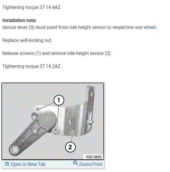

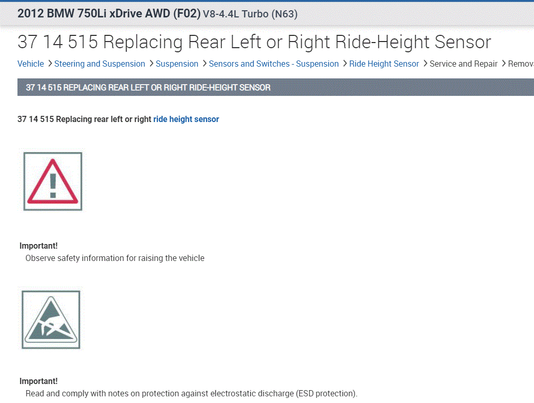

Right rear suspension- trouble code: D01B7C- (self-leveling suspension, vehicle, 259.3.4) missing, receiver ICM, transmitter EHC. Can you please inform me exactly where my "EHC" is located on my vehicle?
Feb 3, 2022 at 12:14 AM
  • 110,240 POSTS

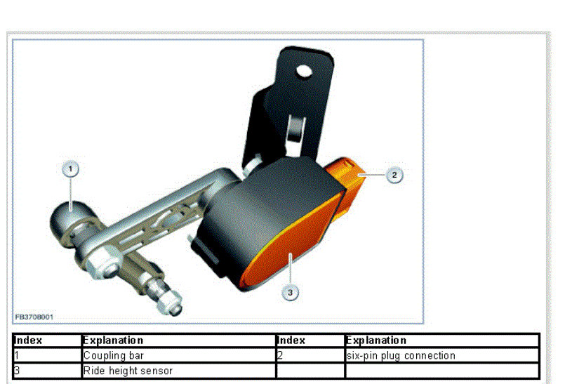

The height ride sensors are on both the left and right-side rear of the vehicle. See pic 1

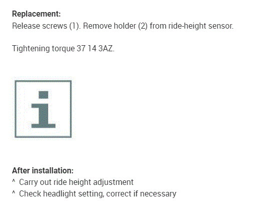

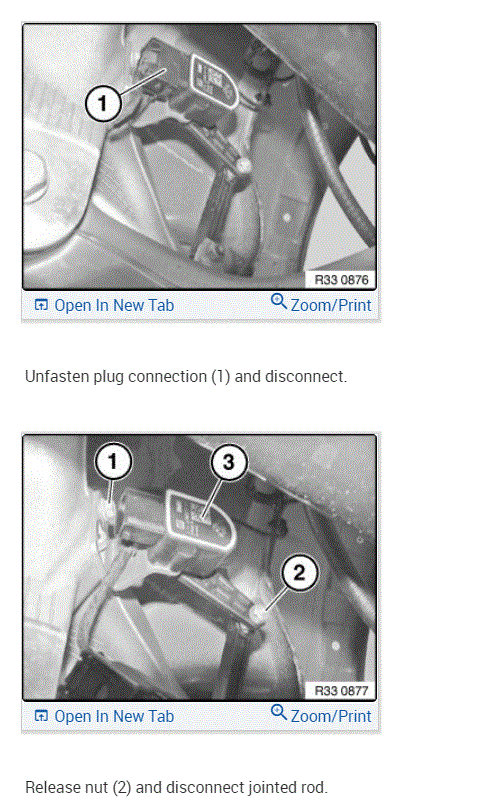

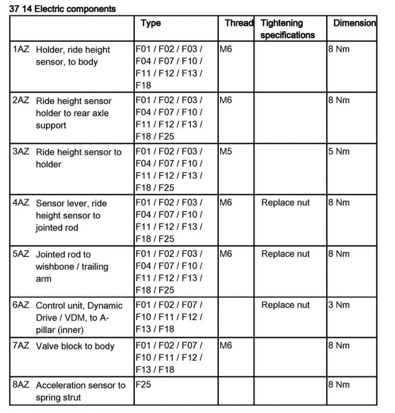

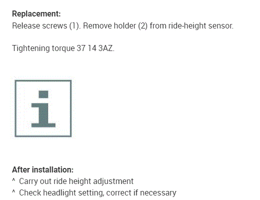

If you look at the remaining pics, they provide directions for replacing one.
