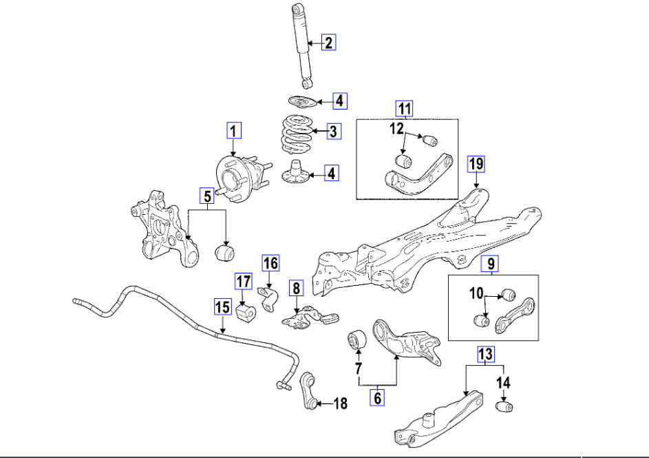

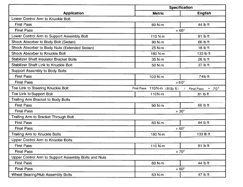

Looking for rear torque specs for the following:
1). Rear rearward lower control arm (to frame and to knuckle).
2). Rear forward control arm (to frame and to knuckle).
3) Rear lateral link bar (to frame and to knuckle).
4). Trailing arm (to frame and to knuckle).
5). Sway bar links (to knuckle).
6). Sway bar bushing bracket bolts to frame.

Sure, we got you covered, here are the rear suspension control arm and sway bar torque specifications as requested in the images below. Check out the diagrams (below). Please let us know if you need anything else to get the problem fixed.
Sep 3, 2022 at 8:53 AM
MSODAONE
Thanks Ken. This is a great help!!! The majority of the torque specs I couldn't find anywhere, hence decided to reach out.
