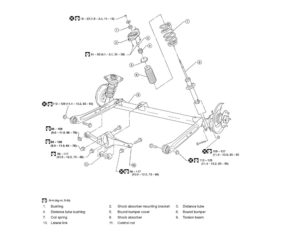

What are the torque specs for the rear strut nuts, both the two top nuts, and the one bottom nut?

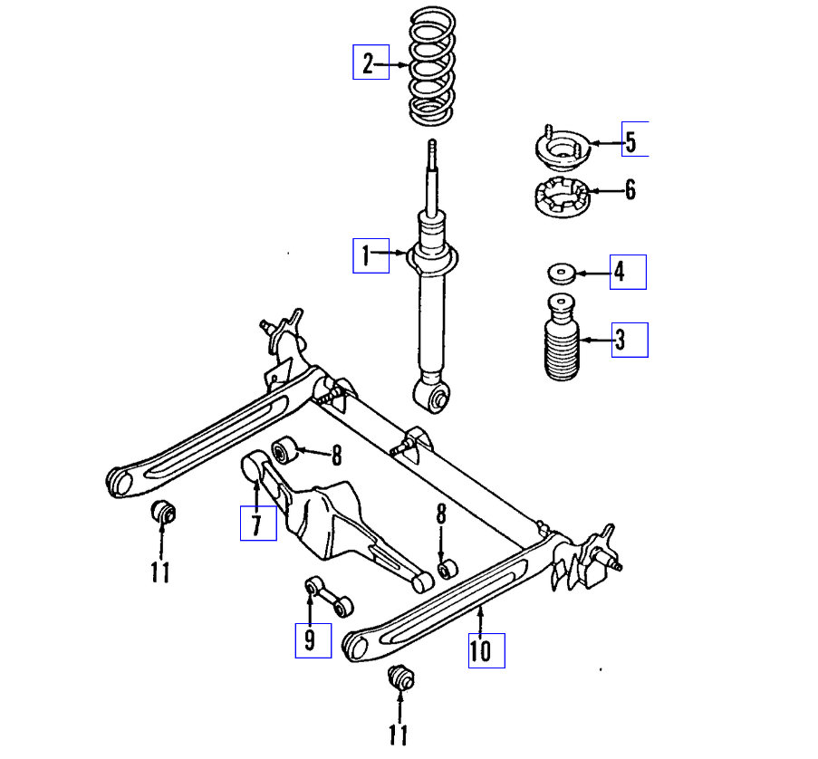

Sure, here are the torque specs for the rear suspension including the rear struts and strut mounts. Check out the diagrams (below). Please let us know if you need anything else to get the problem fixed.
