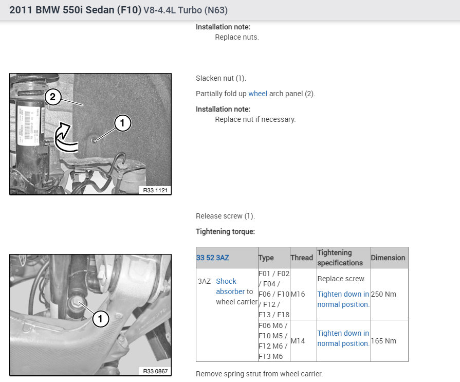

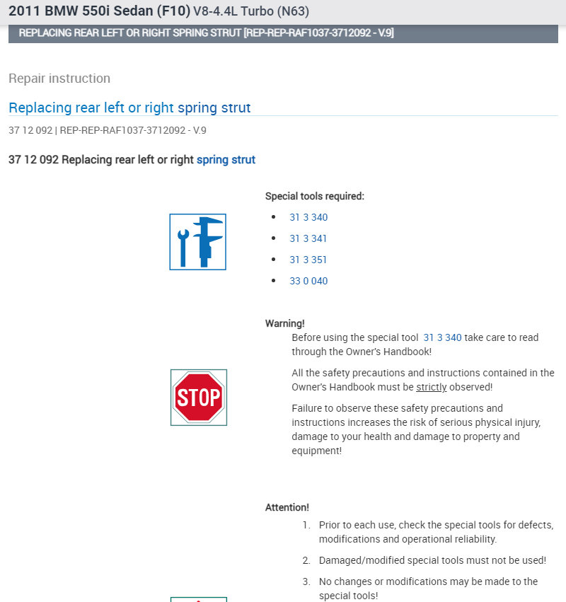

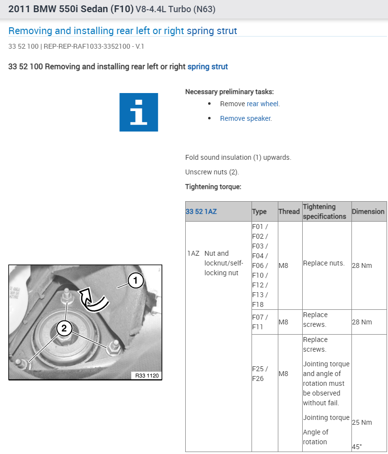

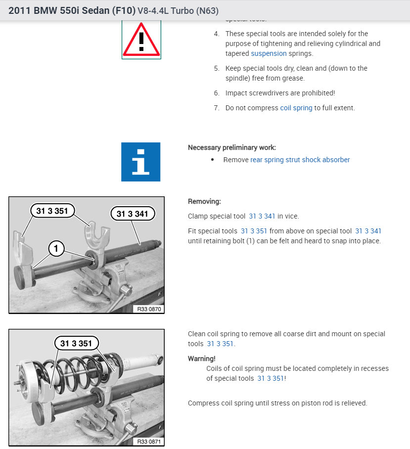

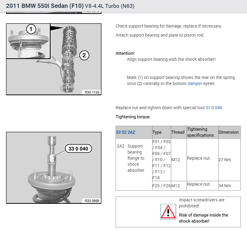

Gents,
Again, I’ll start by thanking you in advance because your feedback and advice are always more than helpful.
Using your advice, I successfully replaced the front strut shock absorbers on my car.

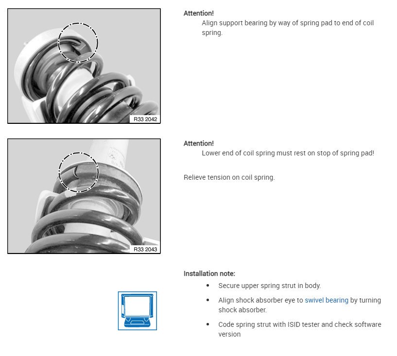

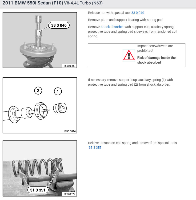

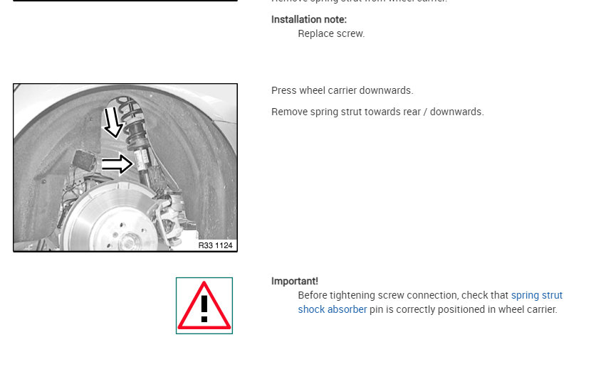

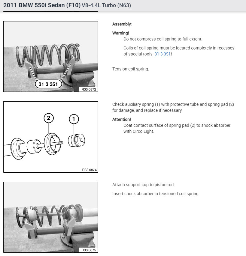

Can you please provide the work process details to remove and replace the rear strut shock absorbers, associated wear out components, including torque specifications and pro tips?
Many thanks!
Jul 26, 2022 at 12:49 PM
SQM
  • 6,383 POSTS
Thank you very much for your feedback. We are always happy to help out.
See attached for the rear strut replacement procedures.
Let me know of any questions.
https://www.2carpros.com/articles/how-to-replace-a-suspension-strut-and-spring
