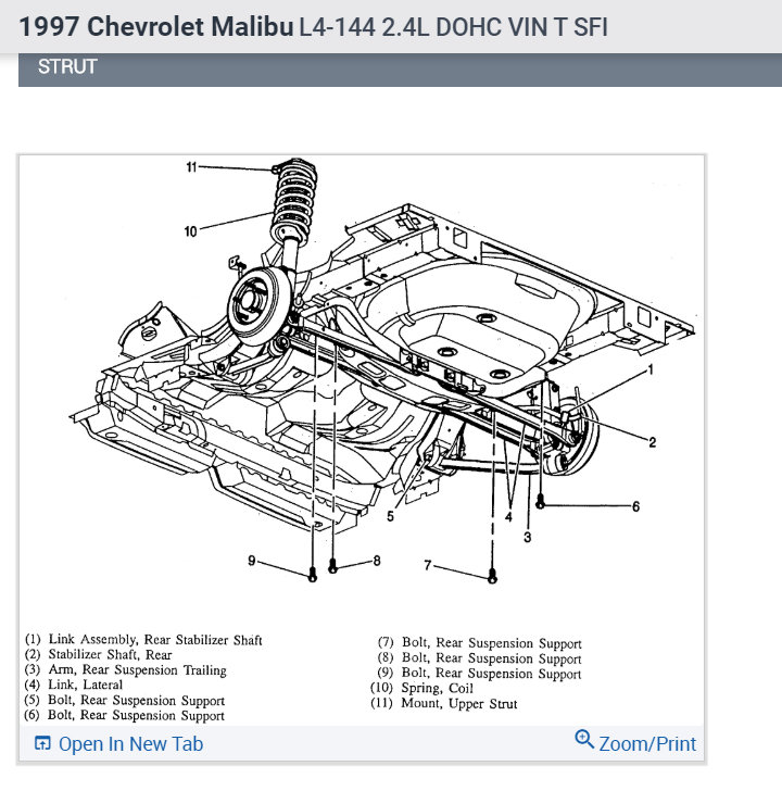

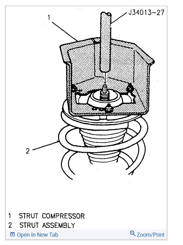

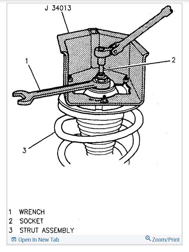

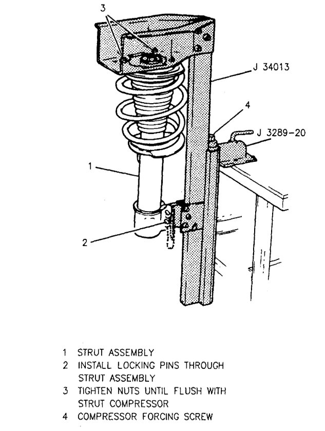

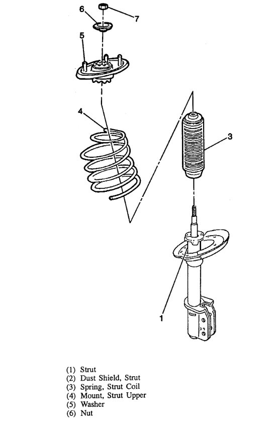

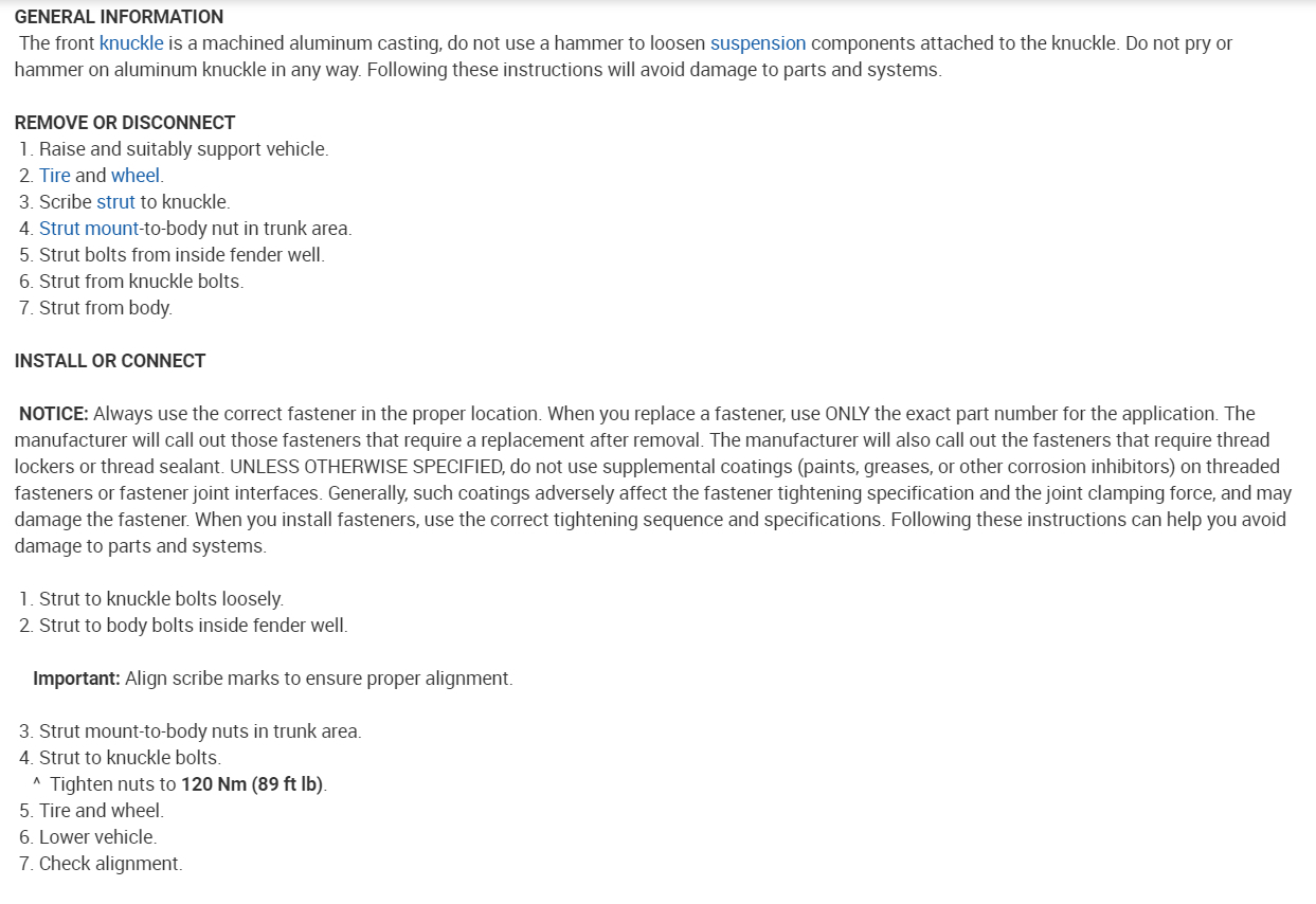

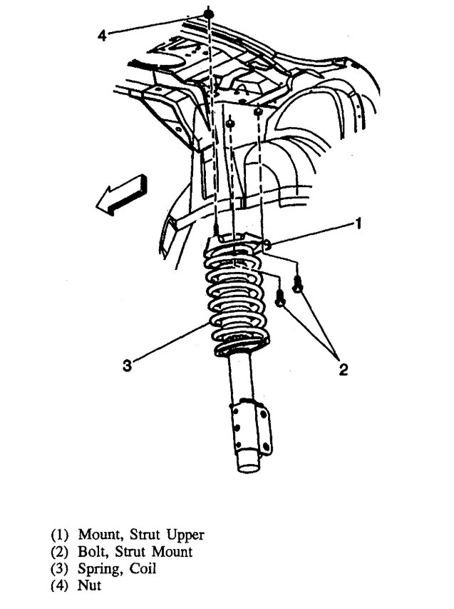

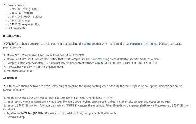

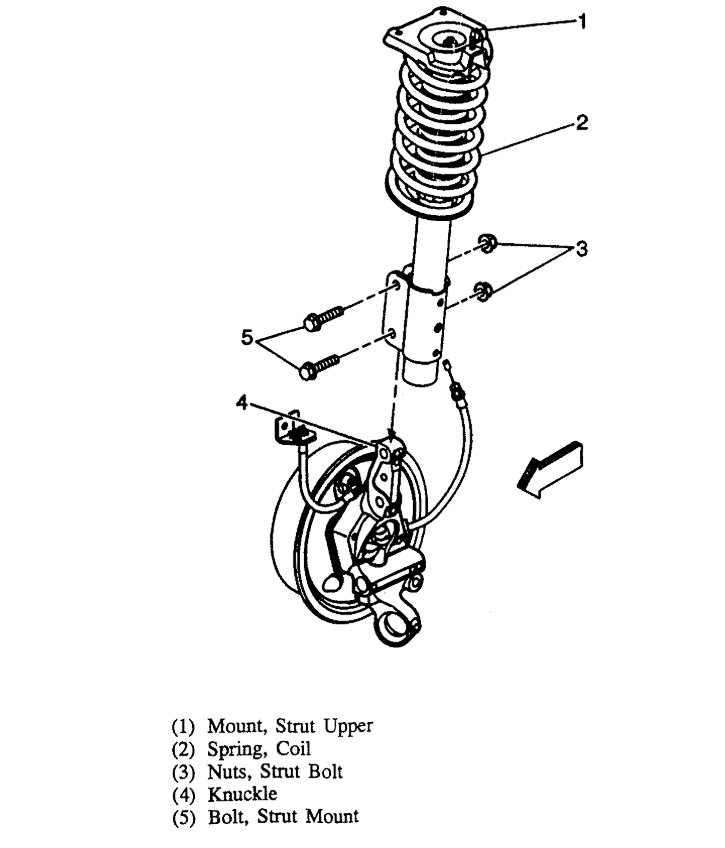

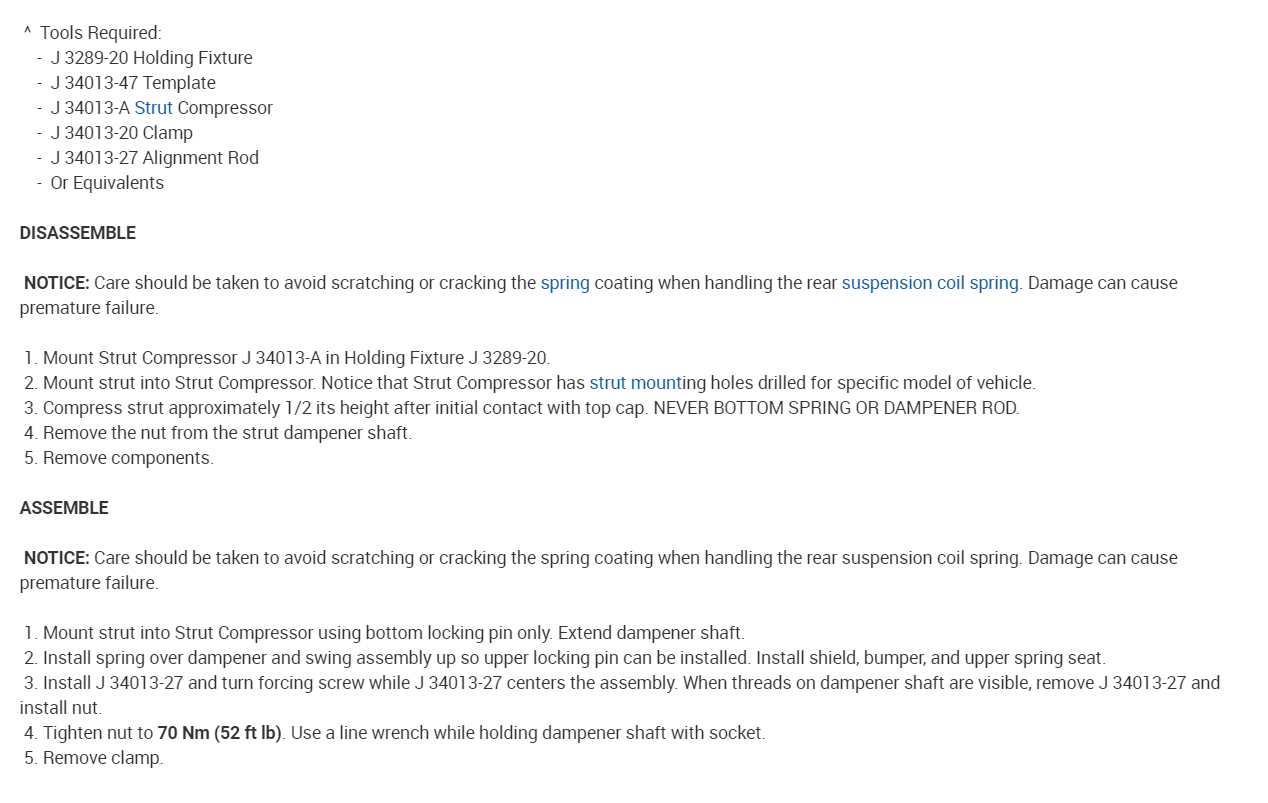

They do not offer fully loaded struts for the rear of this car. you will need to separate this coil from the strut your self. here is how in the diagrams below. Check out the diagrams (below). Please let us know if you need anything else to get the problem fixed.
