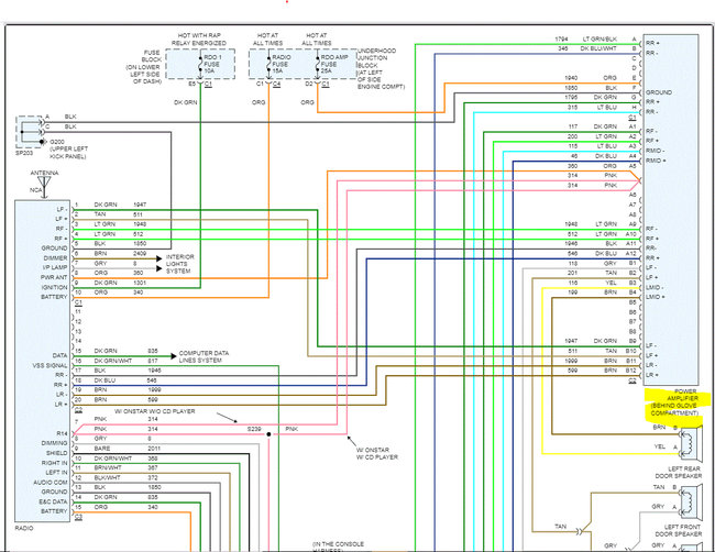

I have verified the sub work (9-volt battery across the feed and return). I pulled the amp out from behind the glove box. It does not have any burnt components inside. The RAP works good as far as the headphones and such. It is a non Bose system. I am unable to find a good diagram of my setup it chases wires. don't want to go out and buy a new amp if that is not the problem. Ideas??

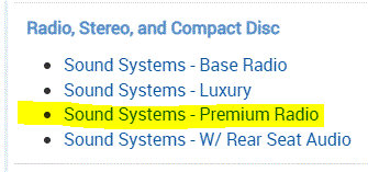

I'm not sure which system you have. If you look at pic 1 below, it shows the possible options. I selected the luxury system because I know it has a power amp and sub.

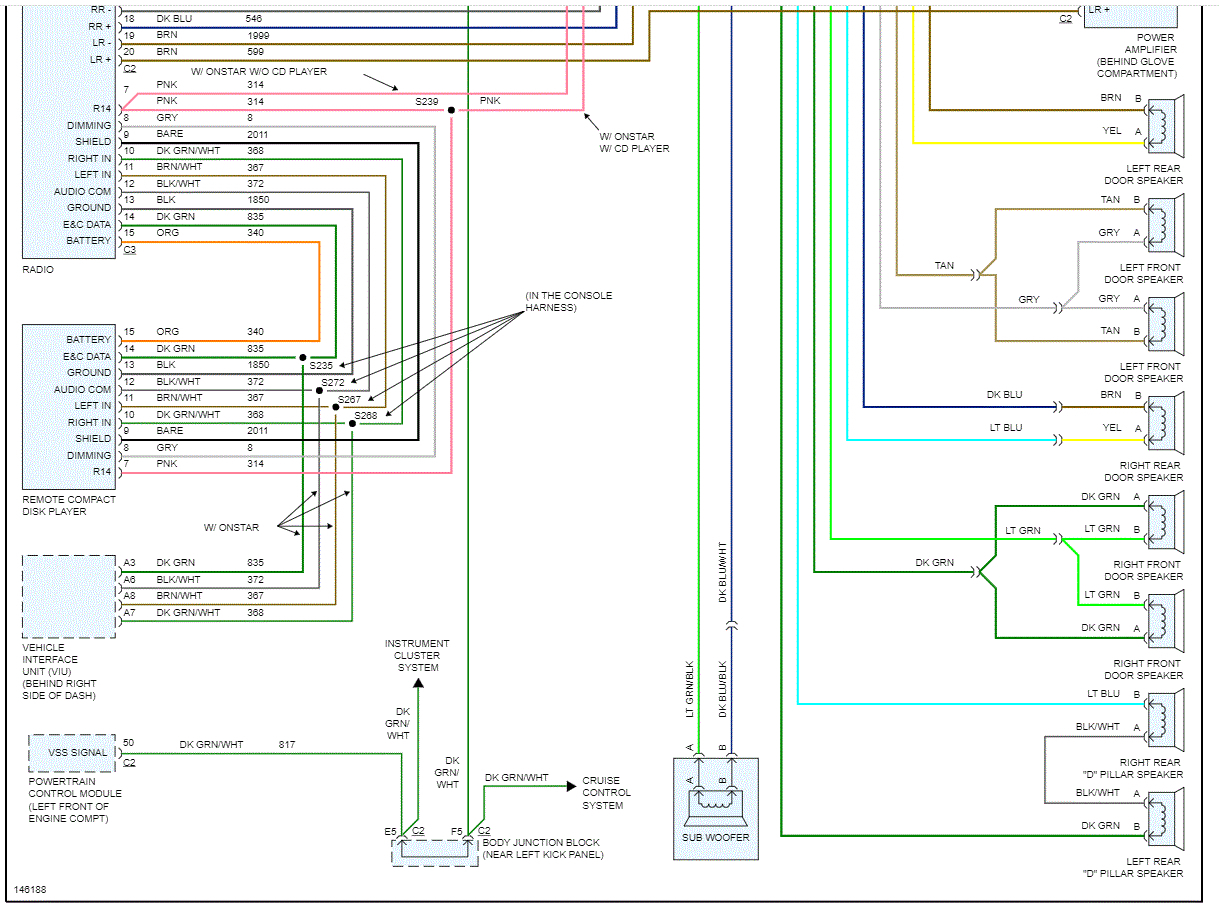

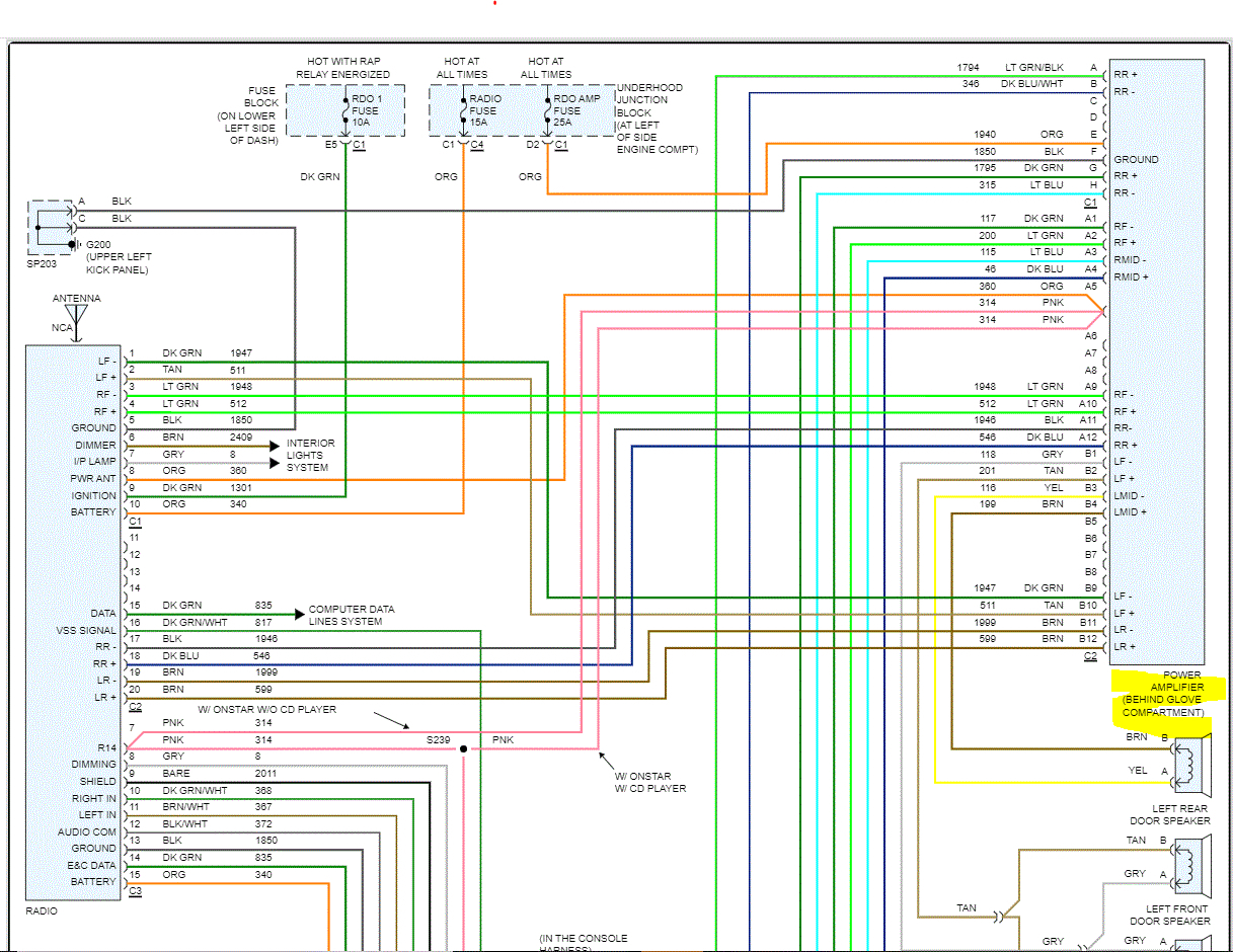

For that system, I included the wiring schematic. If that isn't the correct one, let me know and I'll get you different ones.
See pics. Note: I had to cut the schematic in half to make it readable for you. I did overlap them so you can follow from one to the next.
