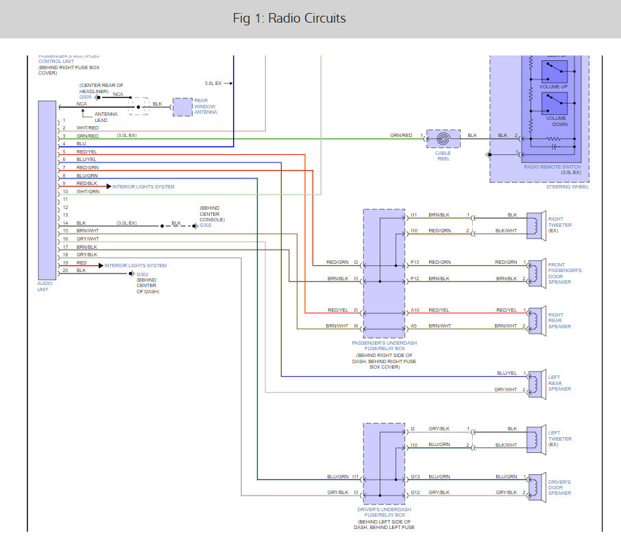

So, my rear speakers aren't working, and they're plugged, and the speakers are new. So, I was wondering if there was maybe a crossover in between the deck and the rear speakers that comes stock with the car listed above. Could you please help? thank you

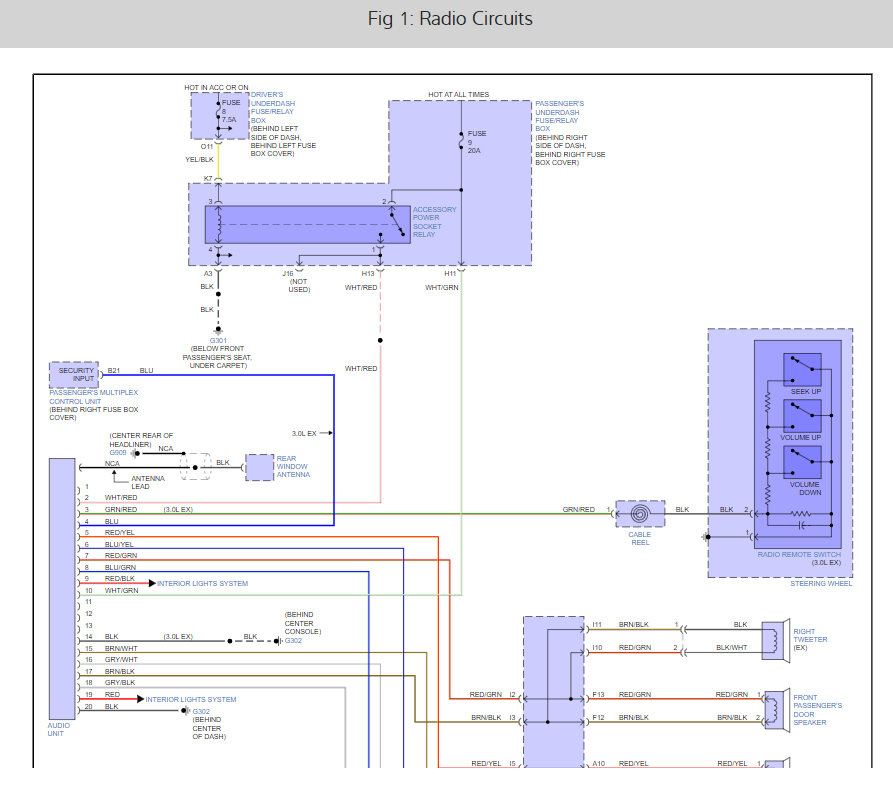

I would check the balance setting on the radio first, and here are the wiring diagrams to make sure you have the speaker wired correctly. Check out the images (below). Please let us know what happens.
