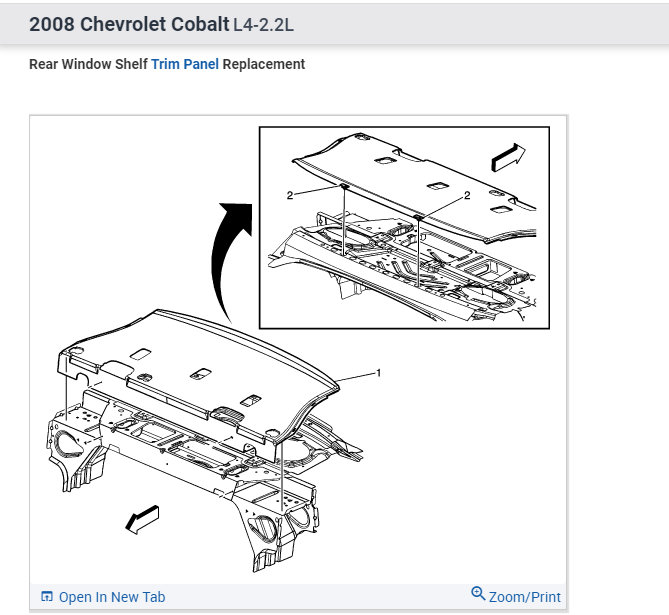

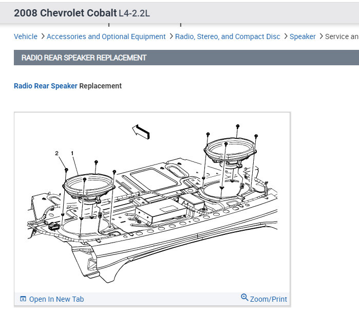

What do I need to remove in order to get to the rear speakers?

To replace the rear speakers, the shelf trim needs to be removed first. Once it is off, you will have access to the speakers and bolts holding them. Pics 1 and 2.

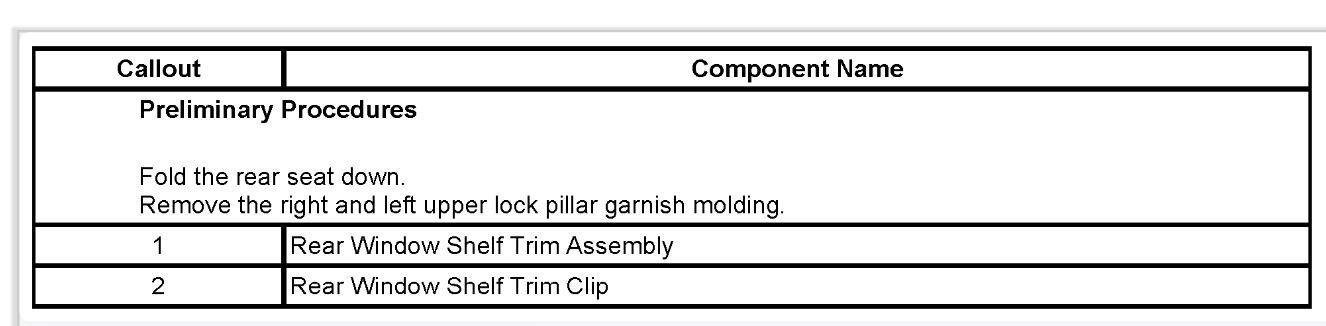

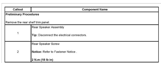

Pics 3 and 4 are the directions to remove and replace the rear shelf panel.

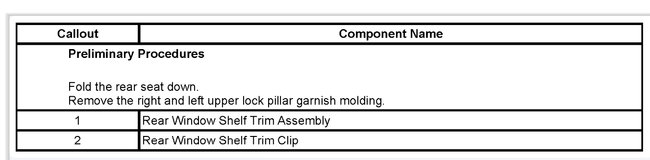

See pic below.
