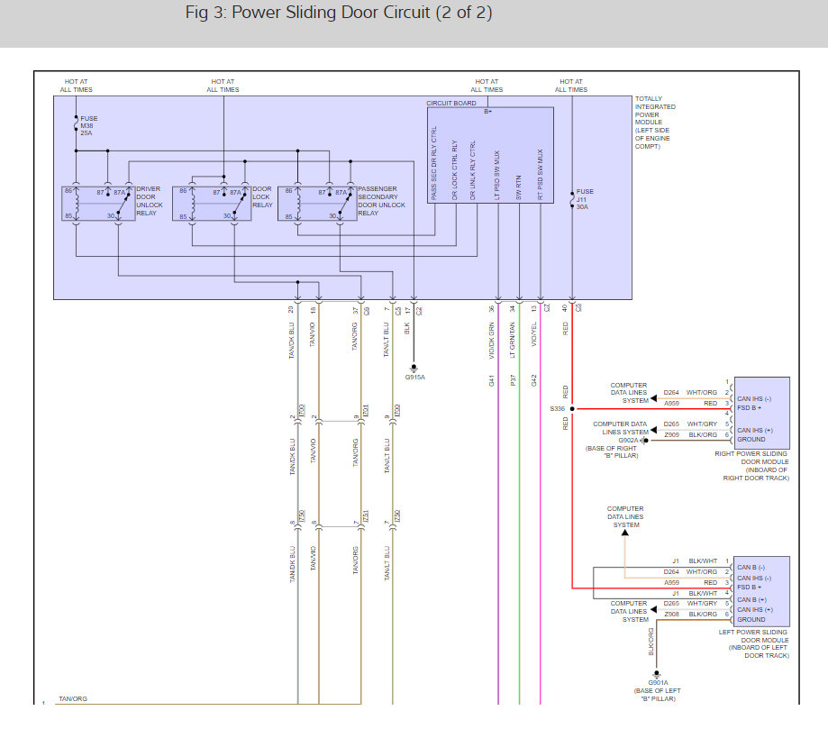

Cannot unlock or open the passenger rear sliding door manually or electronically, believe it may be the lock actuator. How do you get the door to unlock to repair?
May 20, 2019 at 2:47 PM
  • 54,837 POSTS

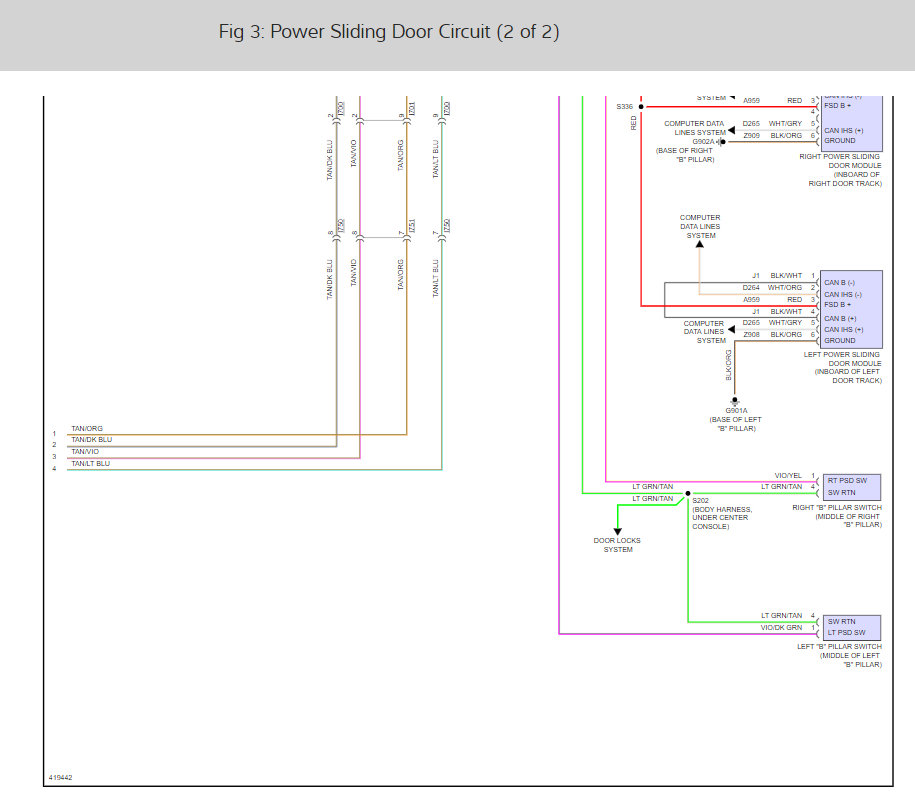

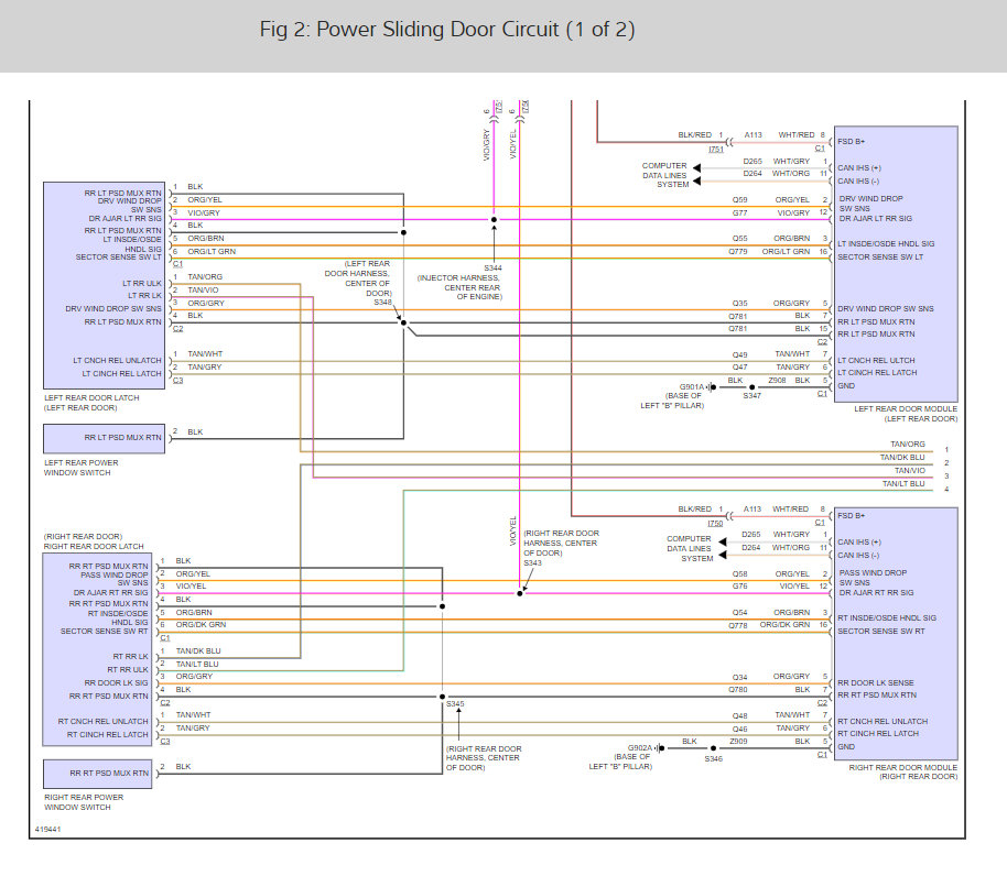

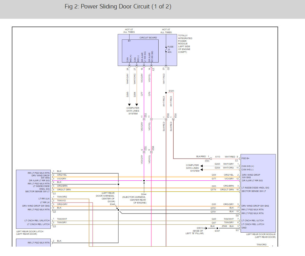

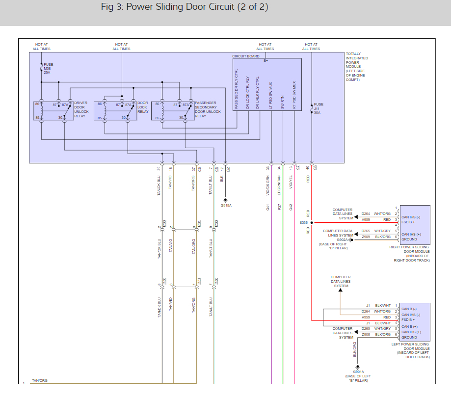

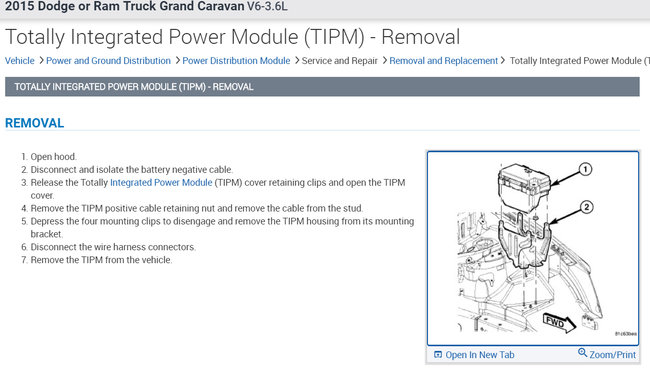

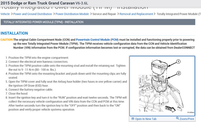

It sounds like the unlock relay stopped working. to be sure here is a guide to help us test the relay and the sliding door wiring diagrams and relay locations so you can see how it works below:
If you cannot find the relay in the TIPM the TIPM will need to be replaced which is easy because it self initializes. Check out the diagrams (below). Please let us know what you find. We are interested to see what it is.
