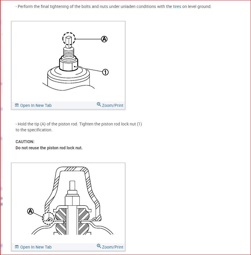

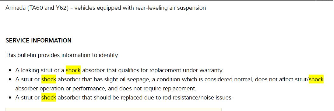

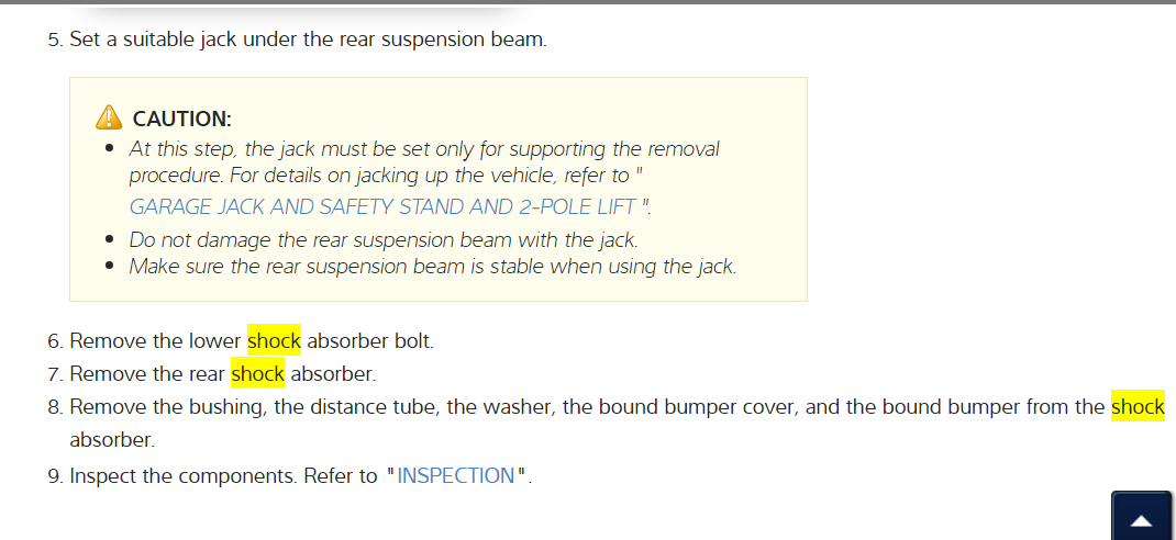

How to replace rear shocks?
May 9, 2019 at 6:21 PM
Hi Alex,
Here are the directions. Let me know if you need anything else. Thanks
May 9, 2019 at 7:08 PM
SCGRANTURISMO
  • 4,897 POSTS

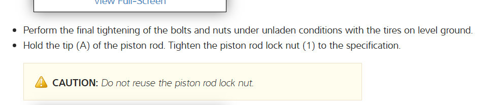

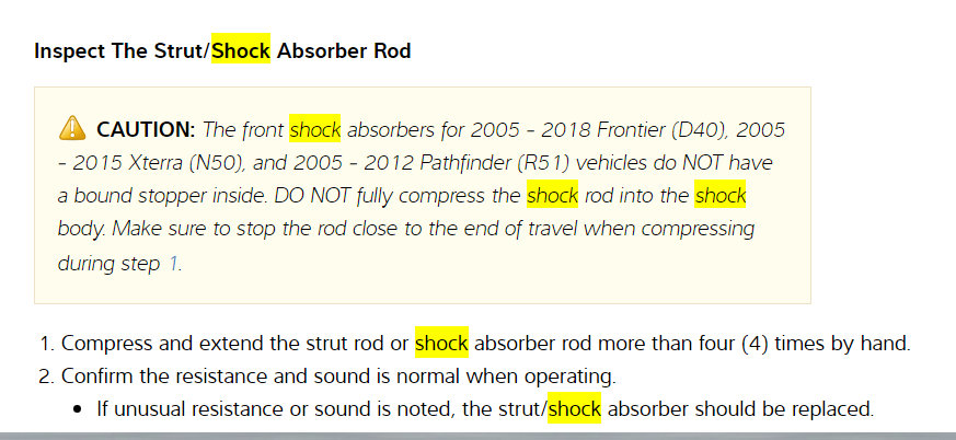

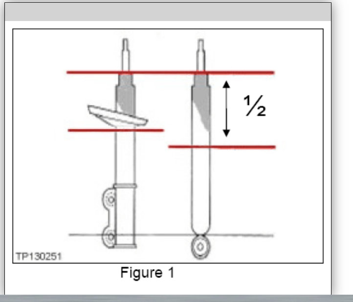

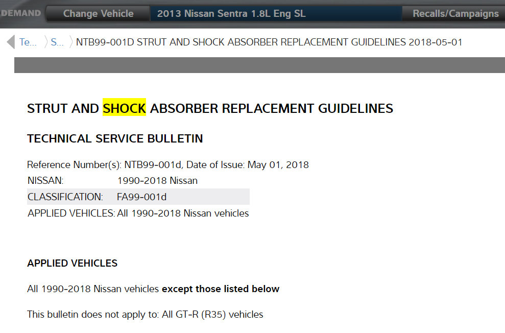

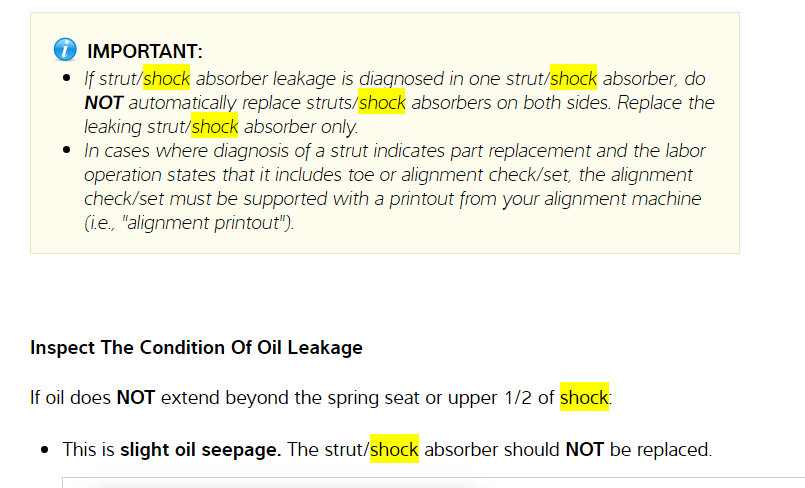

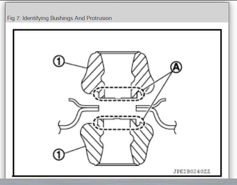

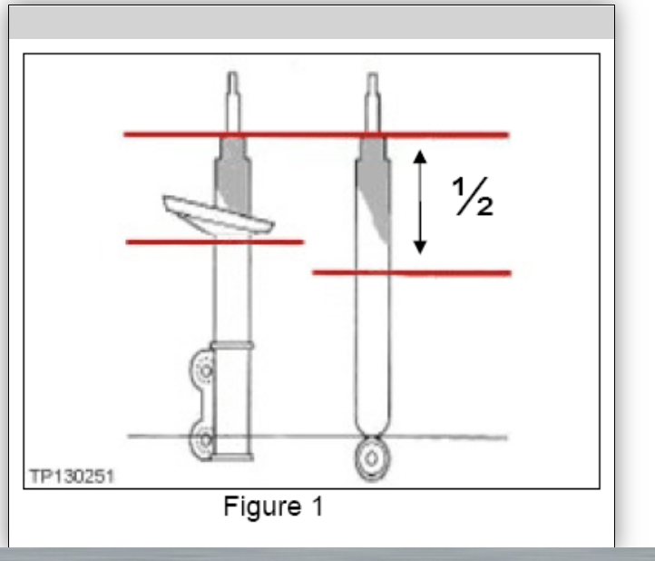

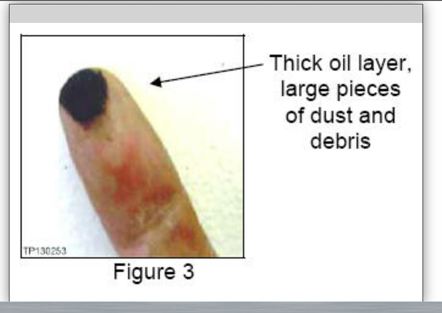

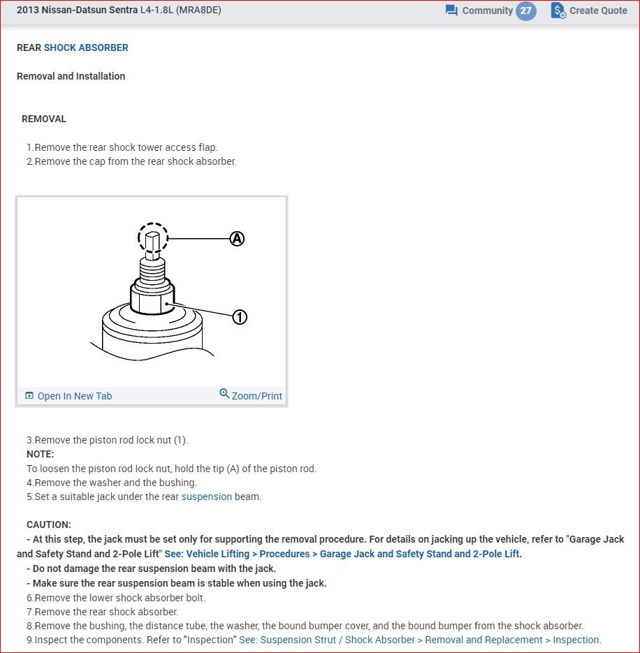

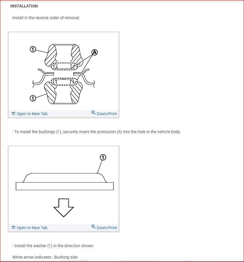

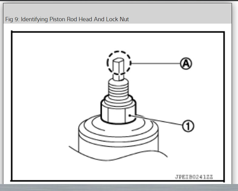

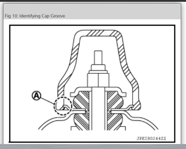

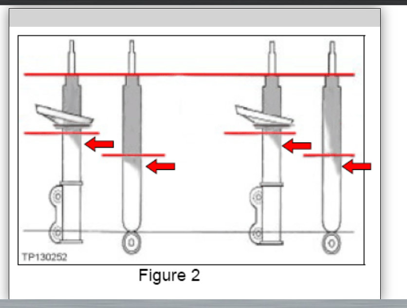

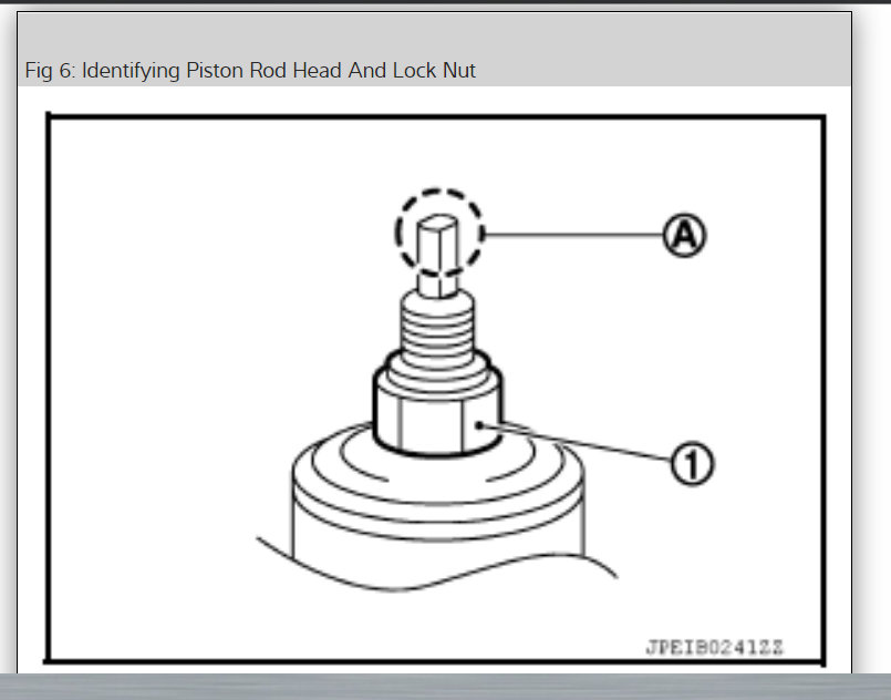

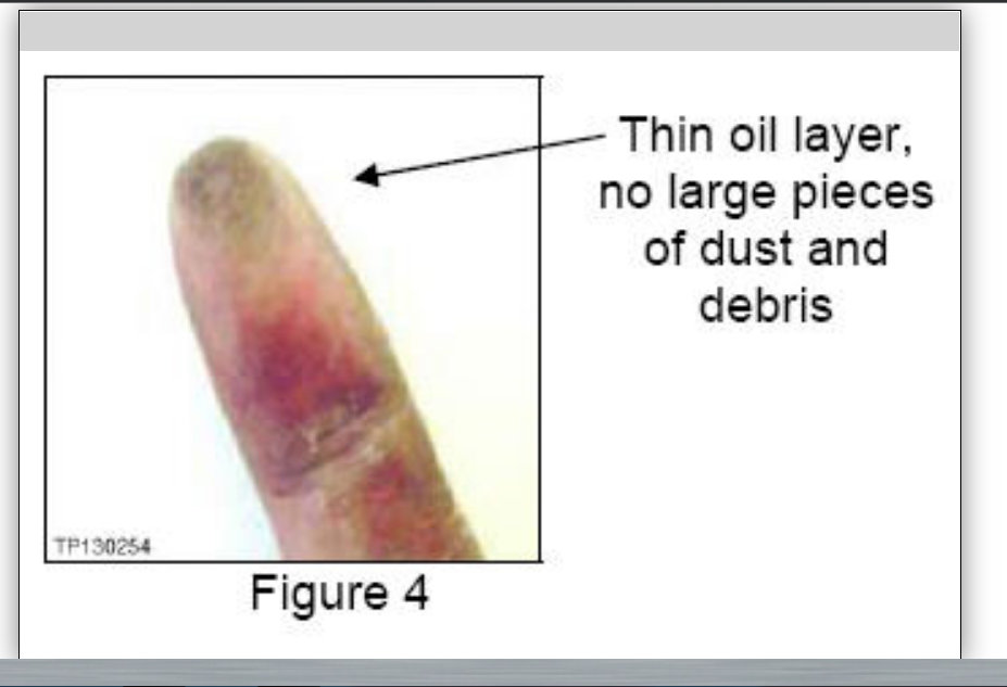

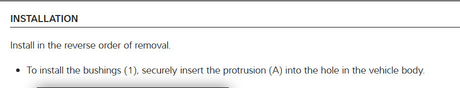

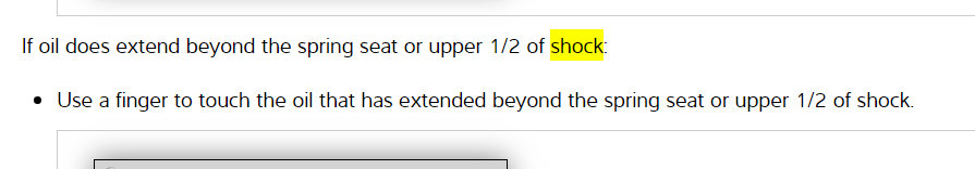

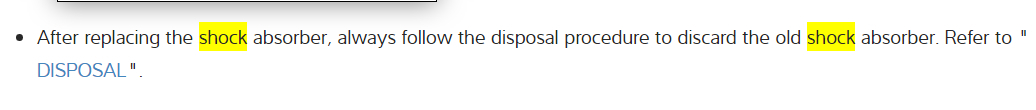

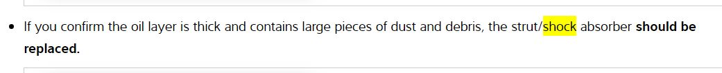

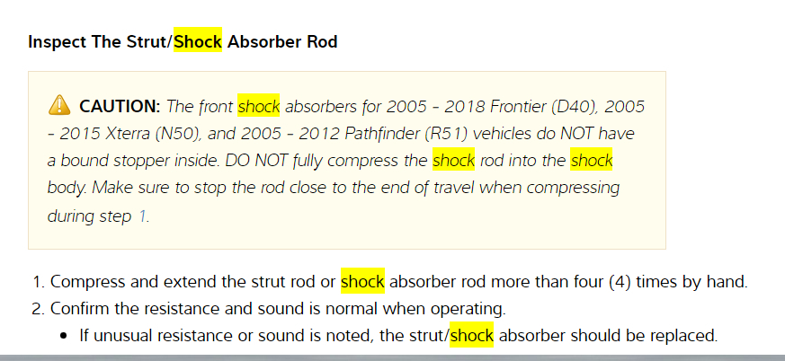

I have included in the diagrams down below a Technical Service Bulletin (TSB) for your vehicle's rear shocks from Nissan, as well as step by step instructions on the removal and installation of your vehicle's rear shocks. I have also included a link below for you to go to:
https://www.2carpros.com/articles/replace-shock-absorber
Please go through these guides and get back to us with what you are able to find out, and how everything turns out.
