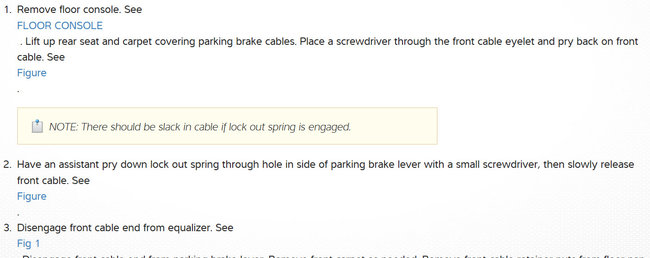

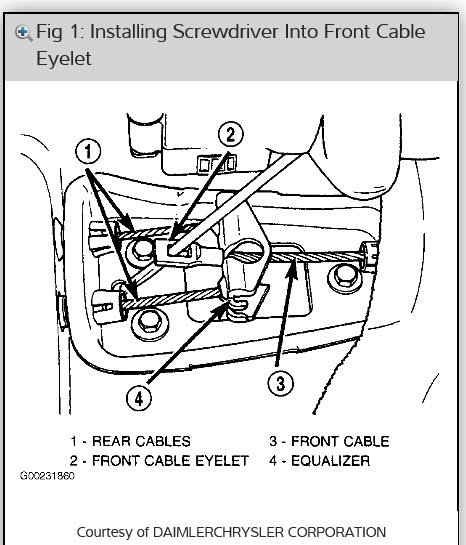

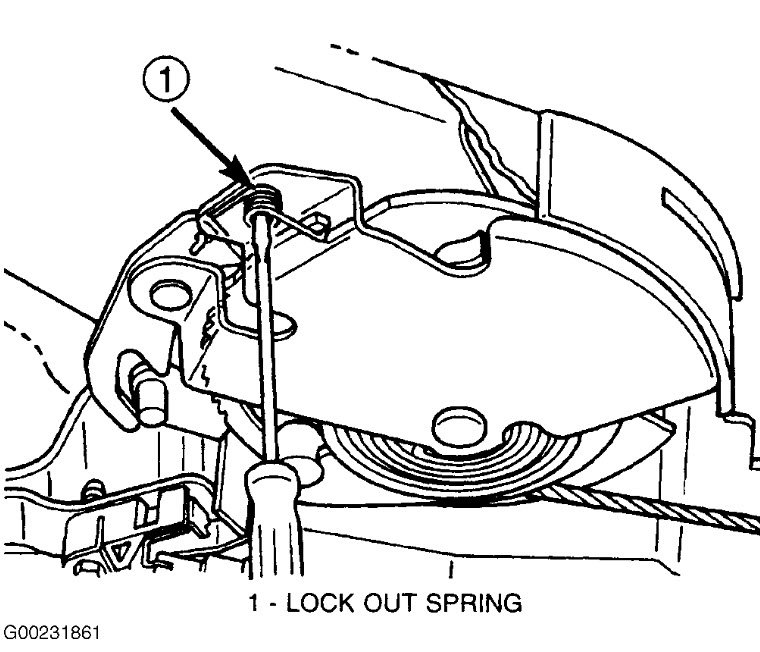

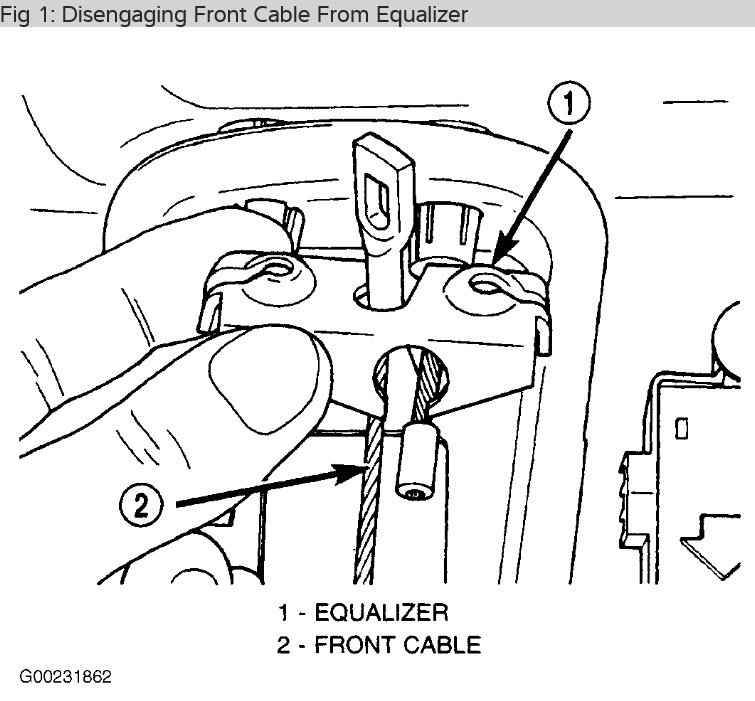

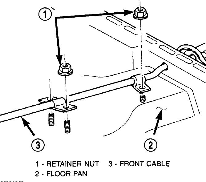

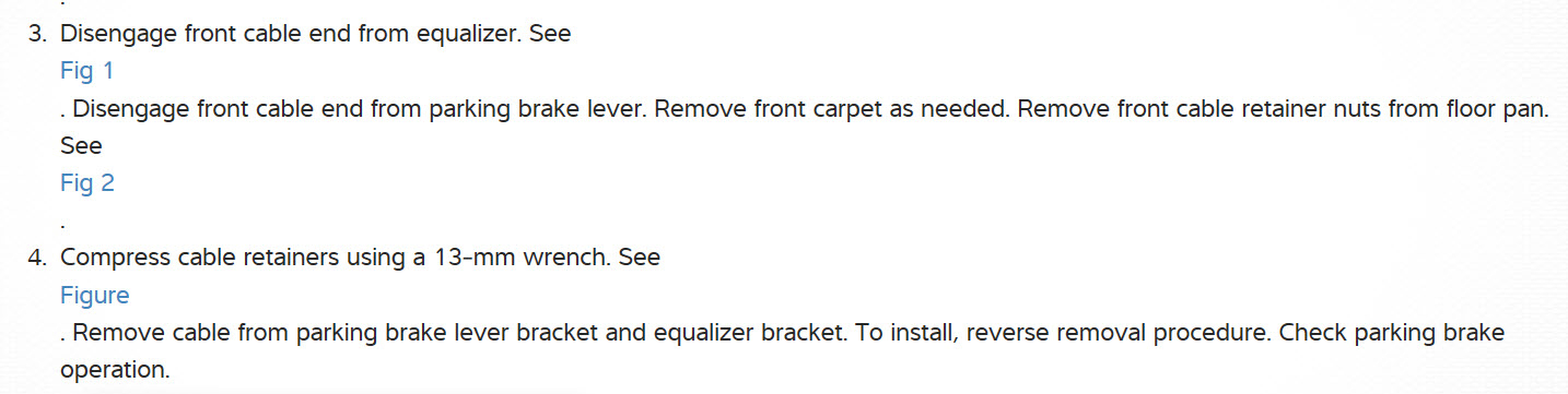

how do I remove my rear seats? so I can get at my emergency brake cables.
Mar 31, 2017 at 9:18 AM
HMAC300
Experienced Mechanic
48,601 POSTS
seats do not need to be removed console does see pics for instructions.
