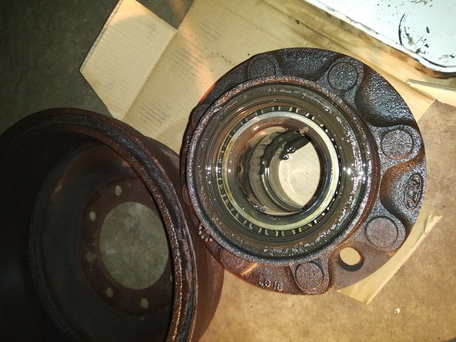

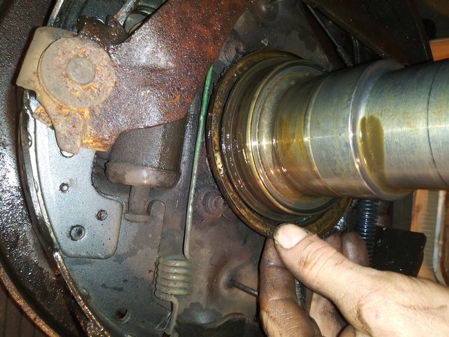

So i converted my truck rear from 3/4 ton to a 1 ton. It started to leak at the wheels. I took of the hub to change the seal and now i am stuck. I did my front seals yesterday that was easy. But now i am lost. I don't know what to do about the metal ring that seems to be stuck on both sides i am guessing. So what am i suppose to replace or how to remove? Don't want to mess anything up. Please help.

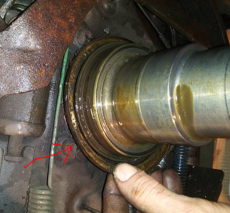

I've re-attached your picture below with a red arrow. What your finger is holding, Is this the seal giving you trouble?Hope this helps and get back to me when you can.Thanks for using 2CarPros.

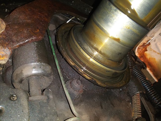

Okay, that ring is behind that other ring around the spindle is that part of it too. Can i just cut the ring that is loose?

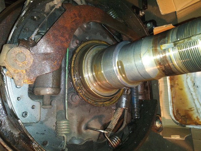

Hello again,
Both those pieces of the bearing/seal need to come off.The part on the shaft is somewhat press fit.You might want to use some type of a puller tool you can rent at an auto parts store for removal.That piece that is stuck is part of the bearing assembly.After removal the seal will just slip off.Hope this helps and feel free to ask any further questions if needed.Thanks again for using 2CarPros.

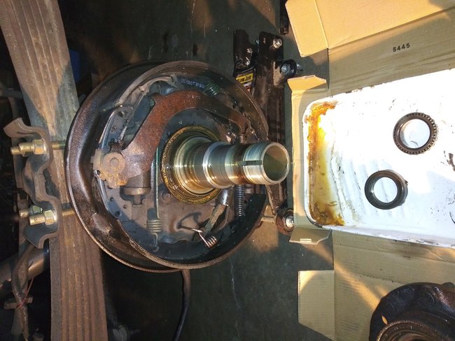

Got it off. There was two pieces on the shaft an one in the hub. Just now got the first one done. Do have a question. I tighten the spindle ring and brought it back 10 clicks the wheel spun better than bringing it back 8 clicks. Should it be easy to spin or a little tough. I reused the bearings they were fine and not burnt. And the rings for the bearings was not pitted or rigged. Sorry don't know the terms for all parts.

Yes, should spin freely but not have any drag.Long as there is no free play.Hope this helps and thanks again for using 2CarPros.

Thanks. looks like i have to bring it back some more it seems like it still has drag. Drag means it feels like it is being slightly held by brakes. Figuratively speaking. Right?

Yep, no drag- freewheel with no play.
