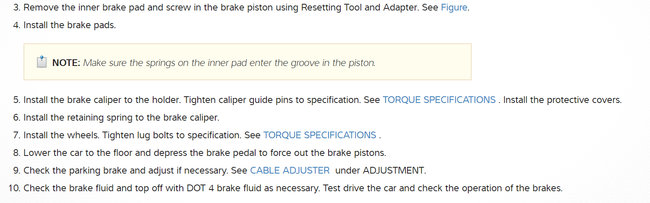

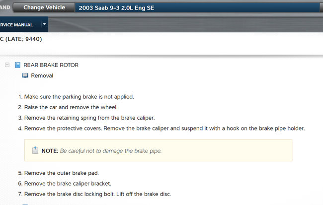

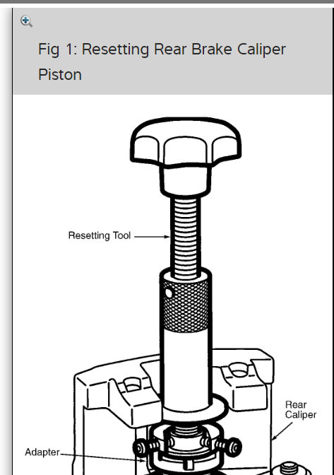

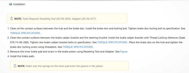

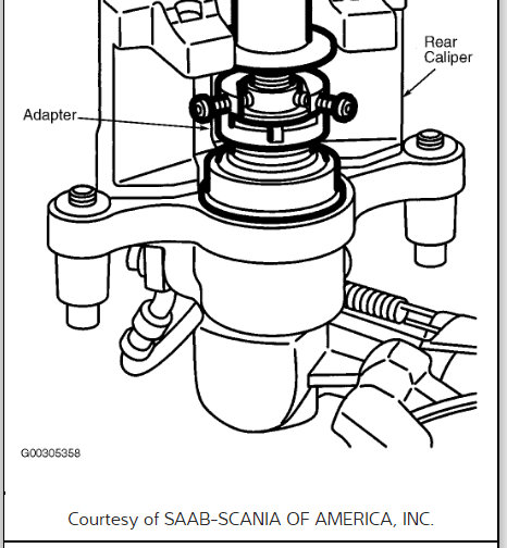

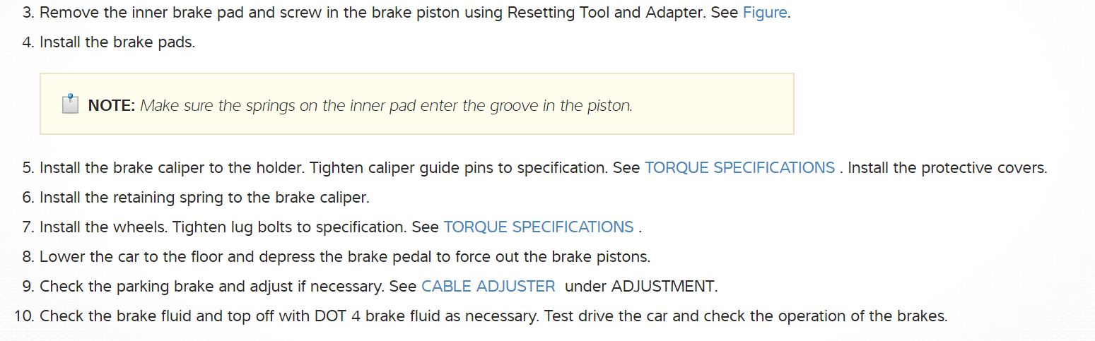

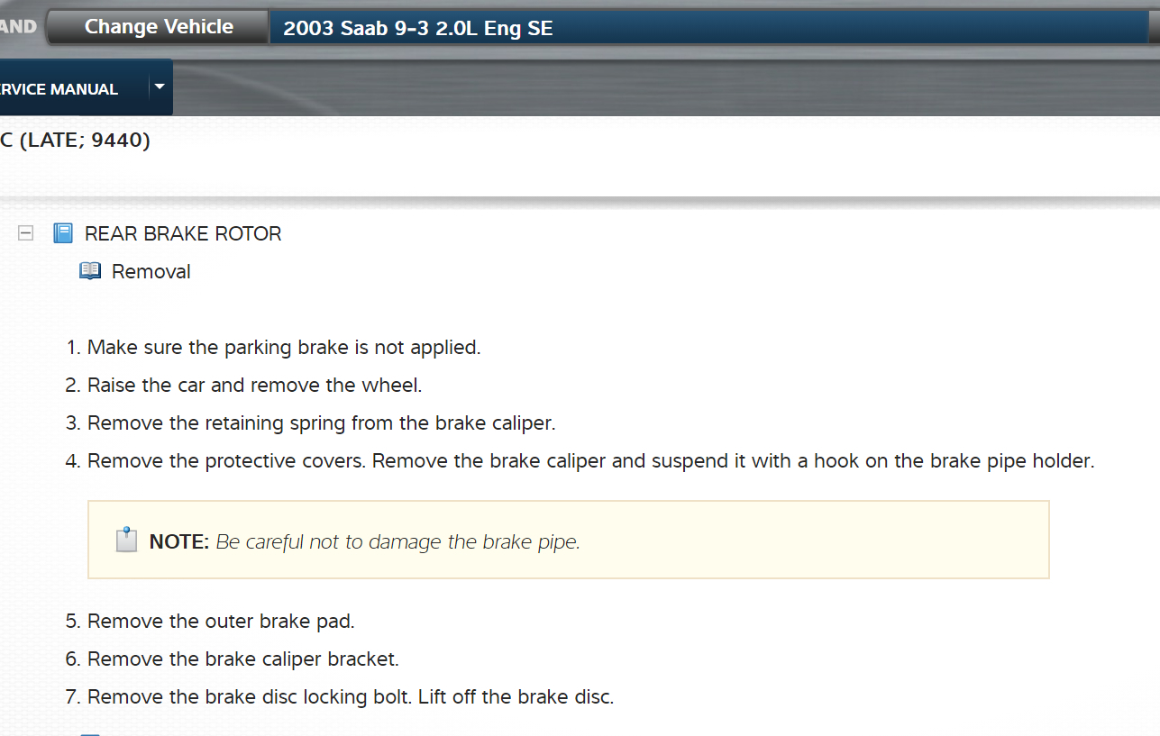

What tools do I need to replace rear rotor?
Mar 16, 2019 at 11:25 PM
SCGRANTURISMO
  • 4,897 POSTS
I have included the information that you requested in the diagrams down below. Please let us know if there is anything else we can do to help.
Thanks,
Alex
2CarPros
Mar 17, 2019 at 2:00 AM
EKTHUNDER
Thanks, I know I need E20 to take off caliper bracket. To take off caliper it self is there any kind of torx socket I need?
Mar 17, 2019 at 2:32 AM
SCGRANTURISMO
  • 4,897 POSTS
Hello again,
No. I have never worked on a Saab, but I have taken many rotors of a variety of vehicles and it has always been easy and straight forward, The best advise I could give you is to have a bungee cord handy so you can use it to suspend the brake caliper from it. If not the caliper will be hanging from the brake line.
