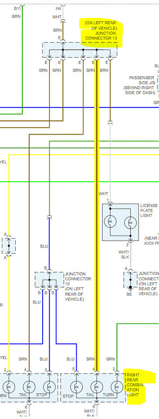

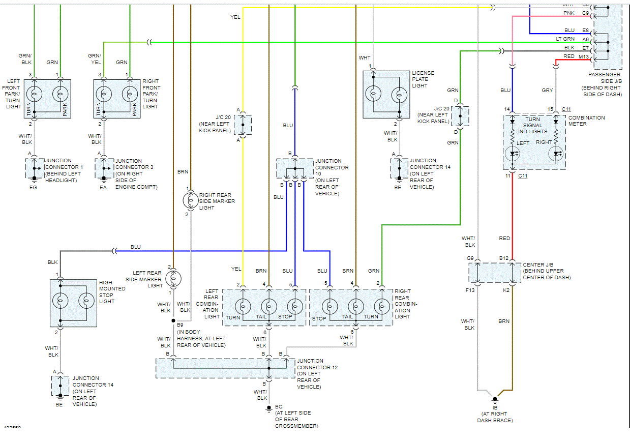

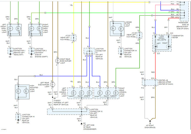

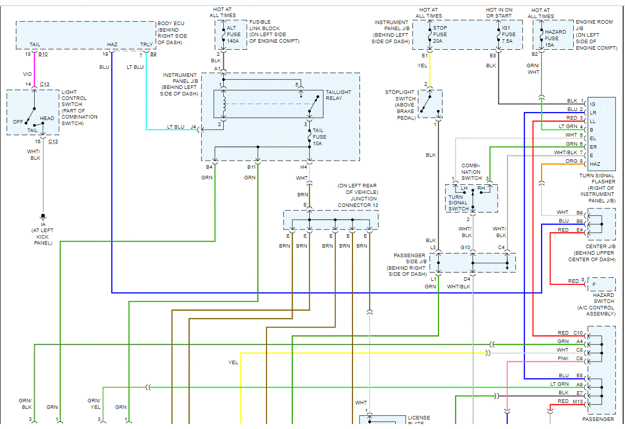

Hello, with the switch at parking all the lights will come on except the right rear light. With the brake pedal pressed the light will come on. I have test for voltage at the terminals I could not find any.
Please could you help me the circuit diagram and what could be the fault?
May 4, 2021 at 4:28 PM
  • 110,194 POSTS
I would be happy to provide the schematic. If you look at the first two pics below, they include the entire schematic for exterior lighting. I had to cut the pic in half to make them readable. I did overlap them.
If you look at pic 3, I highlighted the right rear light, wire to it, and a junction connector (which I suspect is where the problem is) on the left rear.

Good morning sir, it was a partial contact on at the connector, now it is functioning. Thank you sir.
