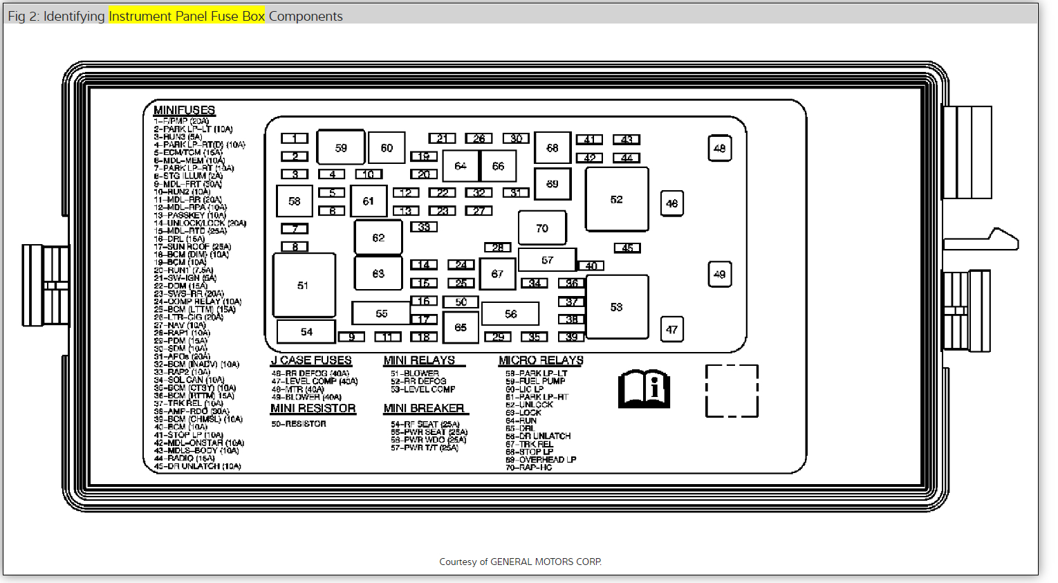

Thanks, I have a 2008 Buick Lucerne V-6 3.8L. The lighter plugs won't work. The one in the dash and the one under the arm rest, center console. The first place I started was the fuses. I looked in the manual, in the fuse box and on-line and have not been able to identify which fuse operates the lighter plugs. Could you let me know?
Thanks,
Tom
Jul 28, 2021 at 7:34 AM (Merged)
CLY
  • 308 POSTS
Check in the fuse box under the rear seat. make sure to check fuse # 31 and 26. Both are 20 amp fuses
Here is a guide that can help with the fuse panels in the diagrams below.
