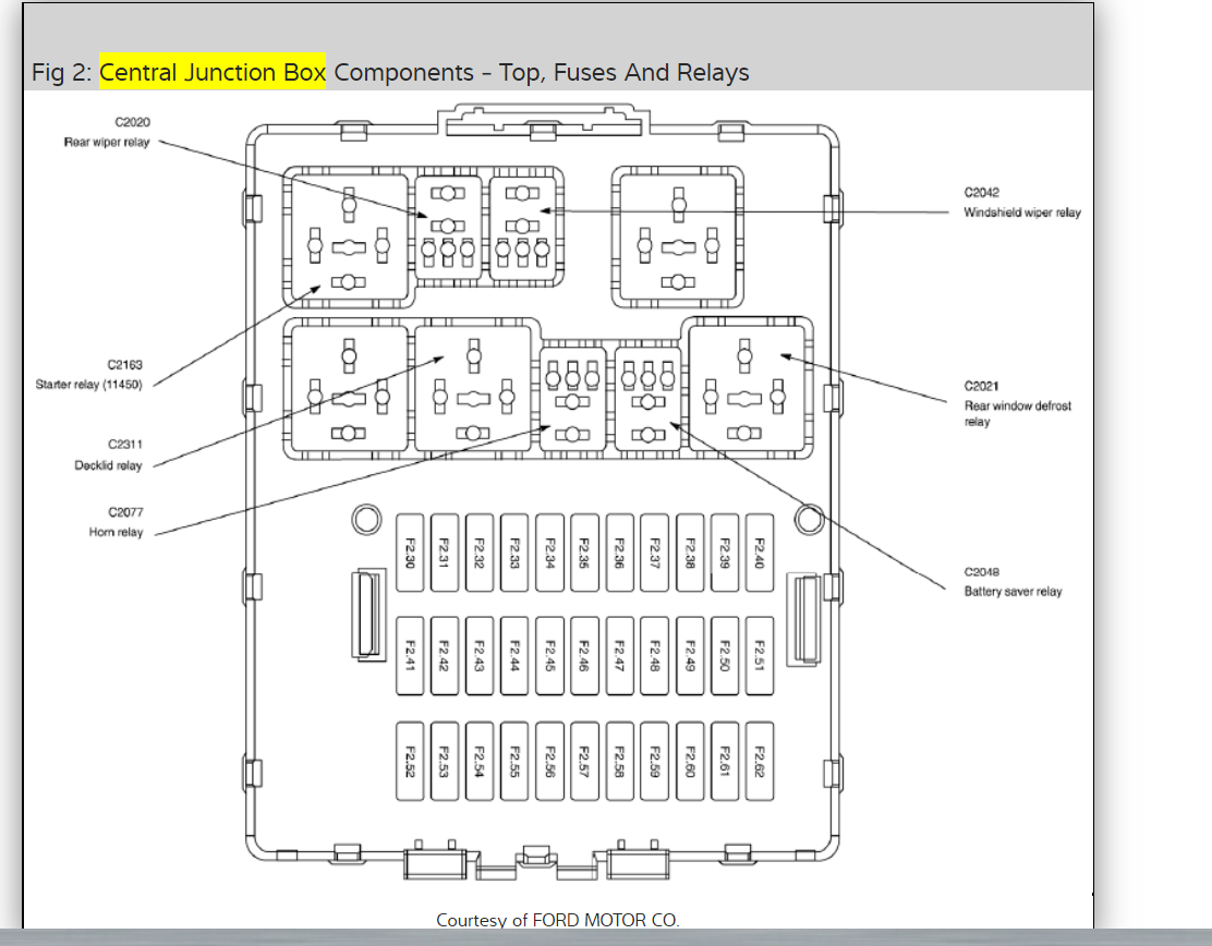

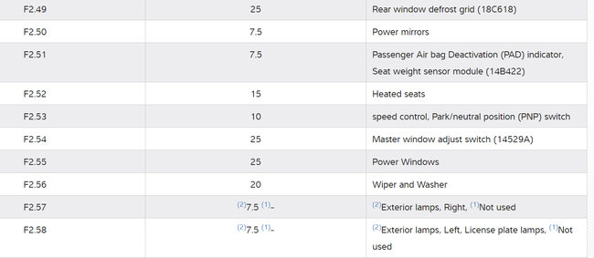

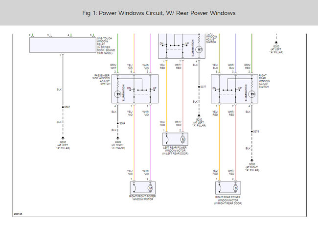

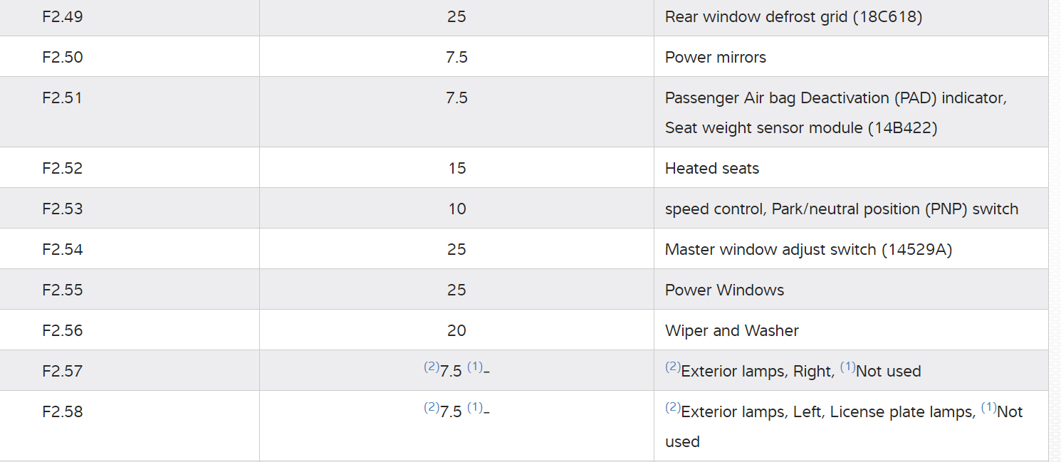

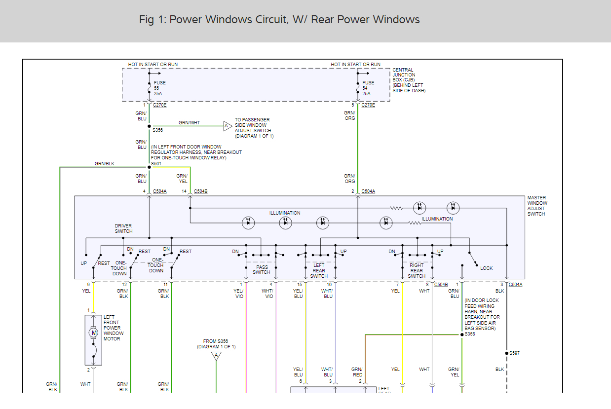

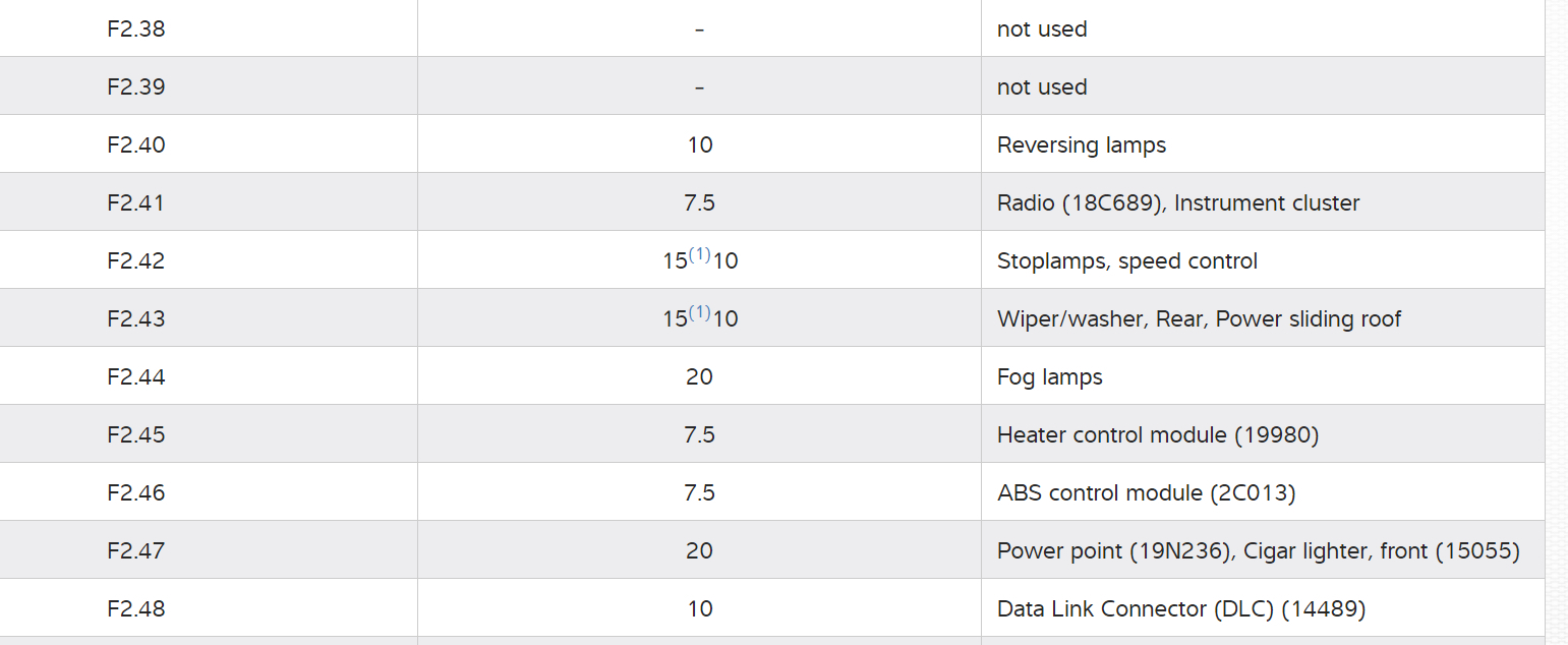

The rear power windows have stopped working on my 2005 zx5. The front windows operate normally. I have checked the fuse and made sure the child lock switch is in the correct position. There is no clicking sound when I operate the switch.

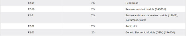

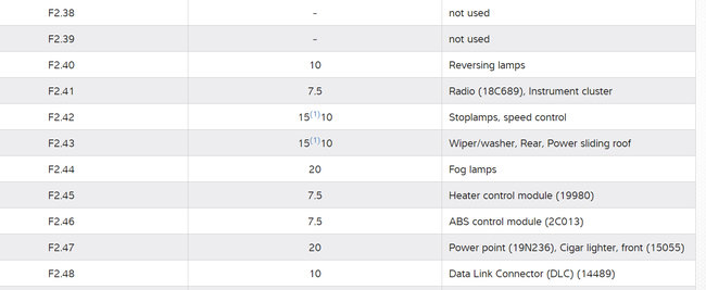

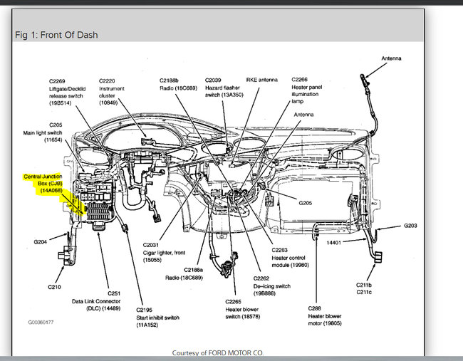

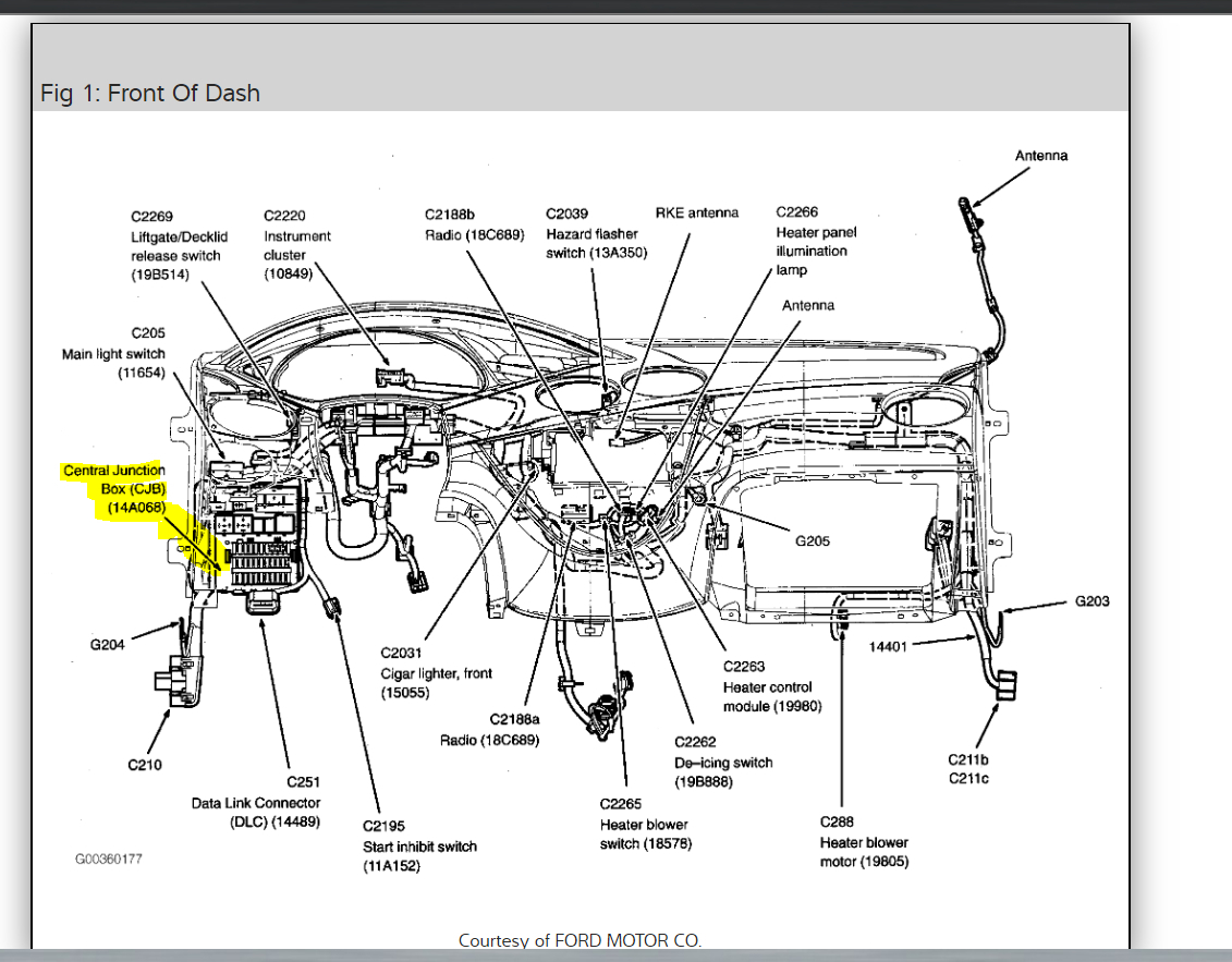

Just to make sure could you please double check Fuse #54 in the Central Junction Box, located under the left side of your vehicle's dashboard. In the diagrams down below I have included a wiring diagram of your vehicle's power window circuits, and the location, diagram, and callout for the Central Junction Box. Here is a link, also, for you to go to as well:
Please go through these guides below and get back to us with what you are able to figure out.
