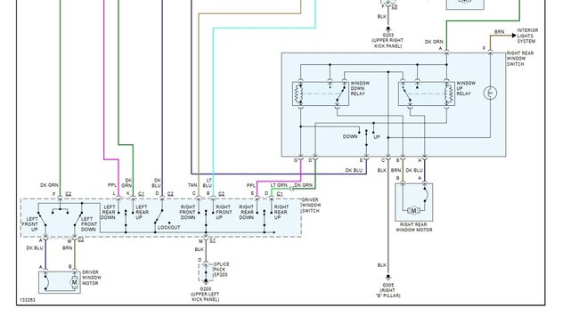

I just need the wiring diagram for the window switches on my vehicle listed above please. Mostly just the rear passenger window switch, but anything helps. thank you.

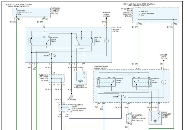

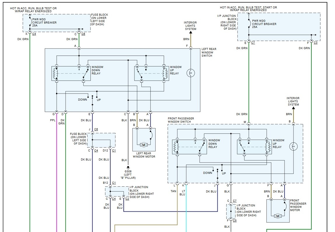

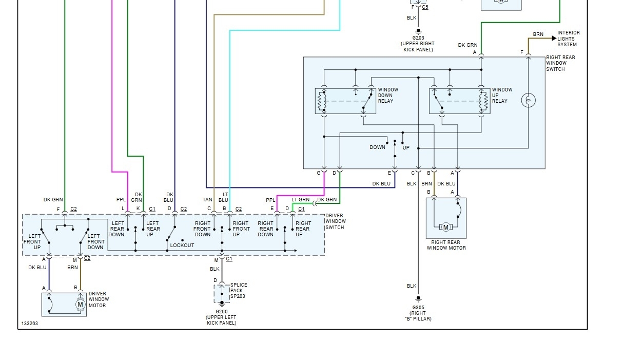

Attached is the full diagram for the front and rear switches. The rear units on those are unique because of the relays used to control the motor instead of a simple switch. What is the issue you are having?
