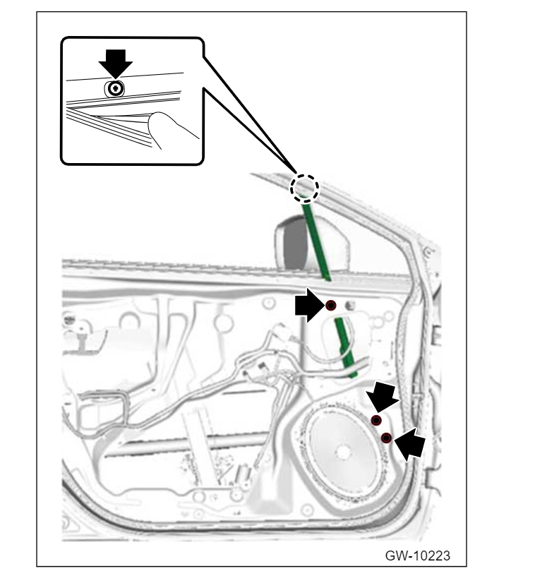

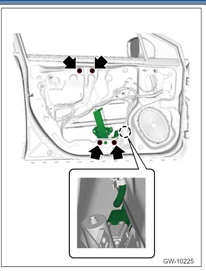

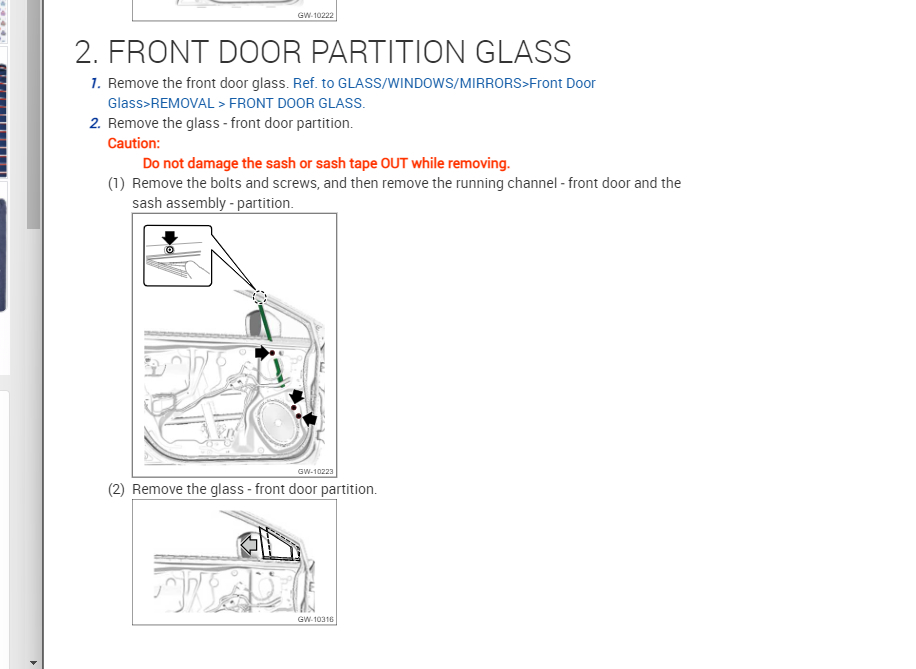

Looks that the scissor lift possibly bent. Or that it is missing a part. The window does not stay against the scissors. I need to see if it should be bound to the lift or not.
Apr 23, 2022 at 7:21 AM
If the window will not stay against the regulator, then you are correct that the regulator may be bent.
Here is a guide that will help with replacing this if needed:
https://www.2carpros.com/articles/how-to-check-and-replace-a-electric-power-window-motor

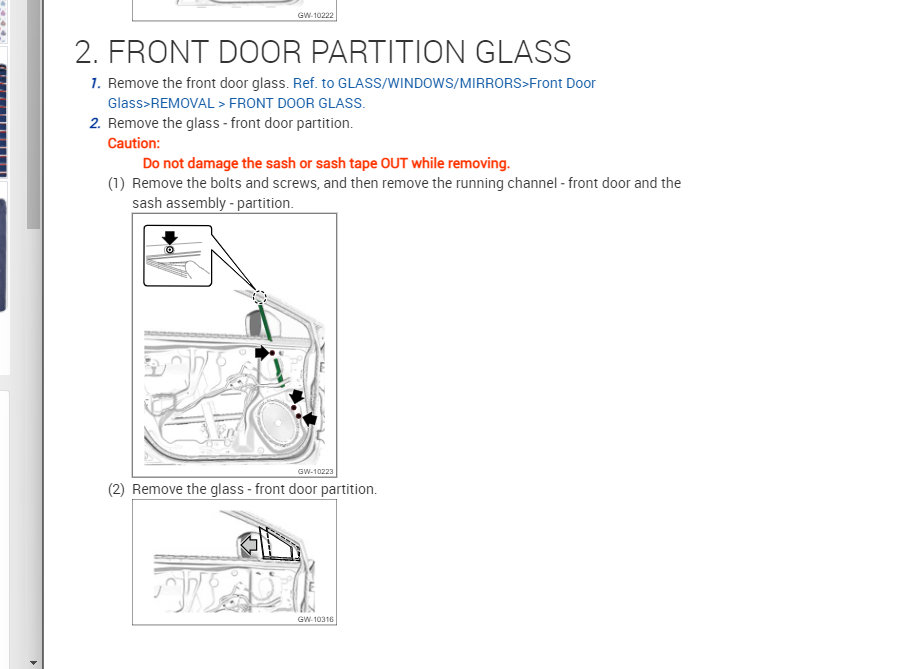

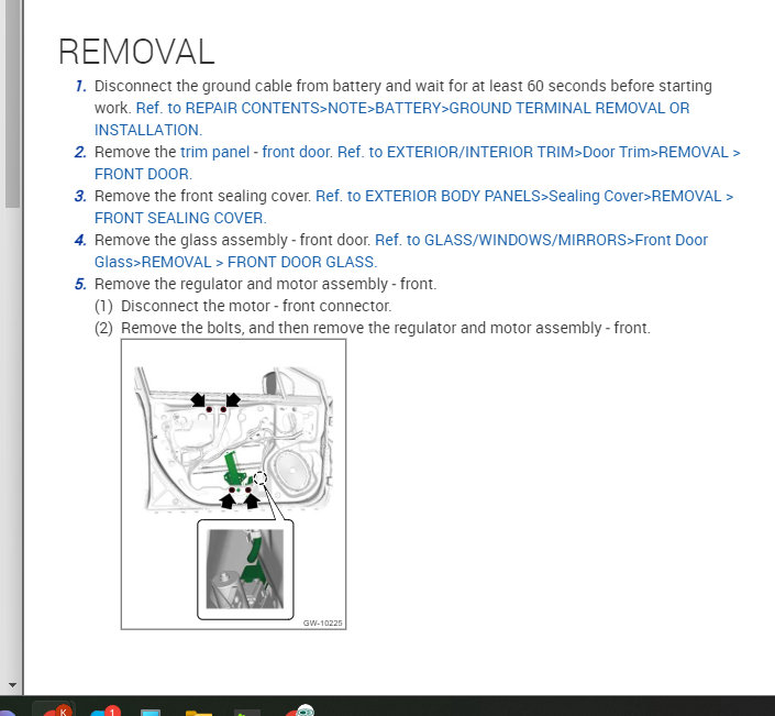

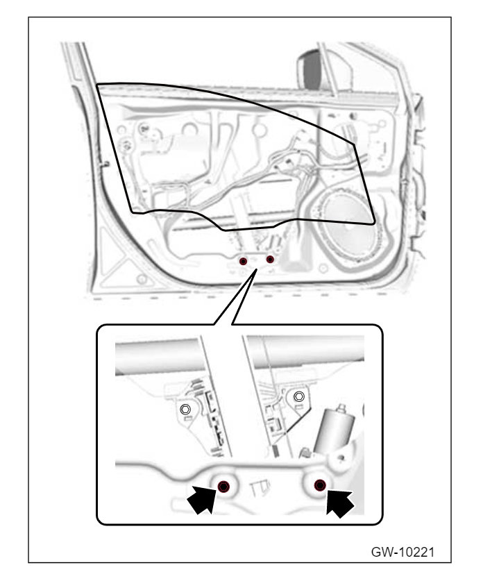

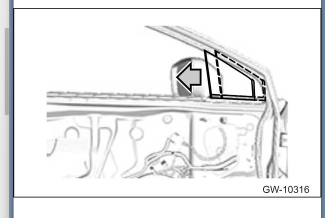

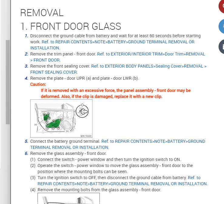

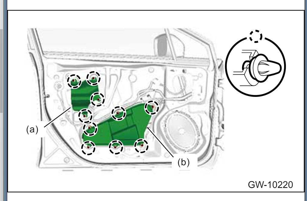

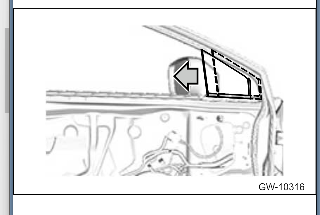

The window is held to the regulator by two bolts at the bottom of the glass, so I am attaching all the info that we need in order to figure this out.
Please run through this info and let me know what questions you have.
