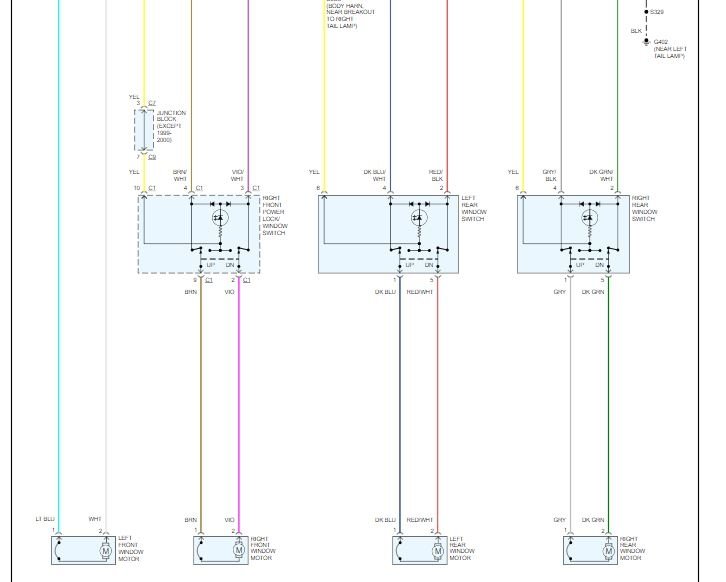

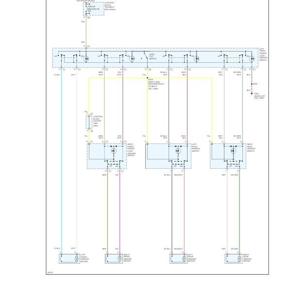

Passenger rear window won’t go down. just replace the driver side regulator and motor. The rest of the windows work except the passenger rear window.
Mar 25, 2019 at 8:22 PM
Good morning,
Did you check the voltage going to the motor? It sounds like the motor is bad but needs to be confirmed.
I attached a wiring diagram for you to view. Check the voltage from the switch to the motor.
