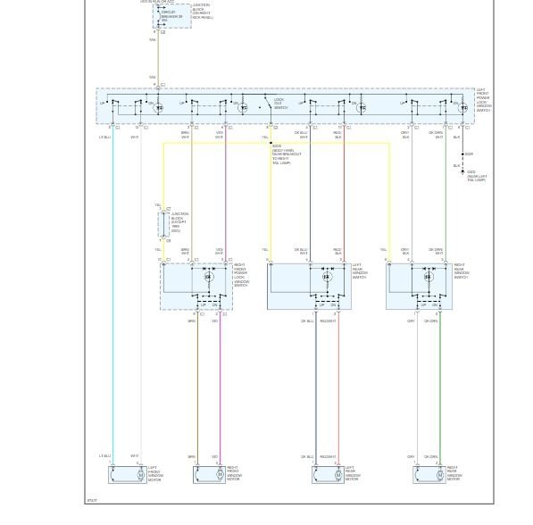

Rear passenger window does not roll down
1999 JEEP GRAND CHEROKEE
279 MILES • 4.7L • V8 • 4WD • AUTOMATIC
STOREY81!
Passenger rear window won’t go down. just replace the driver side regulator and motor. The rest of the windows work except the passenger rear window.

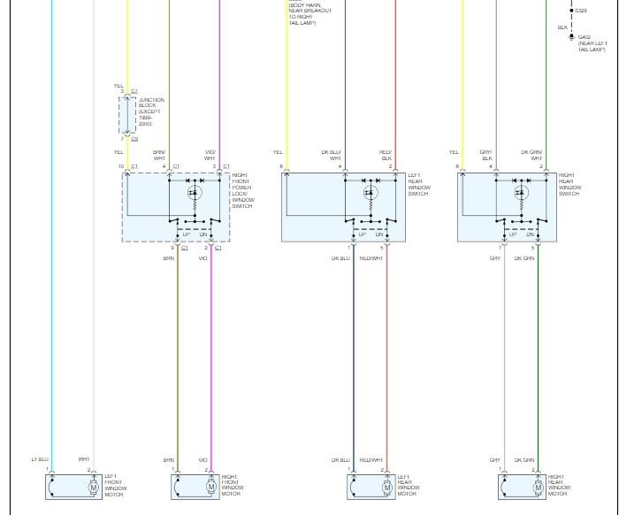

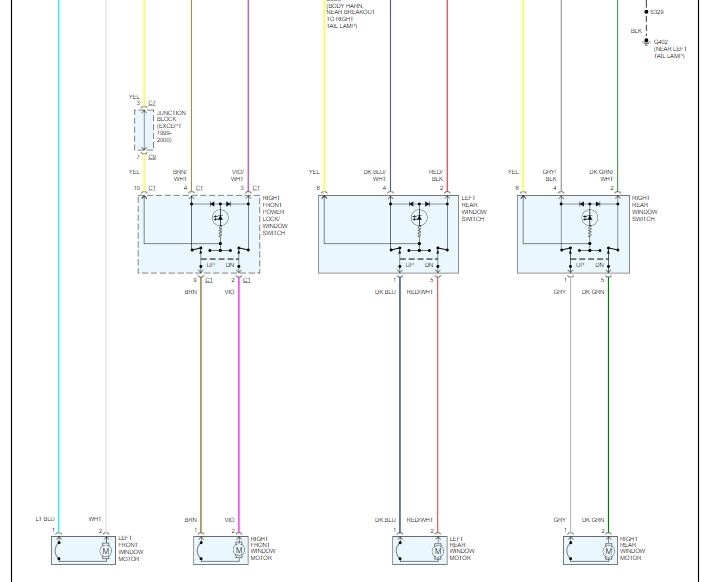

Good morning,
Did you check the voltage going to the motor? It sounds like the motor is bad but needs to be confirmed.
I attached a wiring diagram for you to view. Check the voltage from the switch to the motor.
