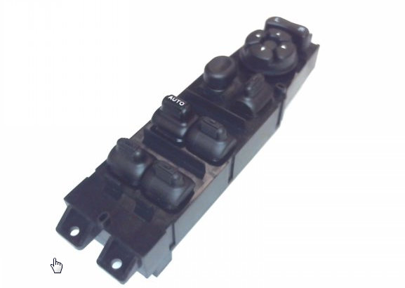

My vehicle listed above (Sport) rear back passenger window will not come up from drivers door switch nor the door switch. How do you replace the rear passenger window switch from the drivers door? Will you have to replace the complete drivers door switch panel or can you just replace one?

Unfortunately the left front is all one switch bank so that will need to be replaced. However, I would just make sure it is not the window motor that has failed before you spend the money on the switch. You do this by jumping 12 volts to the window motor and make sure it moves. If it moves then more than likely it is the switch.
