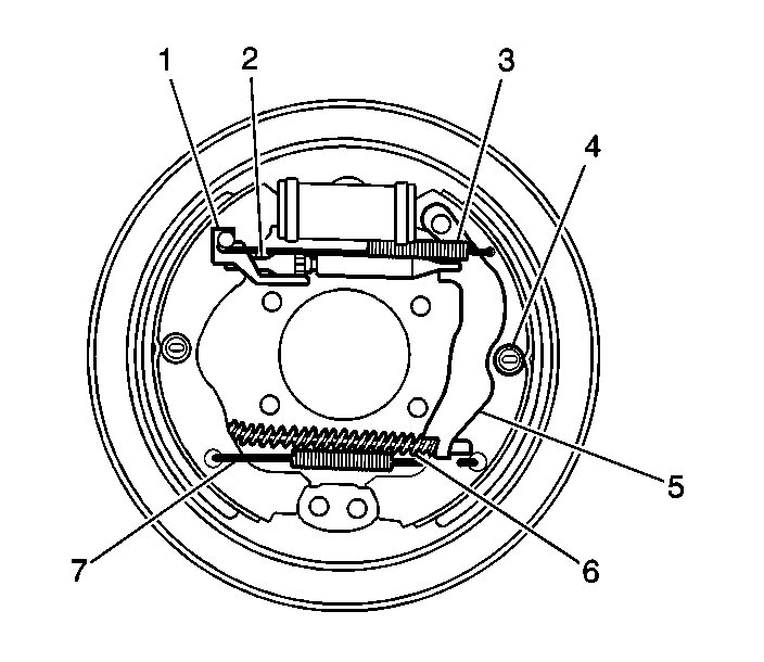

Was changing rear tires, when I went to tighten the lug nuts on the passenger side the wheel spun. When I drive, there is a loud clicking sound and a vibration coming from the rear. Sounds like the wheel is hitting something when it spins.

Hi:
It sounds like the parking brake shoes (which are on the inside of the brake rotor) have come apart or are completely out of adjustment.
Here are the directions for checking the parking brake shoes. The attached pic correlates with the directions.

pic 1

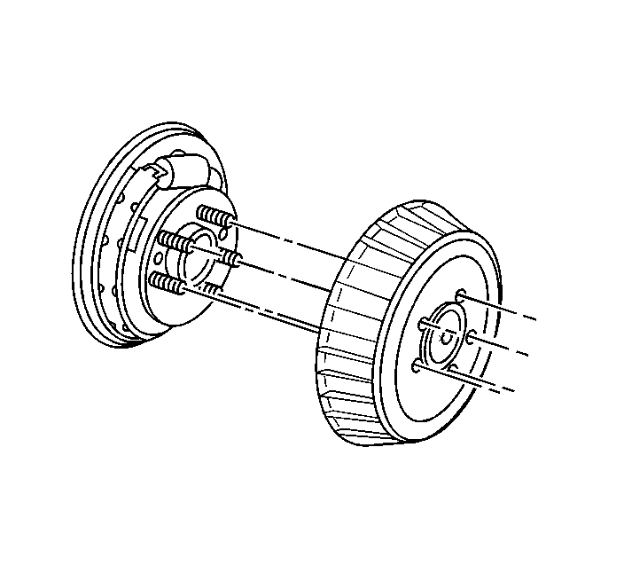

1. Raise and support the vehicle.
pic 2
2. Remove the brake drum.

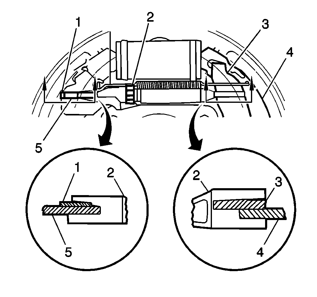

pic 3
3. Notice: Do not over stretch the adjuster spring. Damage can occur if the spring is over stretched.
Disengage the adjuster spring hook end from the tab on the adjuster actuator (1).
4. Remove the straight end of the adjuster spring from the brake shoe.
5. Remove the adjuster actuator from the brake shoe.

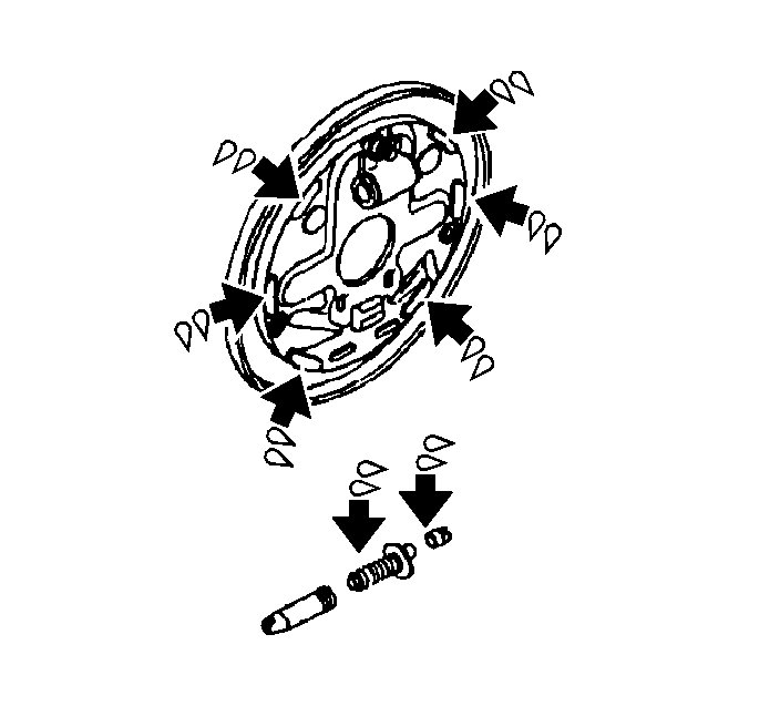

pic 4
6. Remove the return spring (7) from the brake shoes.
7. Remove the park brake cable (6) from the park brake actuator lever (5).
8. Remove the brake shoe hold-down springs and retainers (4) from the brake shoes.
9. Remove the adjuster from the brake shoes and the park brake actuator lever.
10. Remove the horseshoe clip retaining the park brake actuator lever to the brake shoe.
11. Remove the park brake actuator lever and wave washer from the brake shoe.

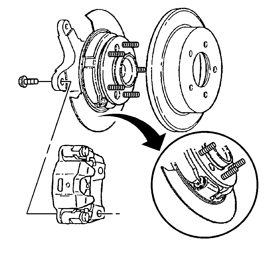

pic 5
1. Apply GM P/N 1052196 brake lubricant (or equivalent) to the following areas:
- The brake shoe contact points on the backing plate
- The adjuster screw threads
- The inside diameter of the adjuster socket
pic 6
