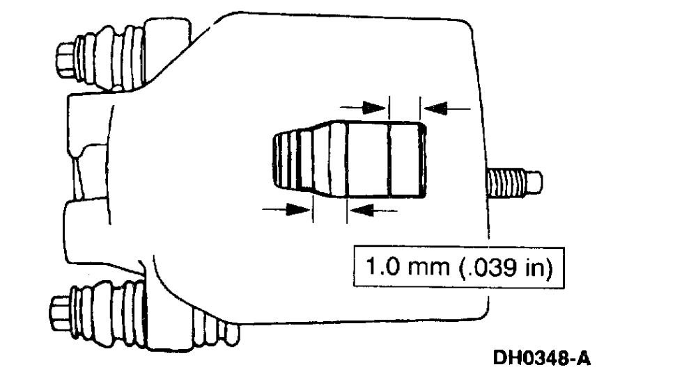

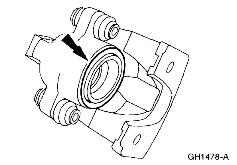

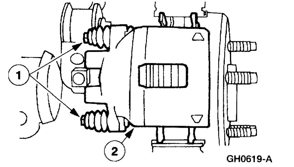

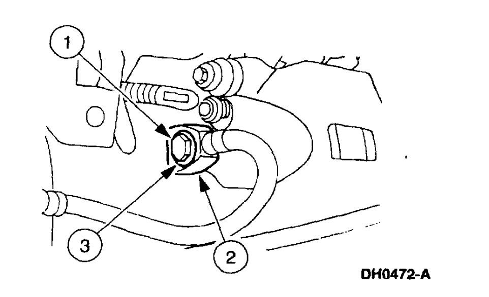

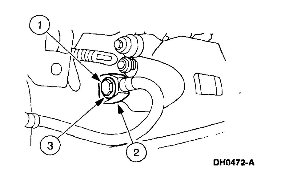

Good afternoon,
This could be a caliper freezing up or a brake hose collapsed.
https://www.2carpros.com/articles/how-to-replace-rear-brake-pads-and-rotors
Have you had them checked?
