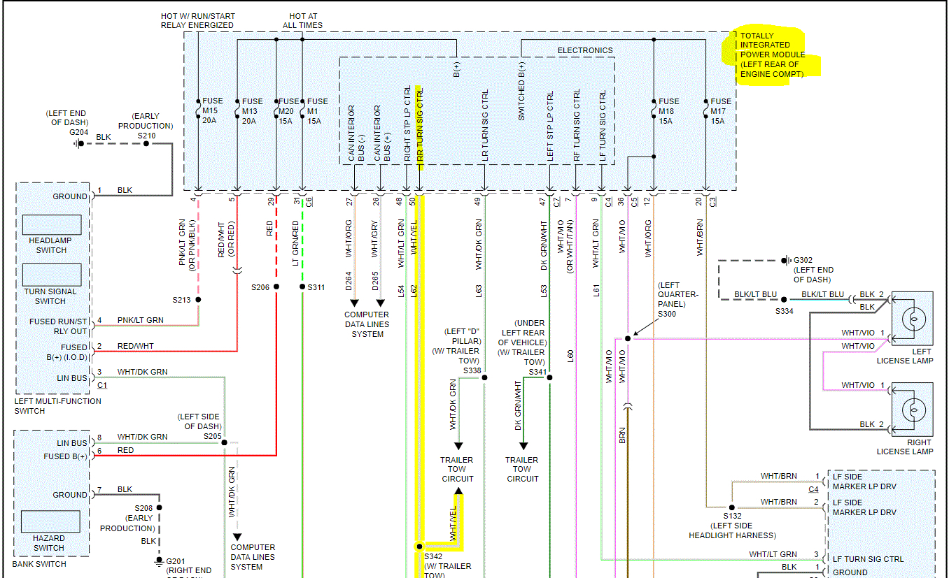

My rear passenger blinker is not working. | have changed the bulb and it still does not work. I know it has to do with the wiring, but l do not know where in the wiring system to look. Also no luck finding the right diagram. Can you help?

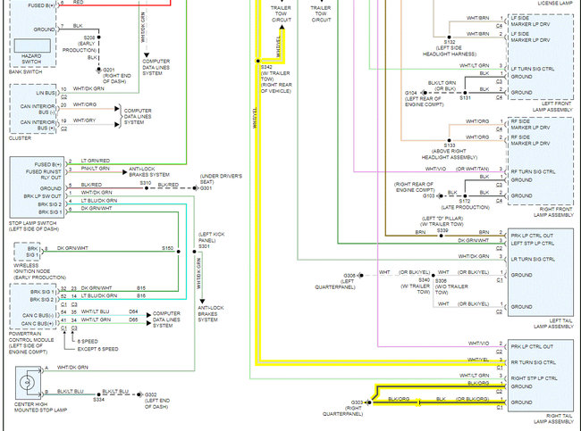

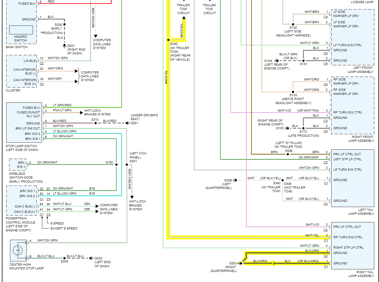

I attached two pics below. They came from one pic, but I had to cut the pic in half to make it readable. I did overlap them so you can follow from one to the next.
Now, have you checked to see if there is power to the white wire with a yellow tracer at the light itself? I ask because that wire is specific to the signal. If there is no power, we need to jump to the TIPM (totally integrated power module) to see if there is power present.
As I mentioned, I attached the wiring schematic specific to this vehicle. If there is power, then suspect it is a light socket issue. If there is no power, I have a feeling the pin in the connector at the tipm has broken or corroded. There are so many small pins at the module and they are known to fail.
