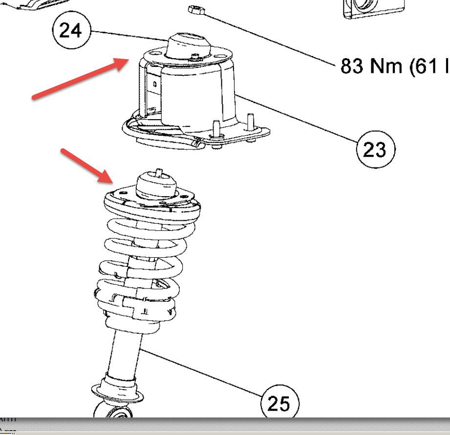

When I turn the steering wheel to the right, or when I go over a bump or pot hole, the car makes a grinding/squealing noise that seems located at the left rear end. There is no noise when turning the wheel to the left. I have read that it may be a) Struts, b) Sway bar, c) Brake calipers loose, d) a loose spare tire in the trunk. The noise is not always there. I had it a while back for about 3 or 4 days and, when I decided to take the car to the shop, the noise went away for several months. It is back now and I would like it fixed.

brake fluid wouldn't do it , I meant if it was AWD to check fluid in rear end. when you check wheel bearing try turning strut as it may be the plate on top of the strut that is going bad. see pic or maybe the strut is loose on top from wear. but normally you can only check those when strut is off.

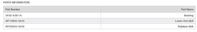

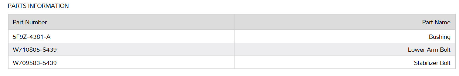

one thing I forgot to do is check tsb's and there is one for the rear suspension hearing a squeak or clunk the build date is 7/12/2004-9/21/2004 that build date sticker should be on door post drivers side. it's for a lower control arm bushing. not sure if dealer will do this any longer due to age but it doesn't hurt to call. pic shows new part numbers if you decide to do this your self or get the parts.

It was a broken control arm. The broken end was scouring the inside of the wheel
