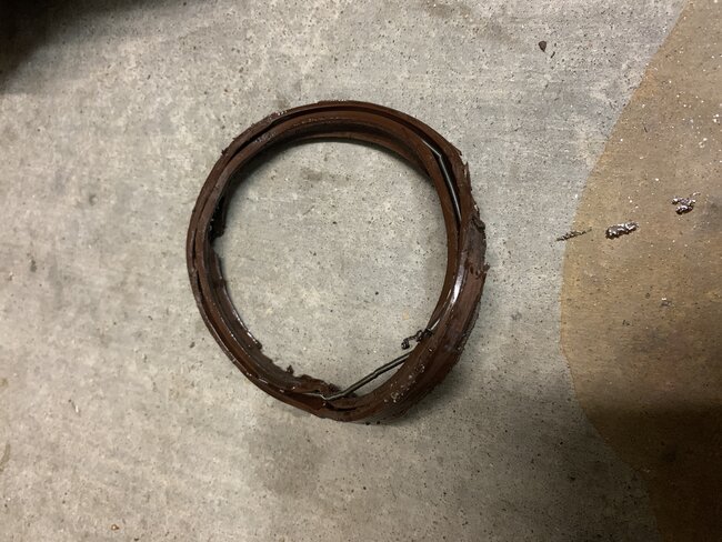

I have tried everything I can think of to get the seal out and it will not budge. I don’t want to do anything drastic so that I don’t scar the crank.

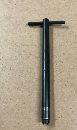

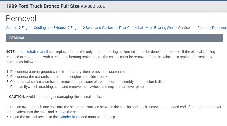

You will need to tap a hole into the metal housing and then use what is called a jet plug remover or something that will do the same.
I attached the directions below and a pic of a jet plug remover.
Let me know if this helps.

Finally!!! Thank you for the suggestion. I didn’t have a jet plug puller, but after drilling a 1/8” hole, I was able to pry it out with a pick. It held on to the very end!!
