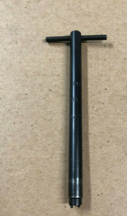

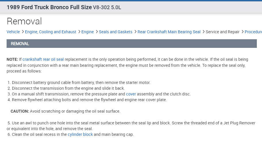

You will need to tap a hole into the metal housing and then use what is called a jet plug remover or something that will do the same.
I attached the directions below and a pic of a jet plug remover.
Let me know if this helps.

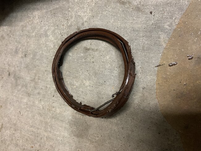

Finally!!! Thank you for the suggestion. I didn’t have a jet plug puller, but after drilling a 1/8” hole, I was able to pry it out with a pick. It held on to the very end!!
