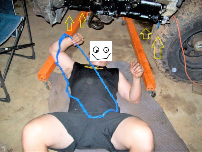

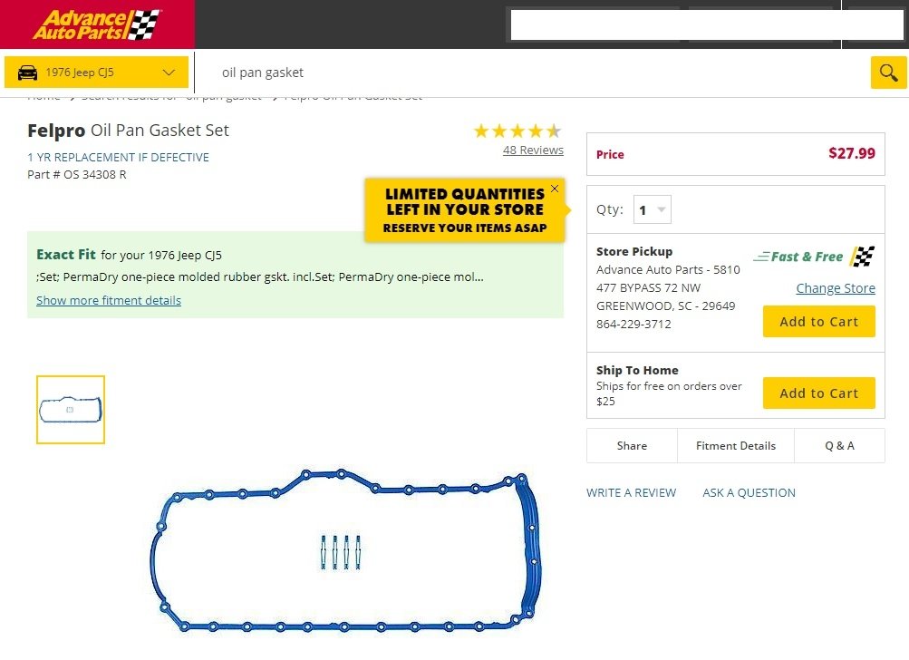

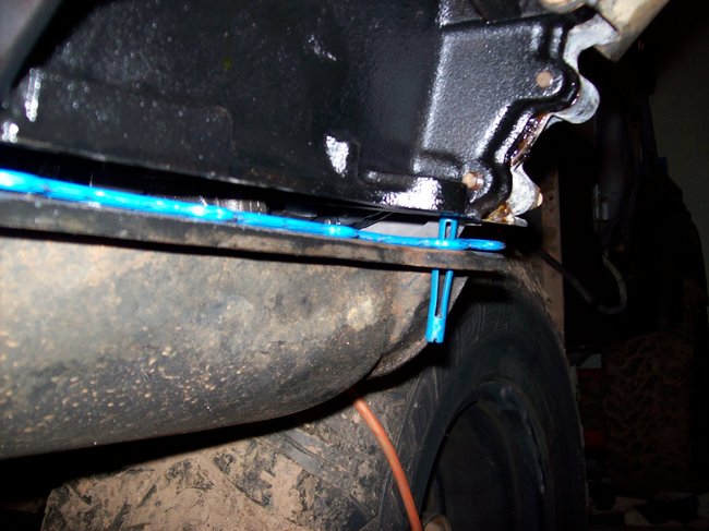

Since that post, I was able to get a couple of pics of this new type gasket!
It's so neat! It's all one piece, unlike the original 4 piece (2 rubber ends and 2 cork strips)
It goes on so much faster and neater.
Four studs temporarily replace the four larger pan bolts.
The gasket "pops" over these 4 studs, then the pan itself pops over them.
Everything is held perfectly in place while the smaller pan bolts are installed.
Then the 4 plastic studs are removed and the 4 larger bolts are re-installed.
You are done!
Two new pics below.

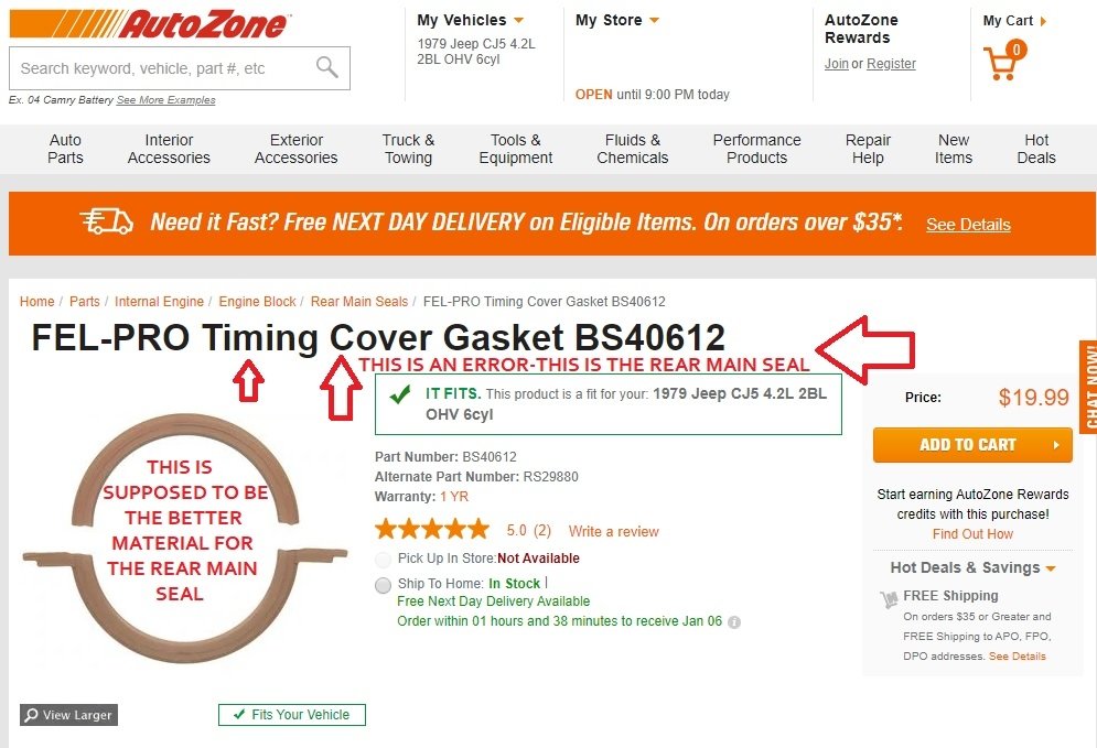

Okay, so all of that reading aside which was informative but long. I got the part number for the oil pan gasket but I did not see one for the rear main seal or the oil pump. I have found a few on my own but I want to be sure to get the best. I do not want junk installed on my jeep. And a lot of these box stores sell junk... not to mention I know the rear main is a 2 piece and advanced has a one piece listed...
Jan 4, 2020 at 6:25 AM
CJ MEDEVAC
  • 11,004 POSTS

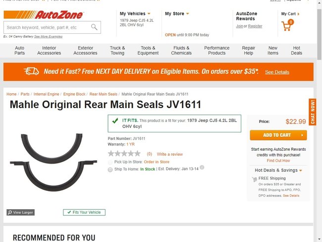

Here's 2 rear mains from AutoZone.
Typing is wrong on the 2nd one (this same one is also available at "Amazon") This one is praised more than black rubber one.
